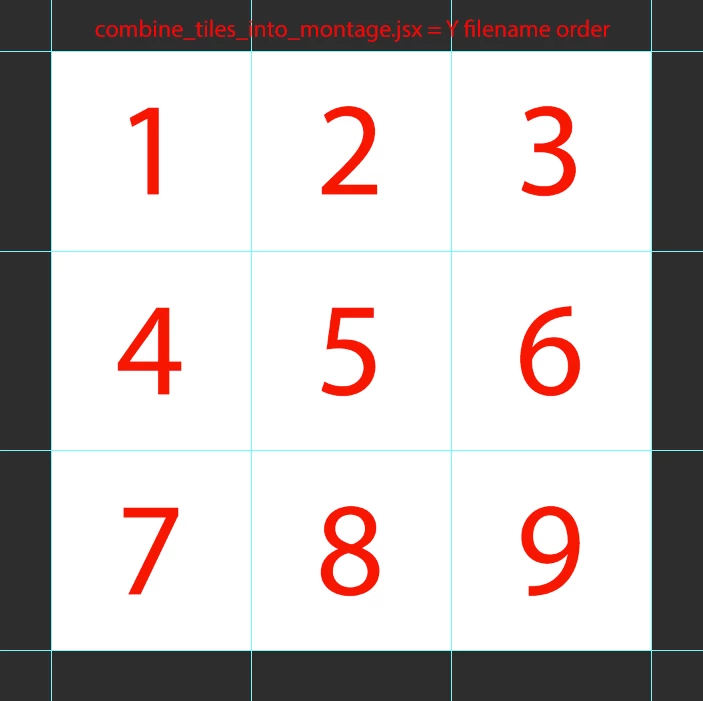

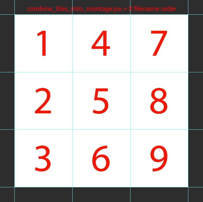

Presuming nine separate input files named 1-9, here is the result of the input order when X is selected (vertical, left to right):
And here is the layout order when Y is selected (horizontal, left to right):
