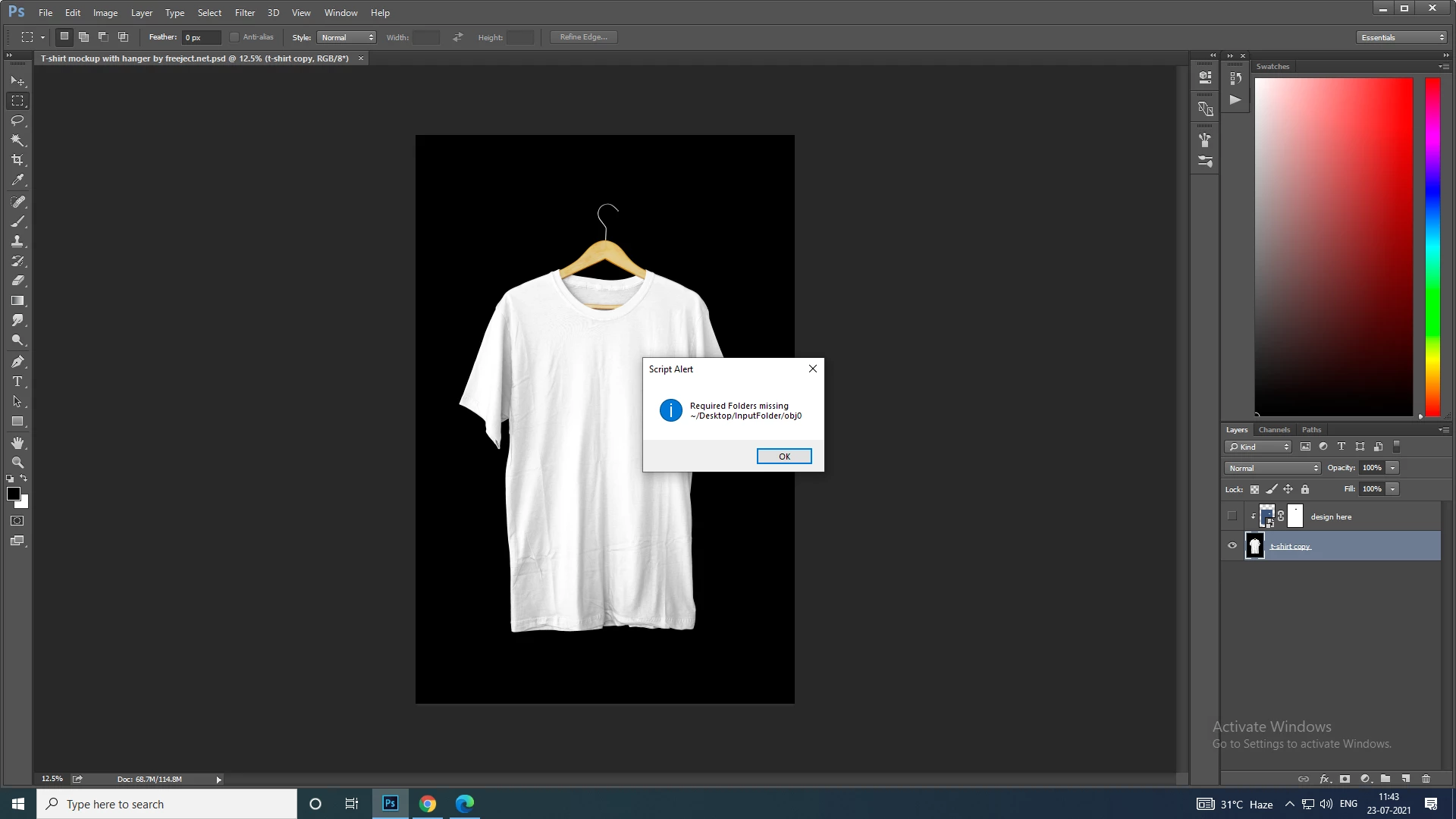

Batch Mockup Template Error Required obj0
how to solve this problem

    It look like you are using my Batch mockup templates populated scripts and have not used the help button to read how to use the script.  The message is stating your  replace object folders are not setup.   In the replacement object folder there needs  to be a  folders for each Smart object layers replacement objects.  obj0, obj1, ... objN.  You should read the help. Help

    What script you use? Also why you created this: batch mockup template script problems?
    July 23, 2021
    Bojan Živković11378569
    July 23, 2021
    It seems you are missing something like folder with specific name on Desktop. Can you give us more light like which script you are using and perhaps what are settings applied in script dialogue?
