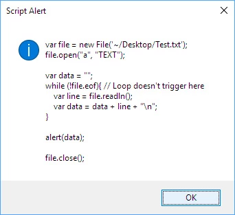

Does this script alert help?
What new eyes can do but mine are 75 years old with new lens though new is good.

July 8, 2016
JJMack
