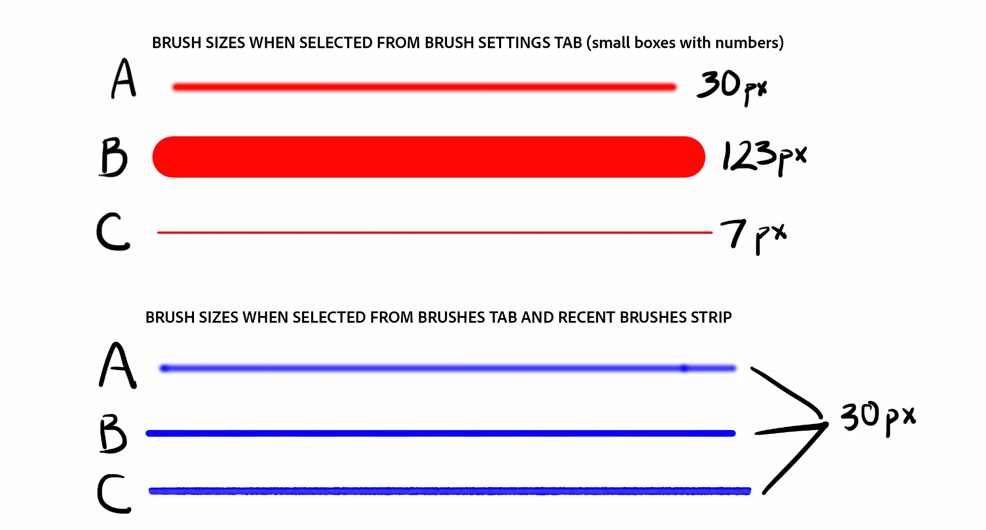

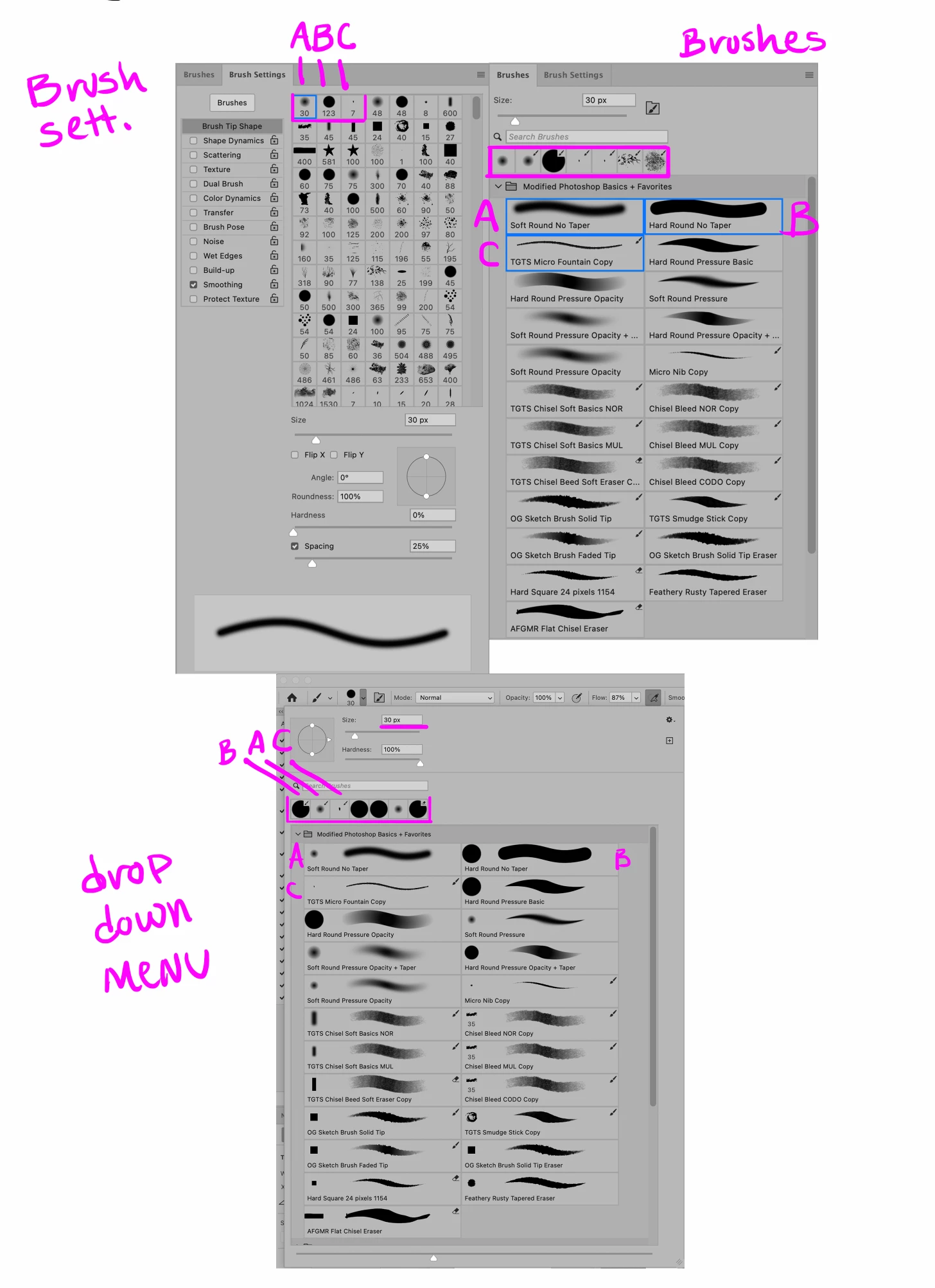

I’m attaching a diagram of the A vs B example.

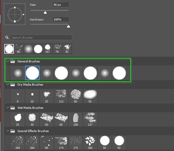

I thought about this some more.  AFAICT if the preset has a size in the Brush panel then it will work the way you want it to.
If no size is shown, as in the presets I highlighted below, then if you resize them, select another brush, and select the first brush from Recent brushes, its gone back to it's original size.  Give that a try.  It's late here and I am out of time, but that's the way it seems to work.

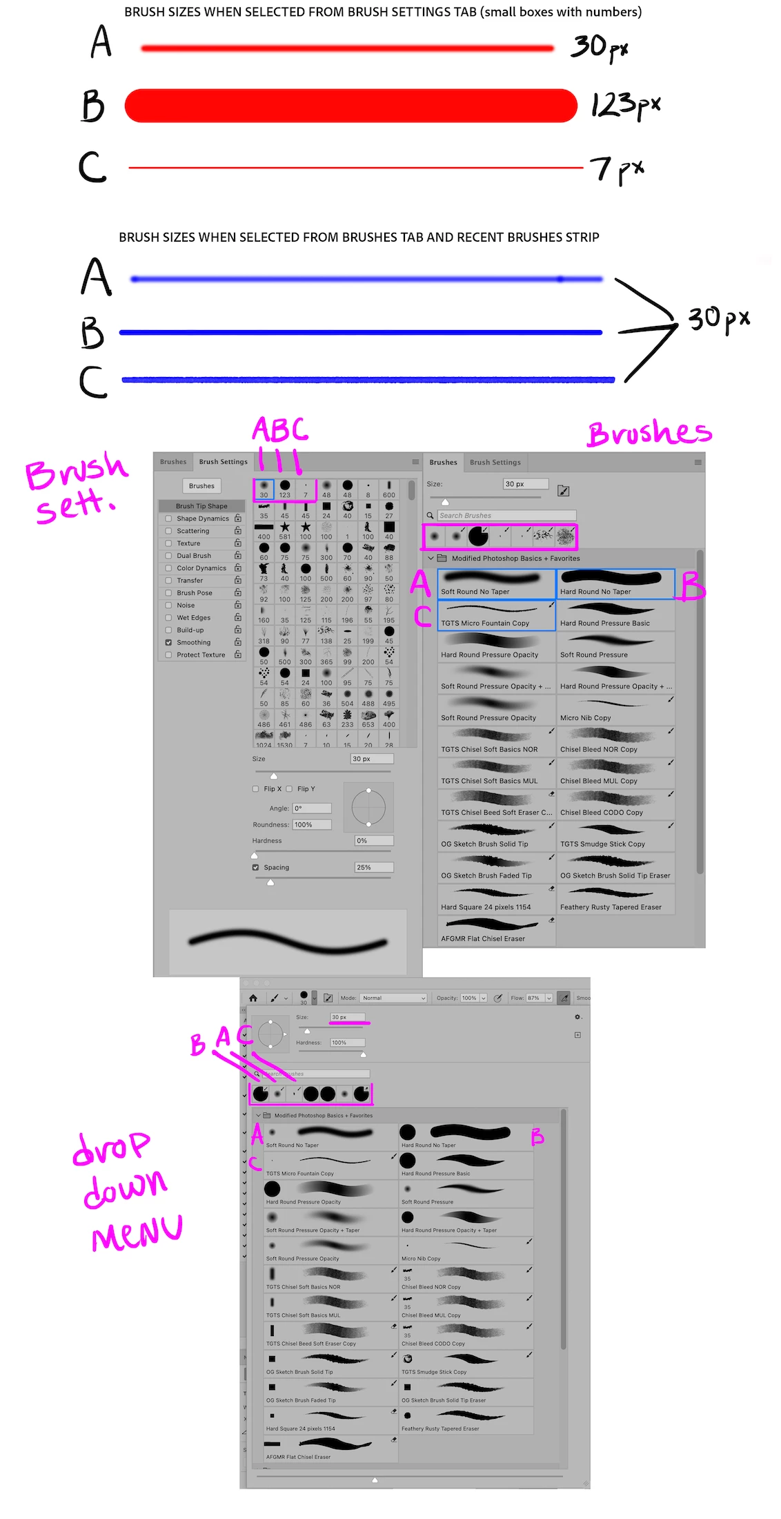

Hi Trevor, thank you for the response. I've tried to make a visual description of the issue. My drop down menu looks different than yours for some reason, but hopefully that isn't an issue.
As I've said, I tried resetting the tool already. Several times now to no effect. I reset all my preferences and then reimported my workspace.
Normally I don't use the options bar to switch between brushes or adjust them, it is far quicker for me to use the Brushes tab/panel. Within the Brushes panel and the brush tool options drop down, there are no corresponding size numbers to each brush. However, I do not want a brush to return to a default size whenever I switch to it. That would be just as counterproductive.
The red lines diagram refers to what happens to each brush when I select it from brush settings. Doing so does revert it to its default size. The blue lines diagram refers to what happens when I switch from brush to brush by using either the general list or the recents strip.

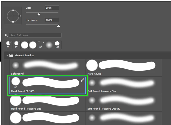

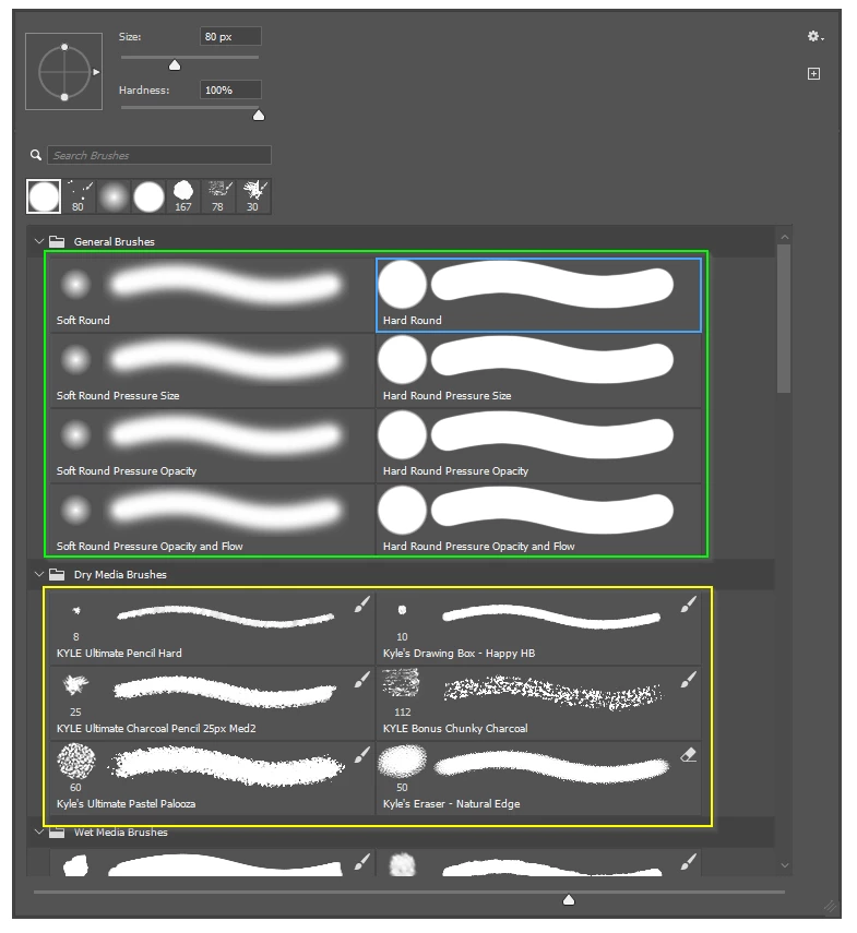

Did you try what I said about presets that have a size against them in the panel, as opposed to presets that dont?
Your screen shot looked to be showing the General group presets, and they don't sizes.  Try test with presets that do have sizes against them.

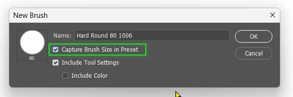

If you want to use those general presets in the way you describe, try re-saving them as new presets with Capture Size checked.
Make a new group with all of your custom presets, and export it out to a .abr file to keep it for other versions.
