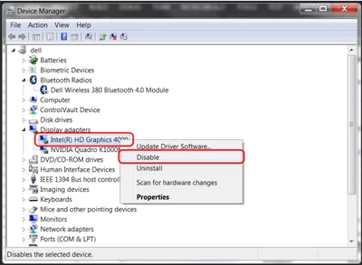

In the system info I see that there is a Intel UHD GPU aktiv. I think this is the CPU internal GPU. Please try to deactivate this GPU in device manager in Windows and check.
More informations you'll find here: https://helpx.adobe.com/photoshop/kb/troubleshoot-gpu-graphics-card.html
My System: Intel i7-8700K - 64GB RAM - NVidia Geforce RTX 3060 - Windows 11 Pro 26H2 -- LR-Classic 16 - Photoshop 28 - Nik Collection 9 - PureRAW 6 - Topaz Photo AI
