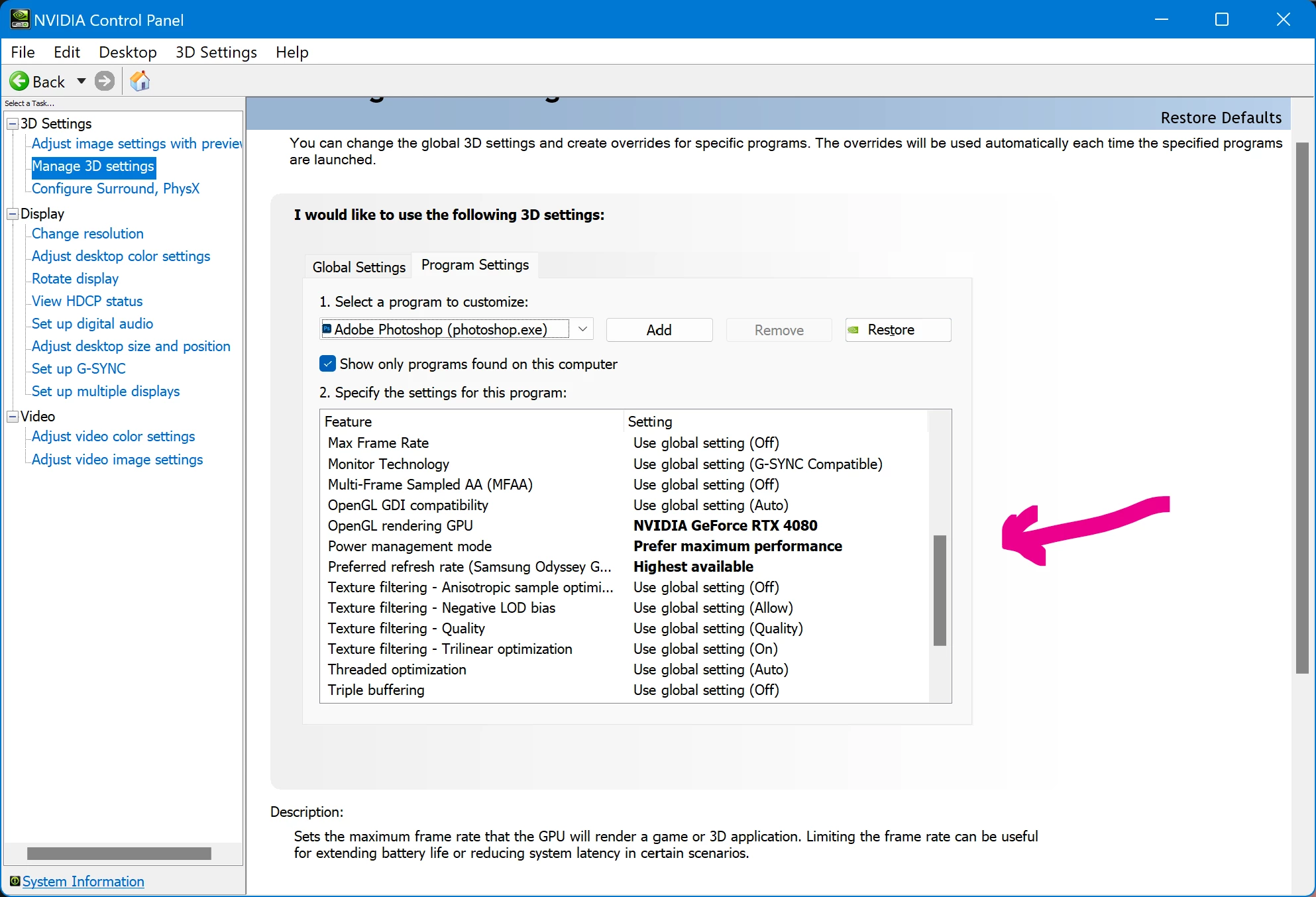

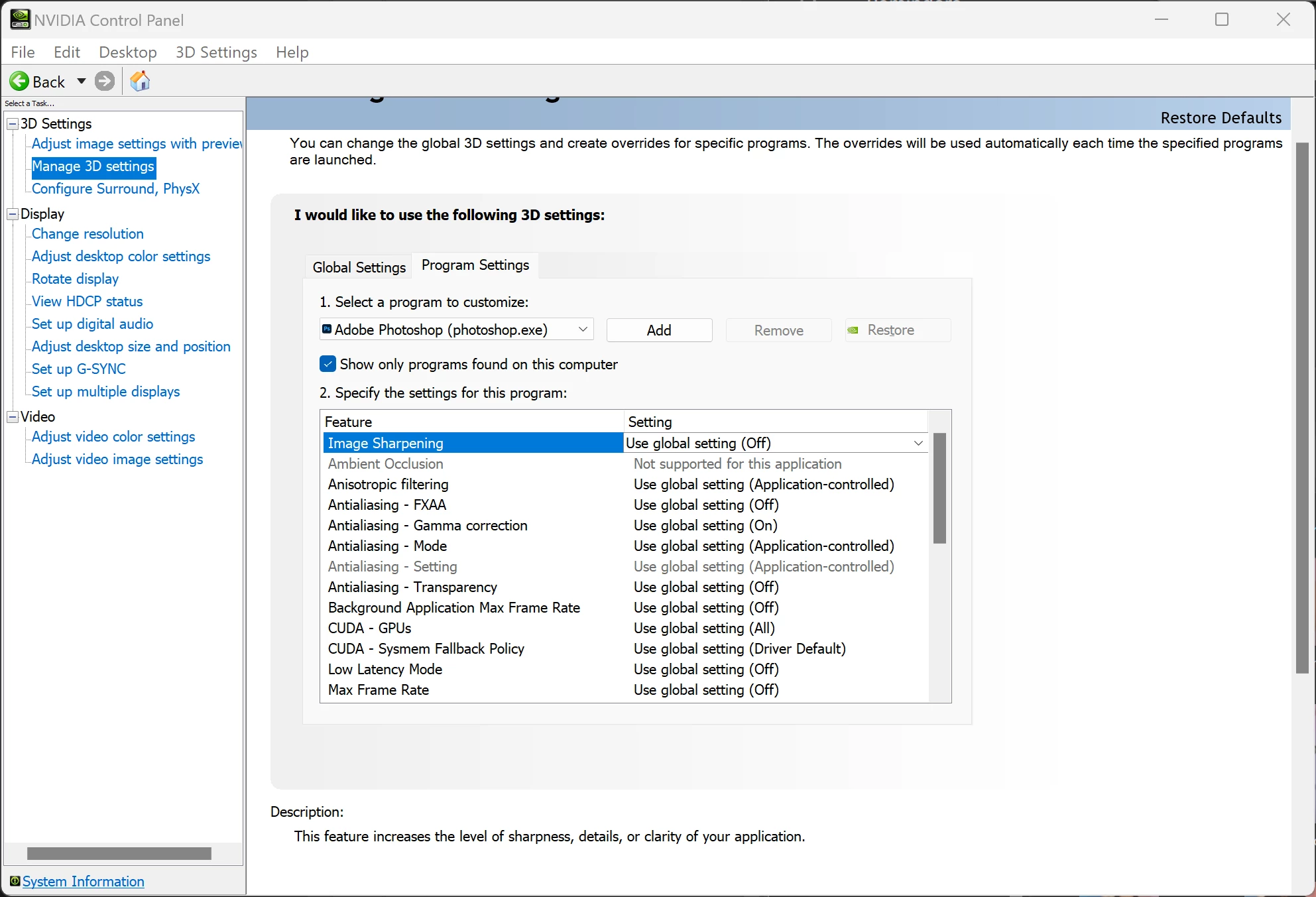

Your machine has two GPUs: the power-saving Intel UHD 770 Graphics and the high-performance Nvidia RTX 4080 (Big Boi).
Please try these two suggestions:
1 - Update the graphics drivers using Intel's auto-detect program, as you might've updated Nvidia drivers already.
2 - Follow step 6 in the content here to configure the default GPU for Photoshop: https://adobe.ly/49YQSCI
After this, in the Select & Mask workspace, press and hold the ALT key to change the Cancel Button to Reset, which will reset the Select & Mask workspace.
This should directly help how Photoshop. Let me know how it goes.

ANT517Author
August 5, 2024
@Sameer K  Thanks for the assistance. I tried following the guide but it is slightly different on my NVIDIA settings end. I think I may have done the equivalent. I'll test if it helps.
