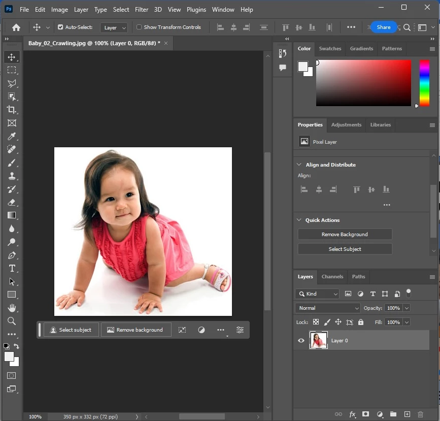

Even when I open an image with a well-defined contrast between subject and background, the remove background tool makes the entire image transparent.
I have uninstalled/reinstalled Photoshop.  Currently on Windows 11 with Photoshop version 24.6.0

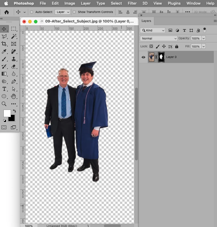

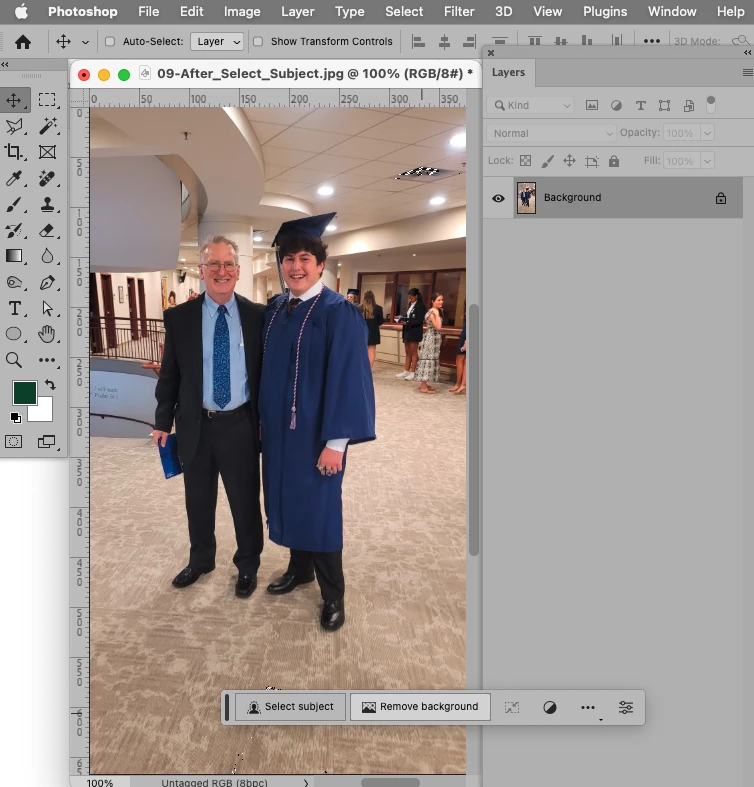

Seems to work fine here (see screenshots).

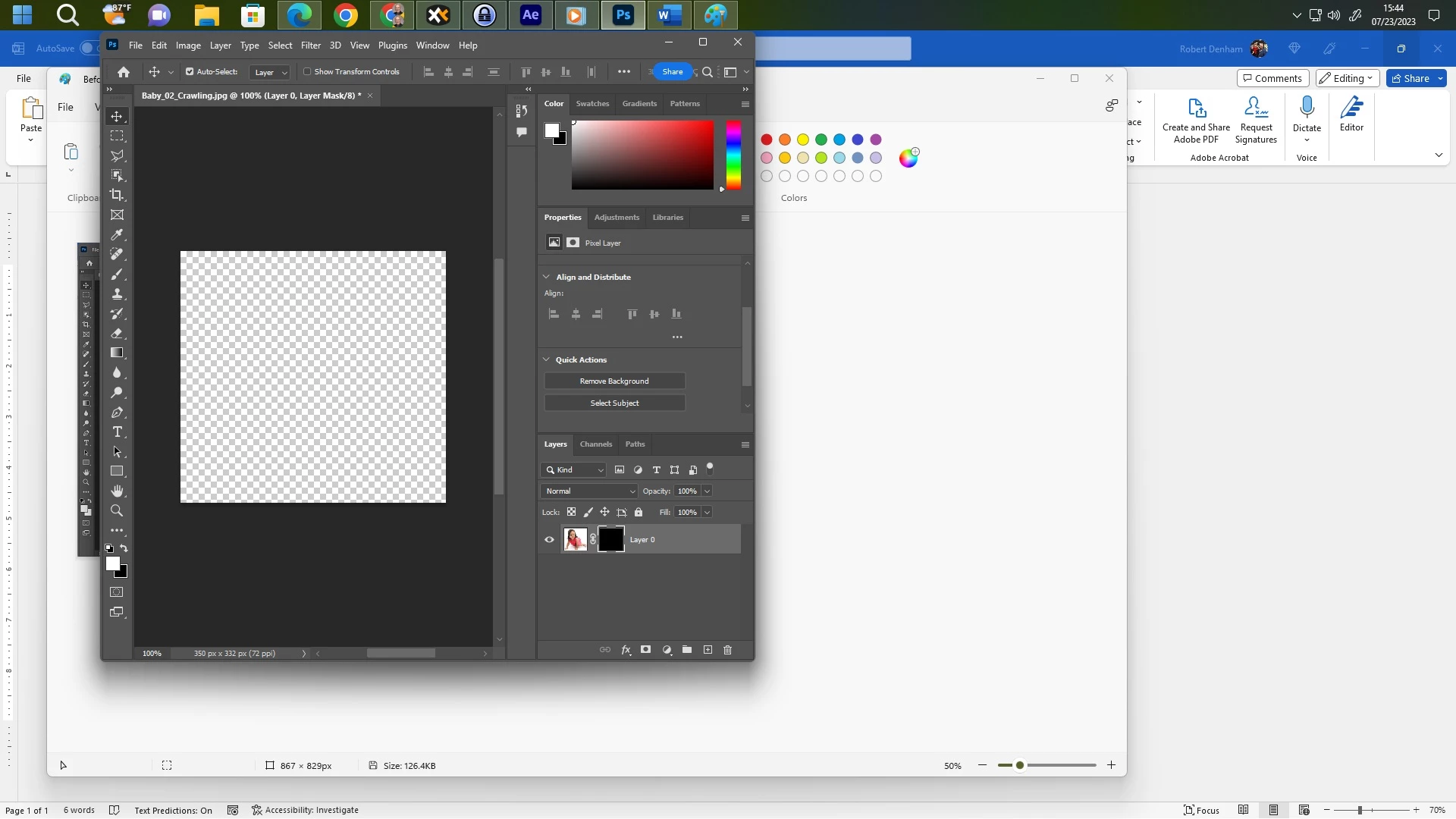

The two attached screen shots are from the "Select Subject" before and atfer where it seems to select nothing.
The Quick Selection tool seems to work as it always has: I can use it to get through a task, but it would be easier if the remove background/select subject worked.

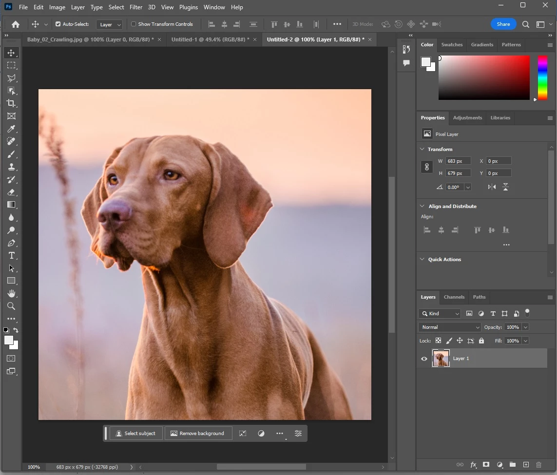

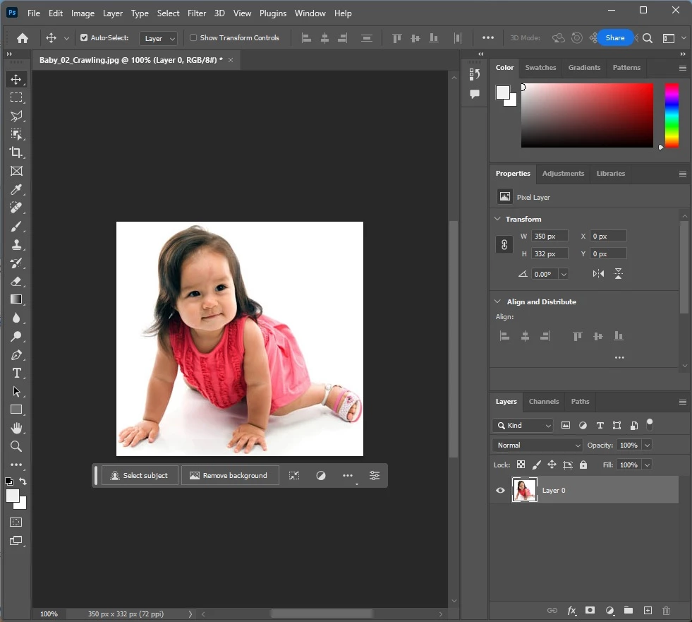

Thank you for taking a look.  I would imagine that there is some setting I am missing ...  Here are posted two examples:
Files 01 and 02 are before and after applying "Remove Background".
Files 03 and 04 are the sample of the dog that Adobe included in its tutorial.  It clearly works on that, so what's going on?
It seemed to work on everything before I updated from Windows 10 to Windows 11.  But I've also re-installed Photoshop.
Bob

Seems to work on Mac.
Have you tried Select > Subject?
