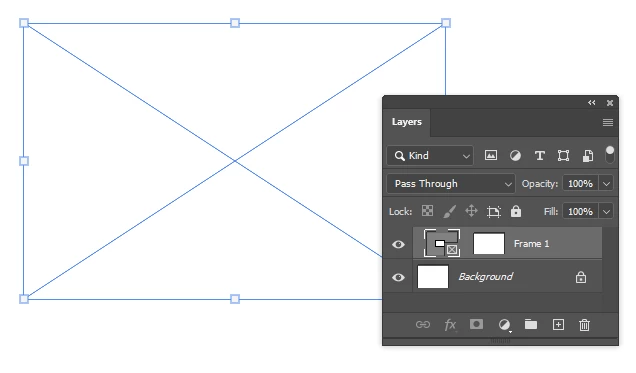

Correct answer Michael J. Hoffman
  1. Select the placed image in the Layers Panel (don't select the frame). Notice the heavy white border around the image thumbnail in the Layers Panel, indicating the image is selected..
  2. Press Delete.
Voila!

Michael J. HoffmanCommunity ExpertCorrect answer
September 1, 2022
  2. Press Delete.
Voila!
27shutterclicks
September 1, 2022
Yes, that works! I tried pressing Delete and Backspace before posting, but I think I had just the frame selected instead of just the placed image.
Thanks!

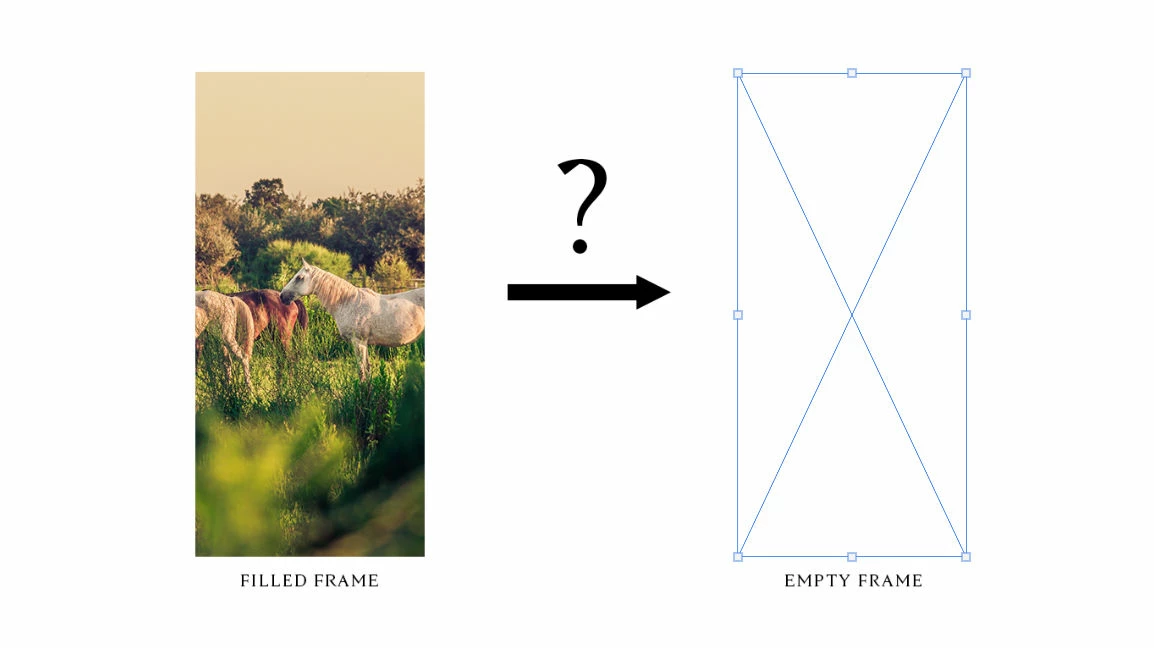

27shutterclicks
September 1, 2022
Here's a quick diagram to illustrate what I am trying to do - empty a populated frame.
