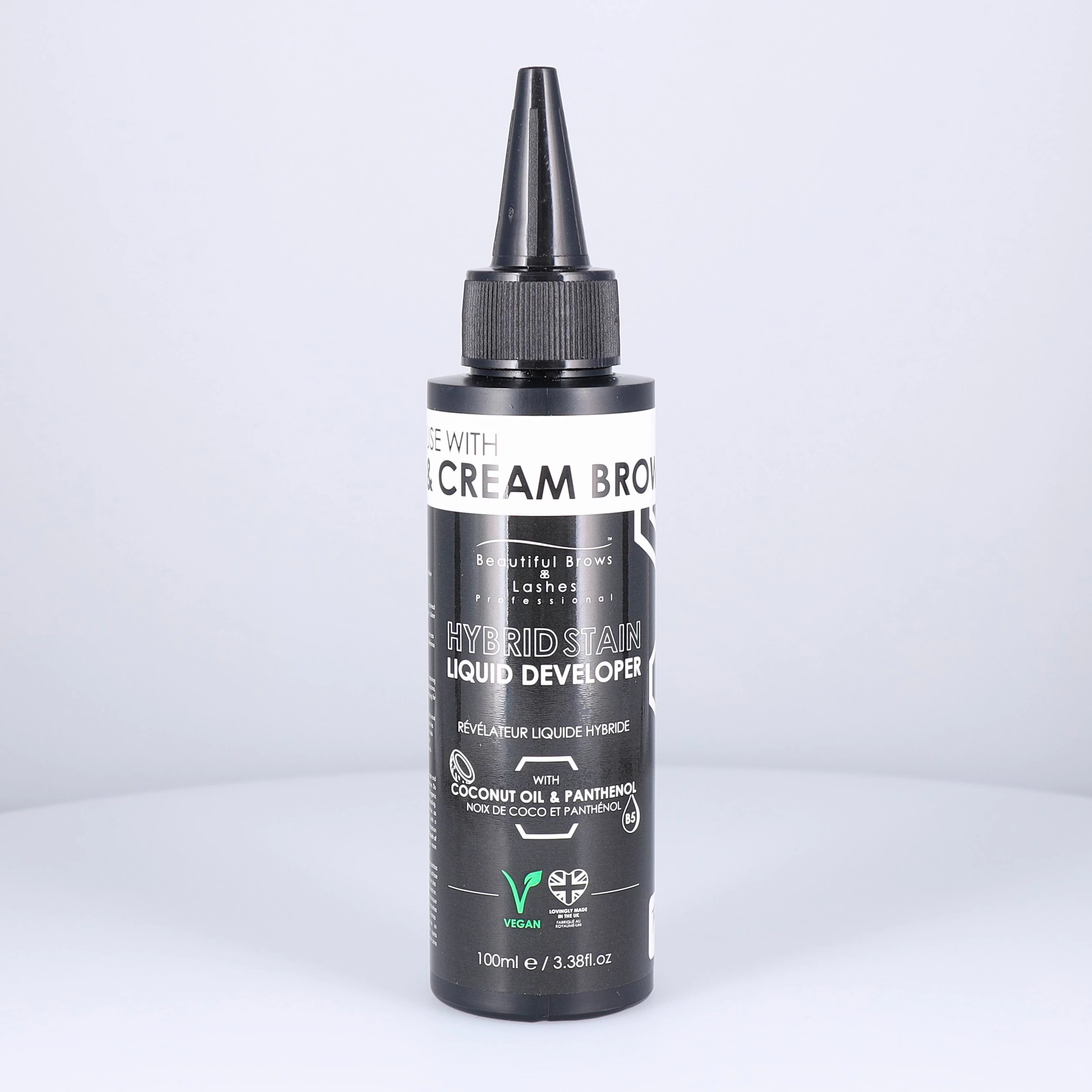

Somehting thta has really bugged me since having our Ortery desktop photography system in place is working with black bottles (which we do unfortuneltey shoot a lot of), as I always have a problem removing the harsh light reflection on the sides of the bottle.

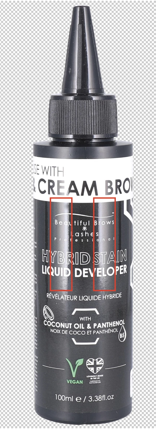

Obviosuly, I can dim the lights in the photogrpahy booth and play with the ISO & Shutter Speed to see if I can brighten it globally instead. However, using the image attached, does anybody have any better suggestions that what I currently come up with on PS to more easily remove (or blend) the reflection coming from the left and rigth side lights?
Area in question:
TIA, Liam.

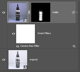

Correct answer Spas K.
Sorry for not explaining the whole process.
I first turned it into a smart object. Then duplicated that layer, selected the bottle with the object selection tool and masked it, so we are now only working on the bottle. Then I used Select > Color Range, picked the white and adjusted fuzziness, to select as little of the reflection as possible, but keeping the text & other info. Then you just fill that in with black on the layer mask to mask those white pixels off as well. You can further brush off the top and the sides of the bottle on the layer mask to add some reflections back and have it better blend with the background.
Now you can do whatever you want with the bottle and the text & background will remain unchanged, as they're excluded from the mask. You can either use appropriate adjustment layers or Camera RAW Filter, which I prefer, to adjust highlights / shadows with curves or levels, until you get rid of that reflection and still keep the detail in the dark parts.
If you're working with a RAW image, you could probably skip masking off the whites, as you have more control over colors and can isolate them in the curves/levels, but with a compressed image and heavy edits, artefacts start to appear and you're better off not touching those white pixels at all.

Spas K.
March 26, 2024
In this particular instance, as the label content is pure white, you can easily isolate & protect those pixels and then play with the curves to bring the reflection on the bottle down. Some of the brightest highlights in the reflection are left. If that was a bit dimmer or diffused, you could achieve better results. That's without much manual work.
GBP_LiamGAuthor
March 26, 2024
Thanks @Spas K.
I see what you did in the example above. I'd be more than greatful if you could show me how exactly you done this. Did you select a specific area with a selection tool first then adjust the curves? Or, adjust the curves without selecting anything?
Thanks again!!
Spas K.
Spas K.Community ExpertCorrect answer
March 26, 2024
