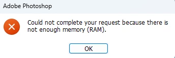

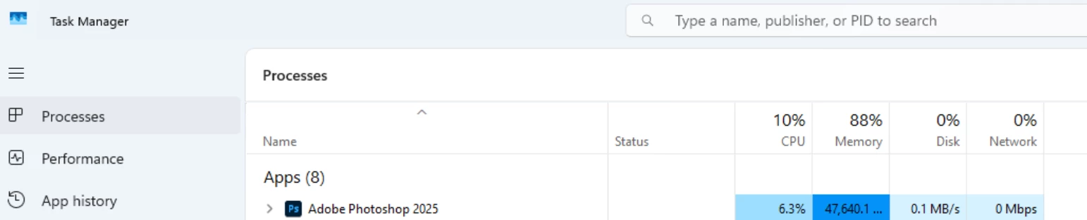

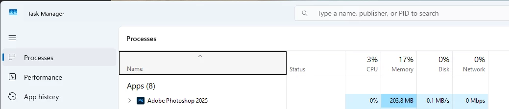

Sep 11, 2025 9:31 PM UTC
@D Fosse
data from [ task manager  / processes / memory ] normally is around 17% to 25% when doing heavy load in photoshop...
most of the time 17% to 20%, so during testing:
memory was at 17%
when photohop freeze in a few second it raise to 85 up to 99% memory !!
when the popup windows appear [ could not complete because there is not enough memore RAM ].
soon as this popup windows appear, in less then a second the memory drop back to 17%...
If I'm not mistaken that's not the first time Photoshop had this kind of beavior...

benoit Kapture foto
D Fosse
Sep 11, 2025 3:09 PM UTC
Please post the full Help > System Info from Photoshop.
This does come up from time to time. It is apparently GPU-related. The memory is used by the GPU, not Photoshop - but the complicating factor is that the GPU uses this memory performing tasks  directly called by Photoshop.
Some people have fixed it with a complete reset of preferences. The preferences contain the full application configuration, and corrupt preferences do tend to look like application bugs.
