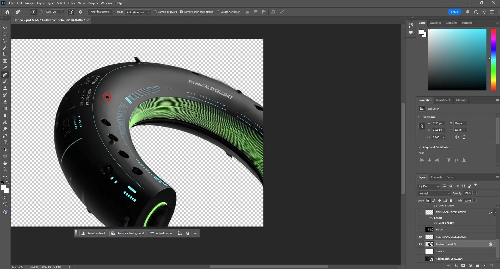

When using Photoshop 27.0, (on Mac Sequoia 15.6.1) I am having issues with the remove tool. I remove backgrounds for product photos. And, after removing the background, I will often go in and clean up the object. Removing stickers, etc. However, now if I try to use the Remove tool on an object with a transparent background - Photoshop is generating a new background. Is there any way to stop this from occurring?

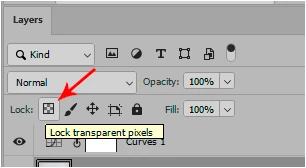

Sounds to me like you need to lock transparency in the layers panel.
EDIT: that didn't work out too well...it does prevent bleeding into the transparent area, but then it proceeds to fill the transparency with white. That can't be intentional, or can it?

Nov 1, 2025 8:18 PM UTC
Locking the layer worked! Thank you! I have to unlock the layer in order to remove the background in the first place and have never needed to relock it in previoous versions. But, this is a fairly easy fix, so I will take it!
Thanks again!

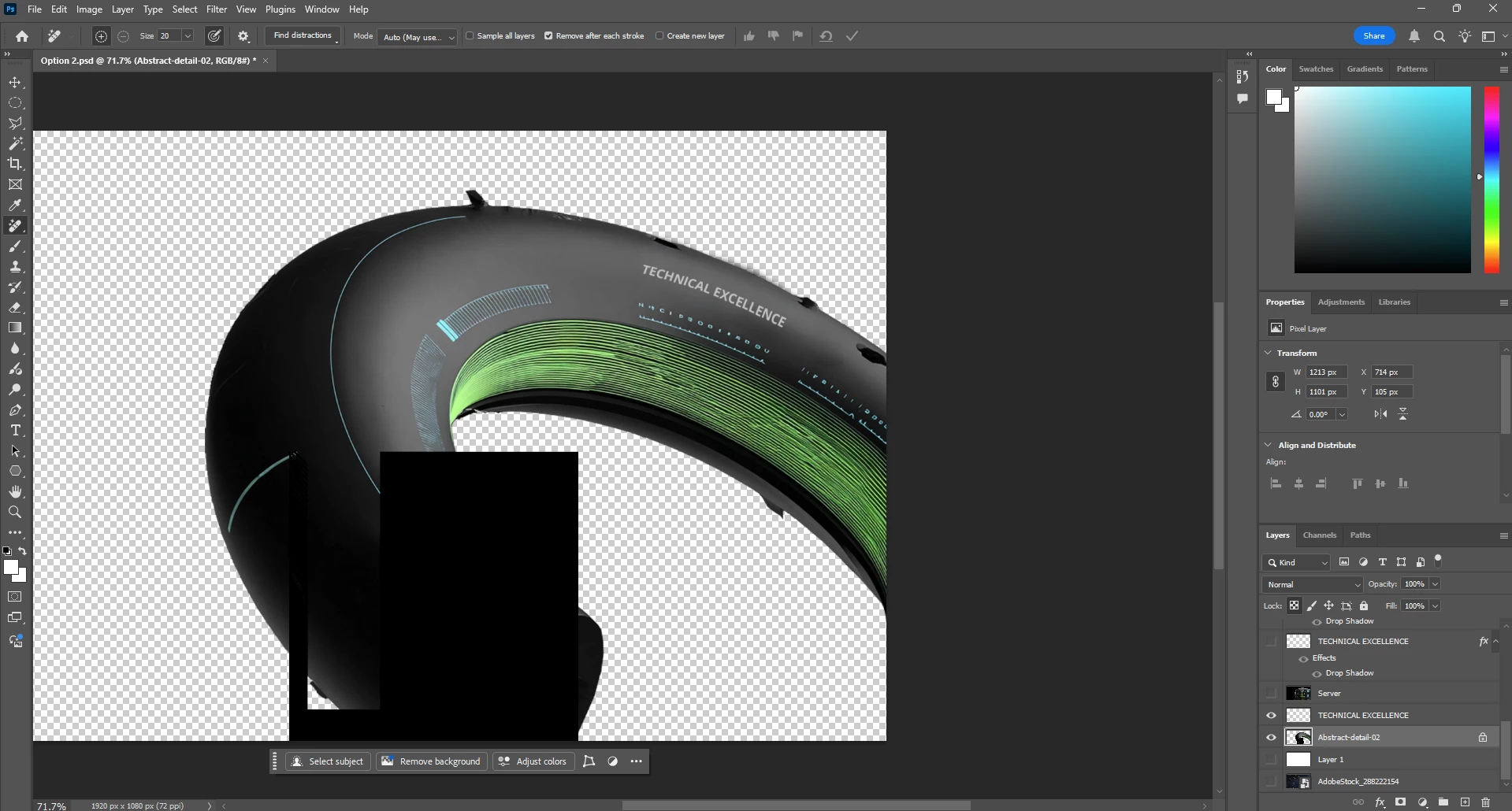

@Aleke I have the same issue, locking transparent background partly resolves the issue: sometimes it works well, sometimes it gives alert that the action is impossible, and sometimes (about every 5th time) it creates the undesired false background on part my transparent layer.
But the tool overall is very good 🙂
