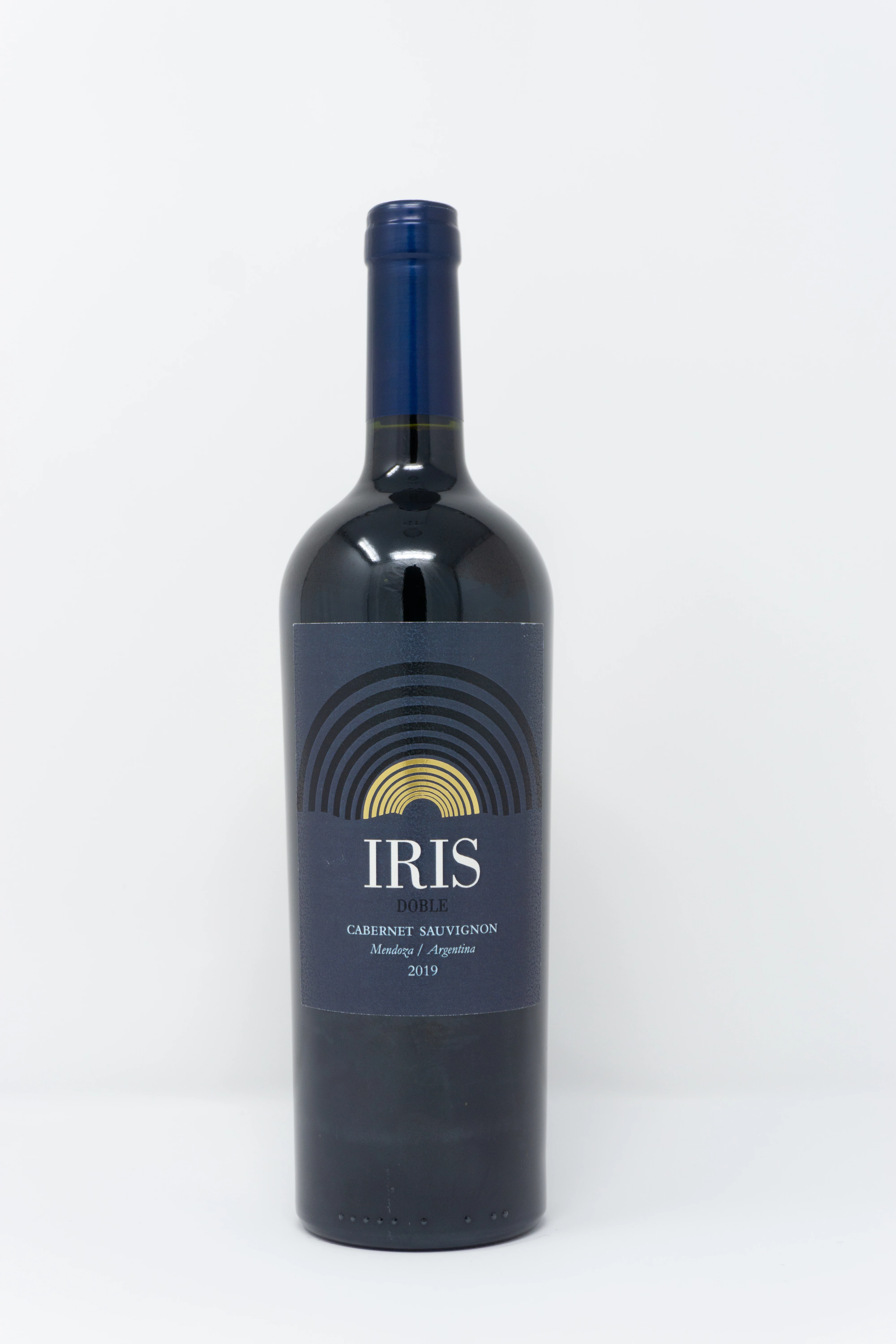

New website being completed and I have completed the somewhat boring task of photographing over 1000 bottles of wine. The website people have asked that I remove the background from the images and export them all as PNG files - is there a way to script/batch this process?

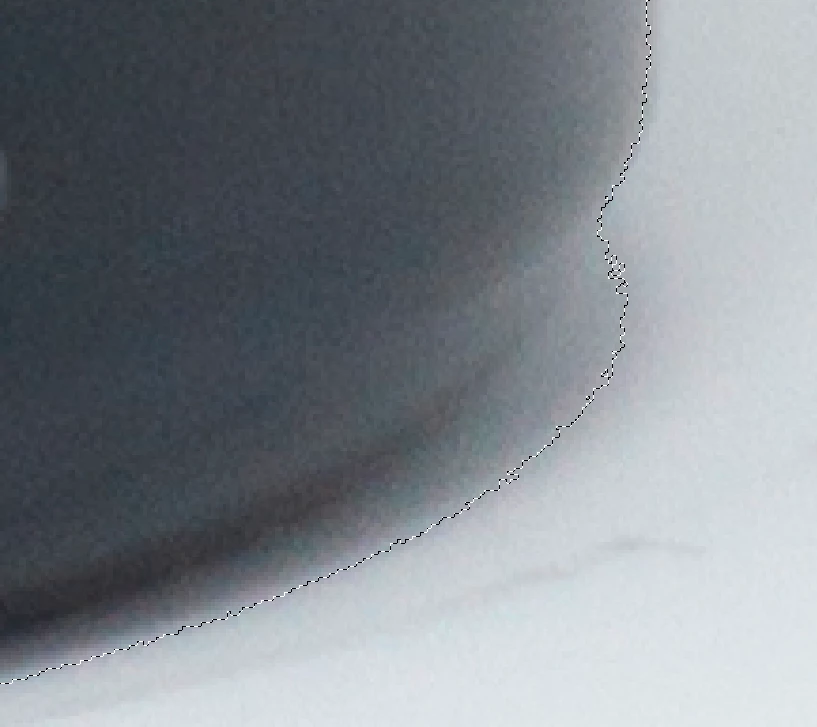

As already suggested, tough stuff to easily automate your task. I ave tested using Automated Select Subject and using Magic Wand but none of options are giving perfect result. You can try to use blendin modes or some other techniques like Apply Image to make things easier for automated options and batch process, oterwise you will need some manual adjustment for perfect result without shadow.

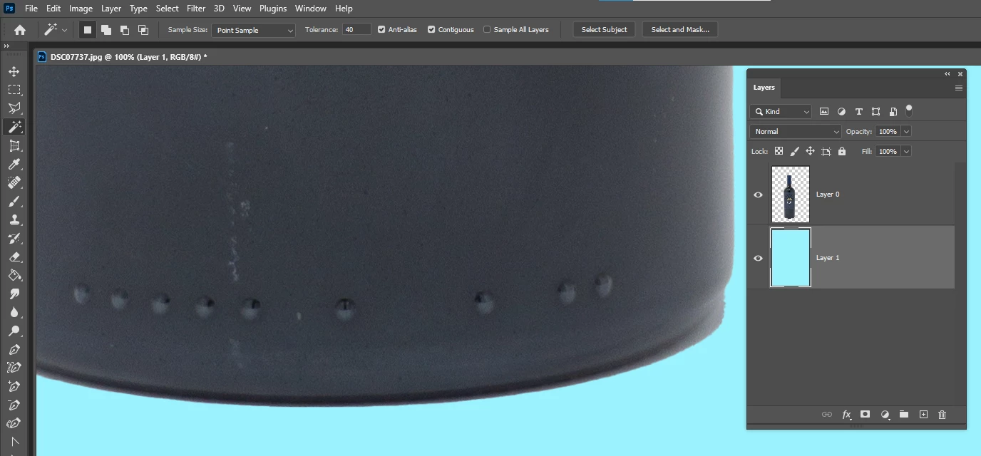

I am afraid the shadow (see screenshot) will make automation (Select > Subject, Magic Wand as per @JJMack ’s advice, …) difficult and all or most of the Masks may need manual amendment.

Select subject Invert selection clear  did this with your sample jpeg. I added a cyan layer to help you see the bottle edge and shadow

Please post sample images.
Depending on the background it might be possible to automate (or semi-automate) the task.

Thanks for that reply. I have added some photos below. All the images have been taken at the same exposure etc.
