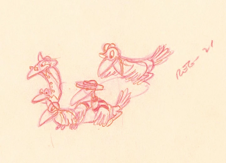

Hello all. I have a couple of scanned images of animation sketches (something like this:
As you can see, the artist first did the rough drawing in red pencil and then the final drawing on top of it in black/normal pencil. I was wondering if there is some way in Photoshop through which I can remove/fade away the black pencil lines and leave only the red pencil lines? Any help/advice/suggestion would be most appreciated. Thank you!

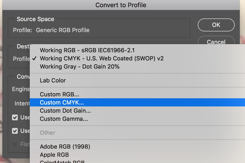

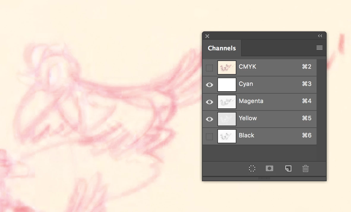

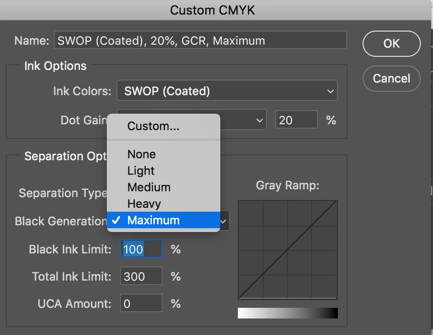

    Hi there
    If you want to remove the black lines the result is not that good because you will lose detail, but if you want to do that this is the way
    Go to the menu edit and select convert to profile
    From the drop down menu select Custom CMYK
    Inside this box change the black generation to Maximun
    Go to the channels panel and change the visibility of the black channel
    You can delete that channel and go back to RGB
    That is the way
    Regards
    Eugenio

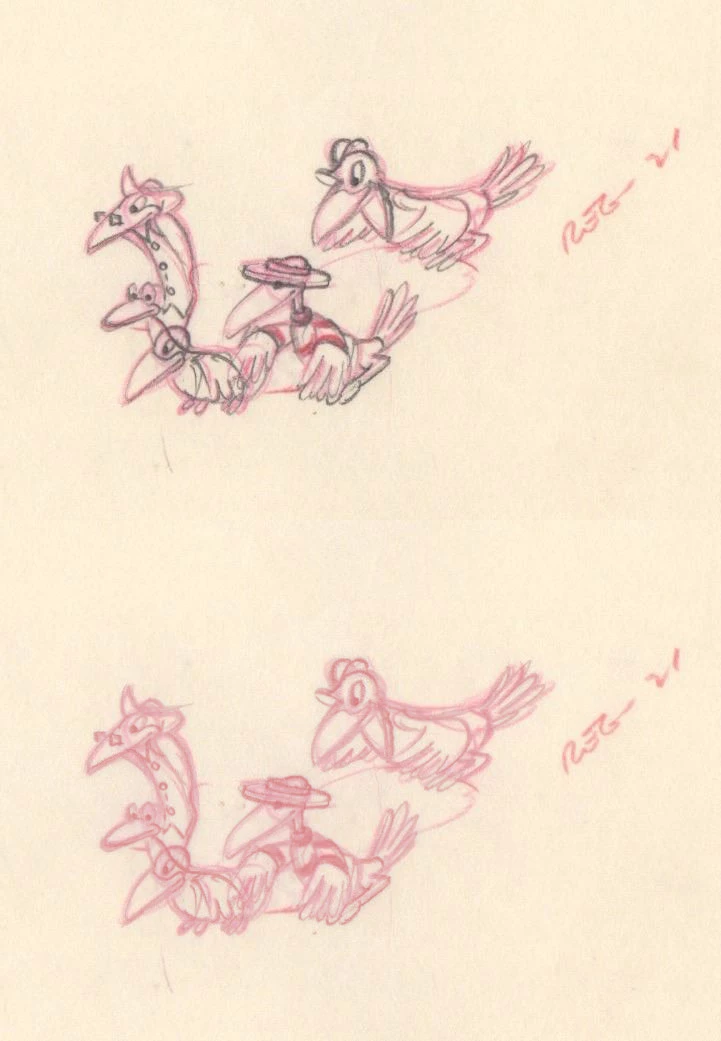

    D Fosse
    August 5, 2018
    Not in the sense that you can "peel off" the black pencil, to "reveal" what's under. What you can do is make the black lines red, so they don't stand out.
    There are many ways to do this, at varying levels of complexity. I think the simplest is to adjust the output levels of each channel. This was done with only one single Levels adjustment layer, nothing else. Start with the red channel and push the black slider to the right:

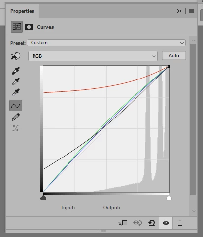

    D Fosse
    August 5, 2018
    Actually a Curves adjustment might be a little more illustrative. It's the same thing, adjusting the output levels:
    The green and blue lift is just to knock back overall saturation a bit, which otherwise tends to boost.
