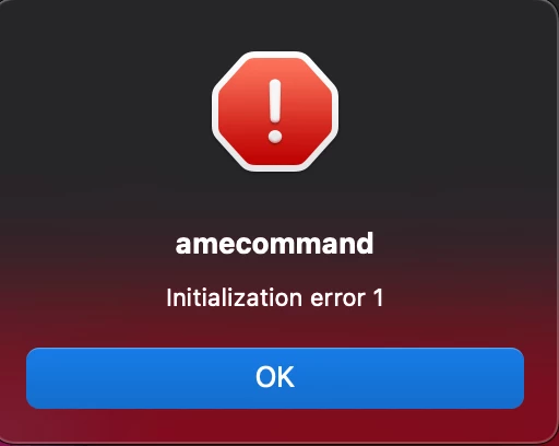

Rendering video in Photoshop always giving "initialization error 1"
I keep getting this error message (amecommand Initilization error 1), when I try to render a video in Photoshop & Photoshop Beta, both the newest versions.
I uninstalled and reinstalled Photoshop, Bridge & Media Encoder, but still doing the same thing. I restarted laptop (macbook pro), restarted the apps, uninistalled the apps then did a laptop restart before reinstalling, and still.. no luck.
I tried to open Bridge to render through there, but Bridge keeps force quittiing before it even fully loads the app, so that's of no use. Older versions of Photoshop and Bridge did not work either and produced the same out come (photoshop still gives error message when renderinig video and Bridge force quits when app is is loading up)
SOS

That sounds like there is a security error when trying to send the file from one application to another. I can only find two references with regards to Adobe applications: 1. Acrobat Reader and the security certificates it uses, and 2. Premiere Pro and a third-party plugin. I can't find any referenece to anyone else encountering it with Photoshop or Media Encoder. Most of the time this error seems to occur when developing apps and the security components installed on the system for doing coding.
So that brings up the questions: are you doing coding on this machine? and do you have any third-party content installed (plugins or otherwise) within Photoshop and/or Media Encoder?

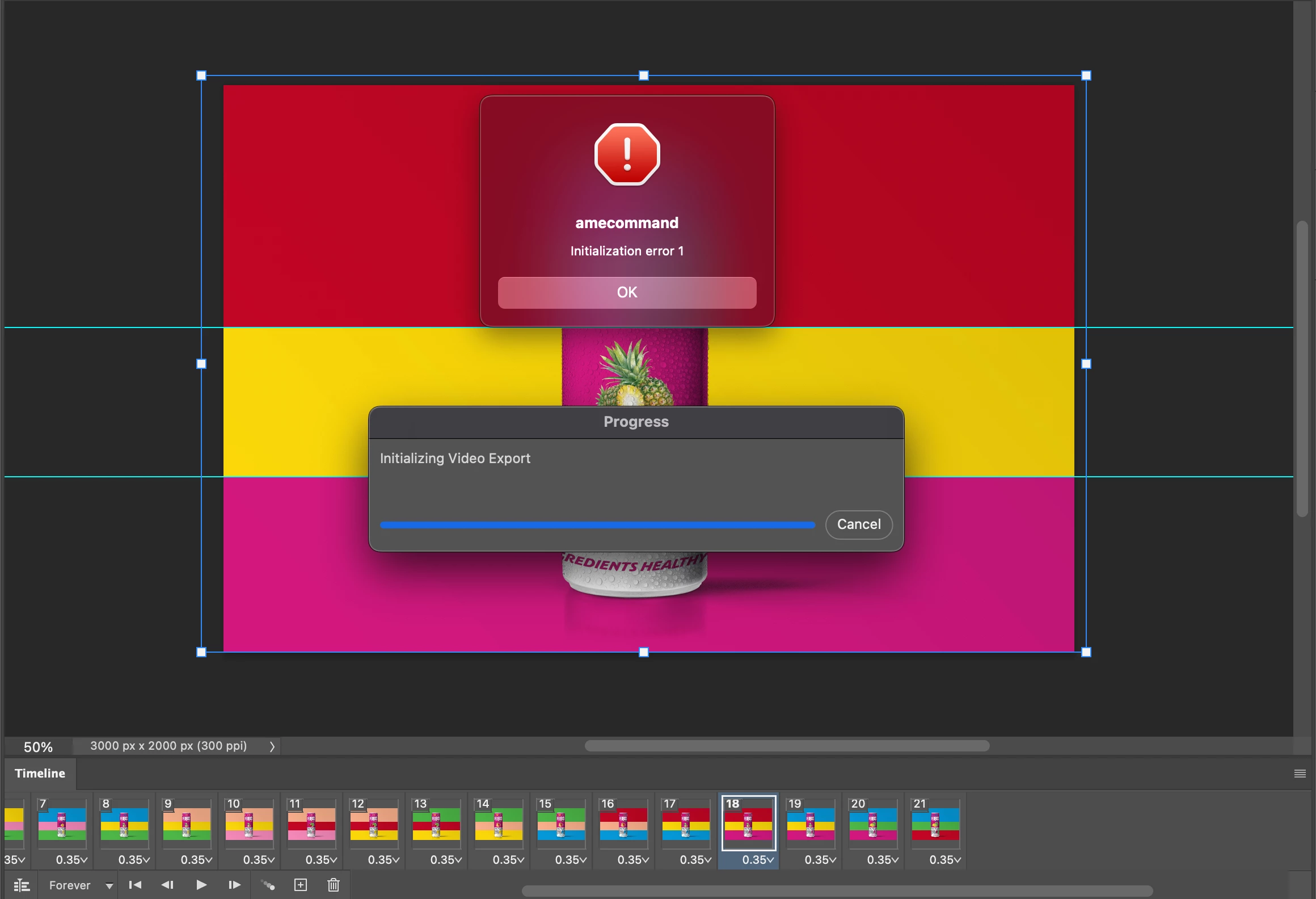

Exporting the PSD thru the media encoder rendered the animation fine. However, when trying to do it thru Photoshop again, the amecommand failed. The crash reporter revealed this:
Application Specific Information:
abort() called
Invalid dylib load. Clients should not load the unversioned libcrypto dylib as it does not have a stable ABI.
Thoughts?

but to answer your question directly, Media Encoder launches fully and works when I import video files into it to render. I haven't tried doing a render from something like AfterEffects because the video im making is a stop motion and it's jst quicker in Photoshop.
Bt also, I cant tell if it's a Photoshop issue, Bridge issue or both, because the fact that I can't get Bridge to fully launch is strange

i trried but i cant even get to the render settings to open it in encoder. I did trry dropping the PSD file into Media Encoder to see if maybe it could do it but it didn't work, it only rendered the first frame of the video sequence (I have the PSD set up to be frame by frame timeline
