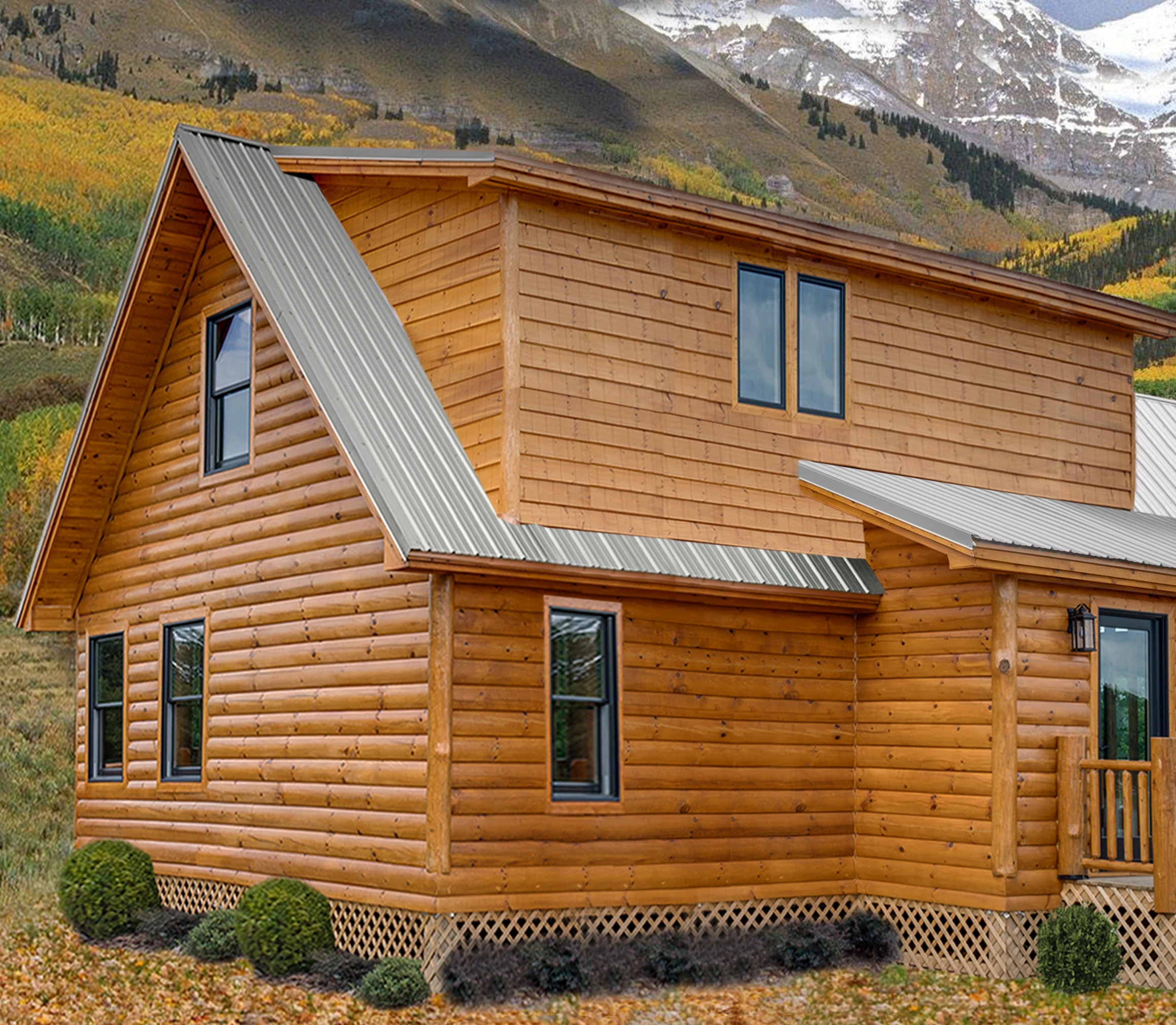

Trying to replace the log siding on an exterior shot of a home with a different siding. Client asked if there was a semi-automated way to do this, so I tried content aware fill several times and it did not work at all. Wondering if anyone has ideas on a good approach. Maybe I’m using content aware fill wrong or maybe there’s an entirely different approach that would work. We have several shots of this wall, though none match the house exterior exactly. Thanks in advance for any tips.

If you are using the second image as the new wall texture, did you try using it as the reference image with Gen Fill?
Hmmm. I tried that and it failed spectacularly.

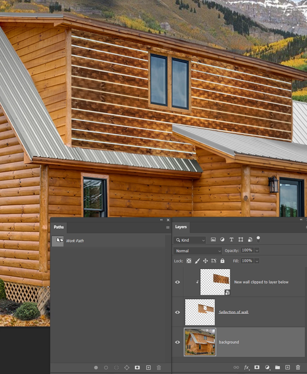

So I think you are going to have to select each face, minus and doors and windows, and clip the new wall texture to it.
How much do you know?  Are you OK with squaring thinggs up and getting perspective right?

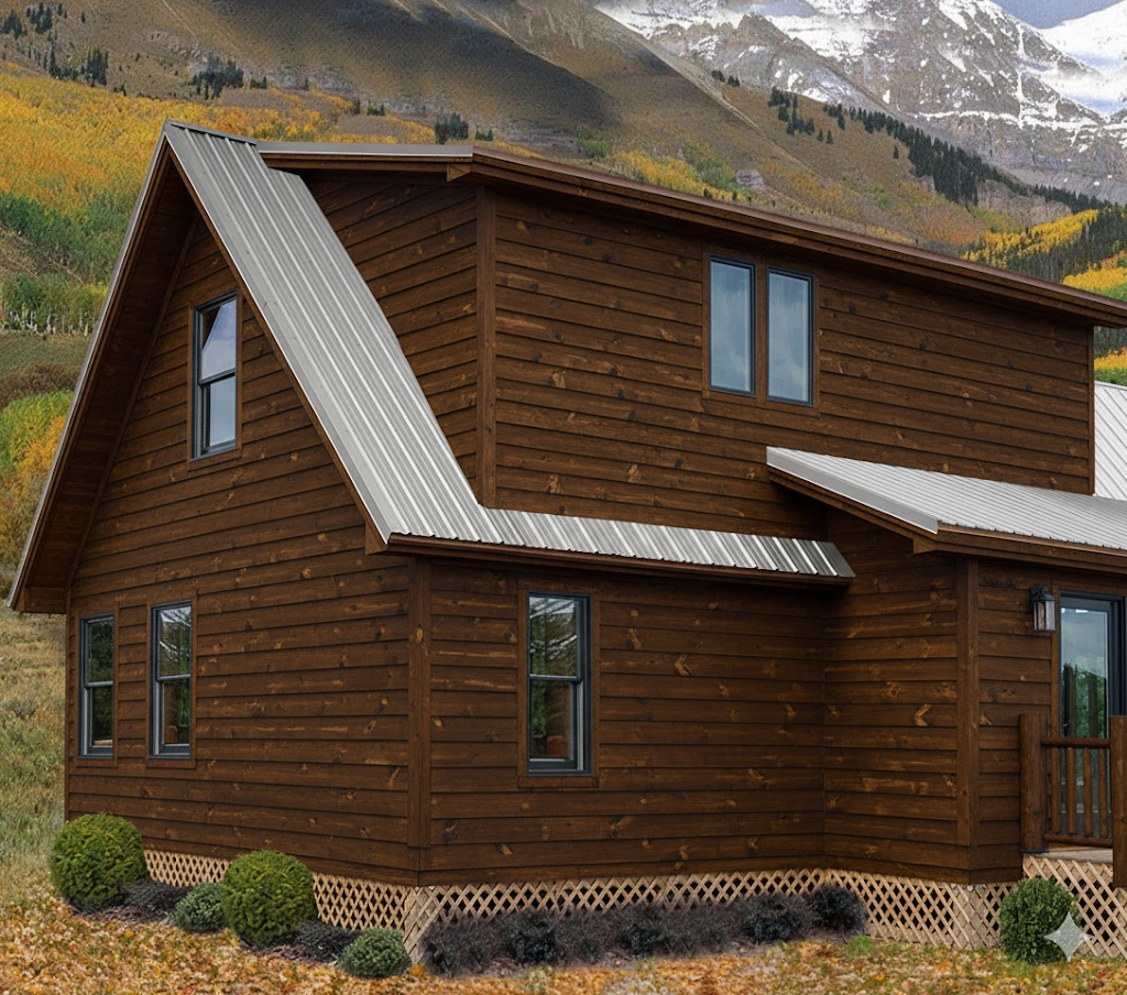

The advantage of using Gemini 2.5 Flas to do this is that you don't need to make a selection. I simply told it, 'Replace wood timber of this cabin wityh a darker textured wood'.    I only got the one go because it is no longer free after 1st September, and while Firefly and Generative Fill now have the Gemini model as an option, you still need to make a selection.  It is so much easier with a simple text prompt, so I am hoping that option is coming to the Adobe implimentation of Gemini and Nano Banana.
