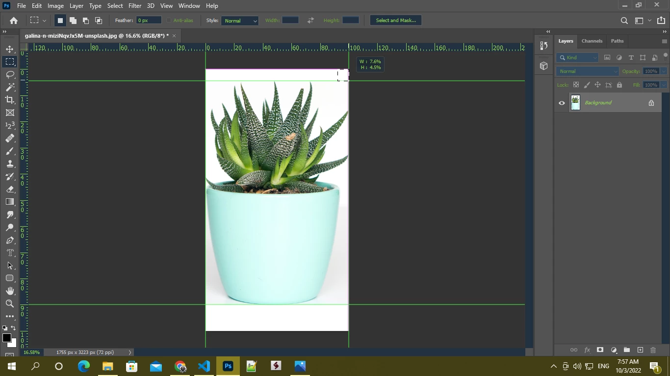

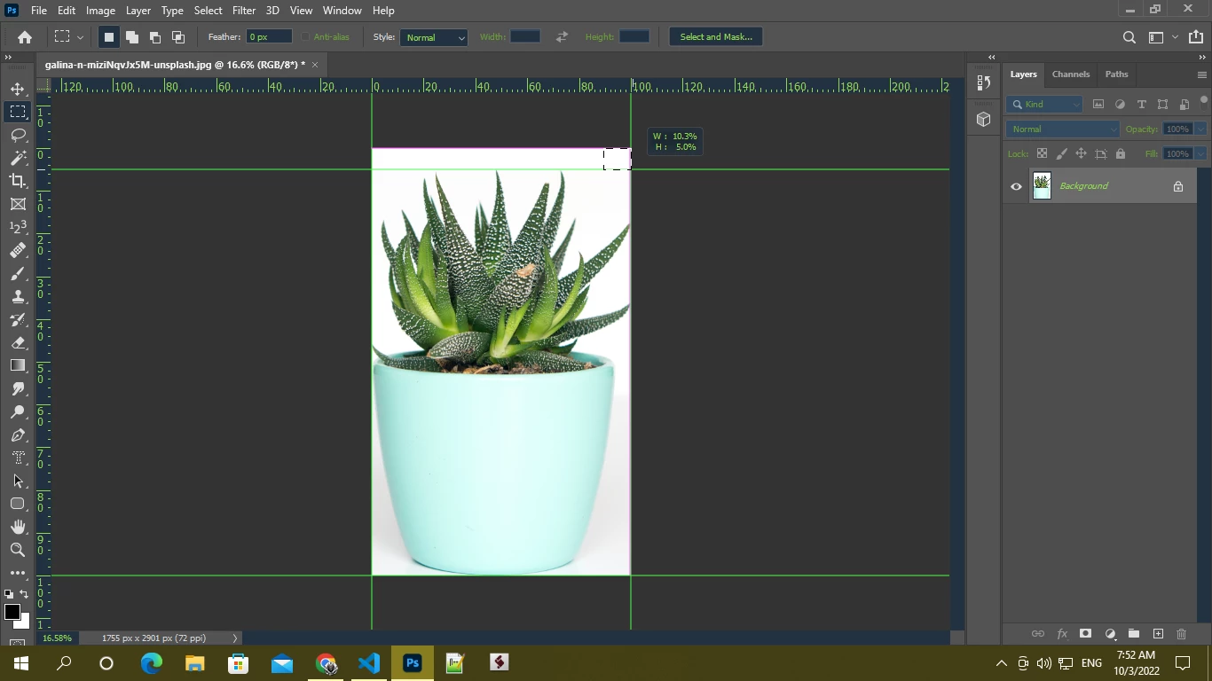

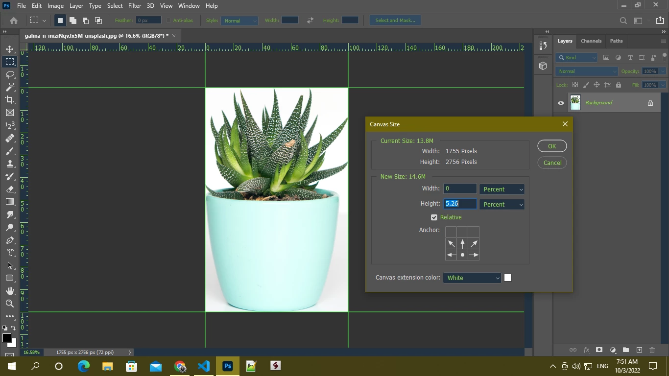

I want to increase the canvas size to the top 5% and bottom 10%. I increase the canvas size orderly first top side then bottom side. But after increasing the bottom side the top side padding changed 5 to 4.5 . Is there any way to fix it or suggest a new way to increase canvas?

Here's another way, which could be in an action:
* Increase the canvas size height by 105 percent anchored to the bottom to add the 5% to the top.
* Increase the canvas size height by 109.52 percent anchored to the top to add the 10% of the original height to the bottom.
109.52 is the rounded percentage but is very close and will generally give the results you're after. There will always be roundng depending on the image's orginal pixel height.

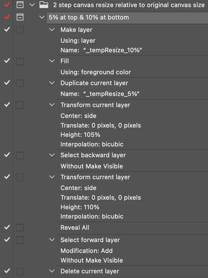

Stephen Marsh
October 3, 2022
@Mahadi_hasan
My first thought was the same as @Chuck Uebele – but I wanted to push myself to do it with an action!
You can download the ATN file here:
https://shared-assets.adobe.com/link/d575ddf9-0d49-45e7-4c35-498a380e4eb9
