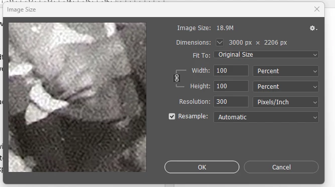

ali_4619Author
Feb 25, 2025 7:52 AM UTC
Hi thanks for your help. I am very new to Photoshop and will be doing training but I’m on a deadline for a book so very grateful for your help. The printer told me I would need the photos to be 1MB and 300dpi to print well. Also, Adobe Express wouldn’t let me upload a photo into my design bigger than 5MB.
In Photoshop what I am doing is going to the Image menu, then Image Size then I adjust the dimensions and resolution before exporting to my computer as JPGs.
With all the various sizes and quality of my original photos, I wondered if there was an easy way in Photoshop to resize without experimentation or expert knowledge – eg to just type in 1MB & 300 dpi. I don’t want to oversimplify things and I know you need expertise to work well in Photoshop but I wondered if there was a quick way for deadlines!
But since I posted here, I have been experimenting with changing the pixels rather than percent (see screenshot attached to see what I mean by percent) and having much better results. I have been able to achieve 300 dpi for all of the photos with jpg file sizes ranging from 1MB – 2.5MB; including the 637kb one I mentioned in my original post that I was having trouble with.
For clarity, when I talk about percent above, I mean as in the dialogue box next to width and height in the screenshot attached.
A related question is when it says image size 18.9M at the top of the dialogue box in the screenshot, what is M the measure of? I have googled and can’t find the answer. The photo the dialogue box relates to when exported is 1.1 MB.
Trevor.Dennis
Feb 25, 2025 8:39 AM UTC
The size you see when open in Photoshop has little relationship to the size of the saved file on the drive.  That obviouslt depends on the format. i.e. a 3000 X 2000 pixel image with lots of colour variation might be 10Mb saved as a TIFF or PSD, but only 500KB saved as a high quality JPG.
Tell us a bit about the book you are working on? How big will the printed images be?   If it is a fairly large book and the images are going to be printed 10 inches on their long side, then 10 X 300(dpi) = 3000 pixels
That's the important math.  If it was only 1000 pixels on the longs side, then its quality would be poor if printed at 10 inches.
