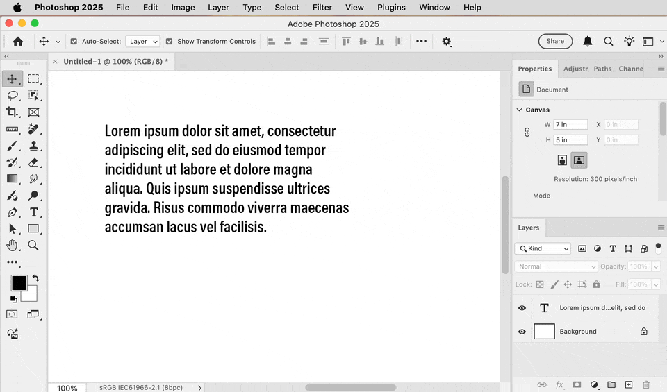

Conrad_C
Jul 28, 2025 10:16 PM UTC
If the type layer is paragraph text, how resizing changes the type layer’s contents is controlled by whether or not text editing is active. If you want to resize the layer without scaling the type, the type layer must be in text editing mode; you can see when it’s in this mode because the transform box changes to a dashed line. When you see the dashed line, you know that dragging a transform box handle rewraps the text instead of scaling the text. So before you drag a handle on the transform box of a type layer, check to see whether the box is either solid or dashed, depending on how you want to resize it, and toggle the edit mode if needed.
In the demo below, the text layer starts out selected and text editing is not active, so when I drag a handle on the solid transform box of the text layer, the entire text container scales and distorts. I undo that and enter text editing mode, which changes the text container’s transform box to a dashed line. I drag a handle on that to resize the text container and as it resizes it rewraps the lines of type inside it, instead of changing the text size.
Solid or dashed box. That’s all there is to it.

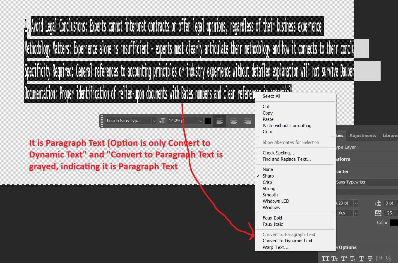

Jul 28, 2025 4:52 PM UTC
I have the same problem. The text is clearly shown as "Paragraph Text" yet when I resize the text box it resizes and even warps the text!
Help!

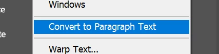

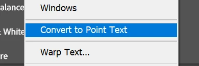

Yea sounds like you might not be familiar with the two different modes of text boxes / text layers:
  • Point Text mode: Like you're describing currently happening, the text box resizes the text within it as you resize
  • Paragraph Text mode: The text size is independent of the text box bounds
You can convert between the modes for a text layer by right clicking that text layer in the layer panel, and clicking either "Convert to Point Text" or "Convert to Paragraph Text". In your case it seems you would want to convert to paragraph text.
