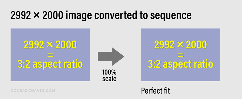

The still has to be cropped because 2992 × 2000 px is 3:2 aspect ratio, with is taller but not as wide as the 3072 × 1728 frame, which is 16:9. When the image is at 100% scaling, cropping cannot be avoided since the frames are different heights. You ask how the 1728 px video frame is “larger” than 2000 px; well, it’s larger in width. But the still image is larger in height. To fit the taller still image into the wider frame to avoid cropping the top and bottom, you applied Set to Frame Size, which scaled down the image to match the height of the 1728 px tall frame. Which leaves empty space on the sides, since they have different frame aspect ratios.
Some of this might be cleared up by seeing what happens in this animation, where all frame sizes are shown 1:1 relative to each other:
Again…ppi never comes up in the problem or the solution. In fact part of the reason there are problems is because of introducing ppi into the math. Because again, to understand size with pixels per inch, you have to say what the number of inches are on output. But there is no number of inches in video – you will not find any place in any video editor to enter inches or ppi – so anything involving inches is a wrong turn that does not lead to a solution.
You should see that what solves the problem is first stating the target final frame size, which appears to be 3840 × 2160 4K. Once you have that, you know all your original media must meet or exceed both the width and height of that in pixels in order to fill the 4K frame. If the stills exactly match both the width and height of the video frame, that will of course also match the 16:9 video frame aspect ratio. Then, to accommodate enlargement, the required width and height in pixels of a still image must be increased proportionally to how much you are required to enlarge the still images in Premiere Pro.

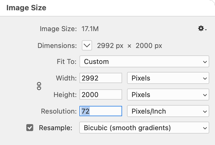

"I currently have several thousand photos to be used in an animation that were shot on a still camera at 300ppi. Their current aspect ratio is 2992x2000. By my calculations, when converted to 72dpi the pixel aspect ratio should change to 12,267x8000. But photoshop insists on resizing them to 718x480. "
Wrong calculation. When you change 300ppi to 72ppi pixel dimensions (not pixel aspect ratio, that is something diofferent) will not change(uncheck Resample while changing PPI). The only thing you can achieve is to increase print dimensions if you are sending image to print although that is not good idea.
