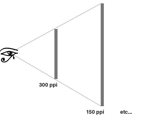

No, you need to stop and go back to start. This is the wrong way to see it. There is no "best" resolution, only what is required for whatever purpose.
Resolution expressed as pixels per inch, ppi, is exactly what it says: how many image pixels to how many inches of paper. It only applies to print.
Your image is just pixels. When you print, you want a certain minimum pixel density to get a good quality print. That imposes a limit to how big you can print it. The bigger the size, the lower the pixel density. That density is expressed as pixels per inch, ppi.
300 ppi for print is a myth. It only applies to a very specific limited scenario: offset print for books and magazines. In that scenario, 300 ppi is the theoretical upper limit. Anything higher will not give any improvement.
As size goes up, ppi requirement goes down, because it will be seen from that much farther away.
