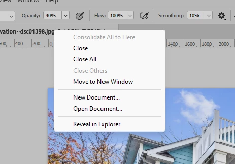

reveal in explorer js
Is it possible to use the "Reveal in Explorer" function using jsx? After using it, I want it to appear correctly in the image I am opening in Photoshop. Thank you, have a good day everyone

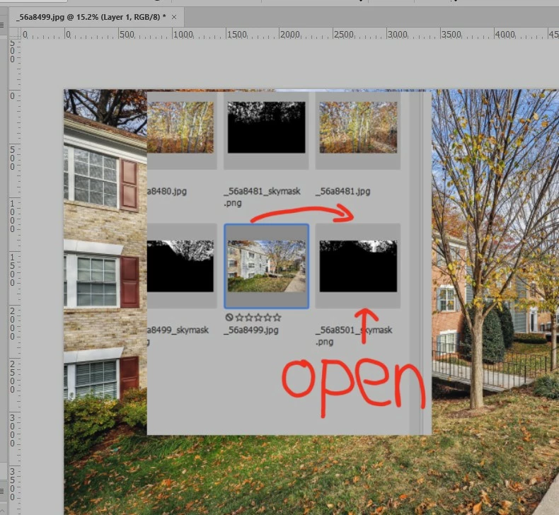

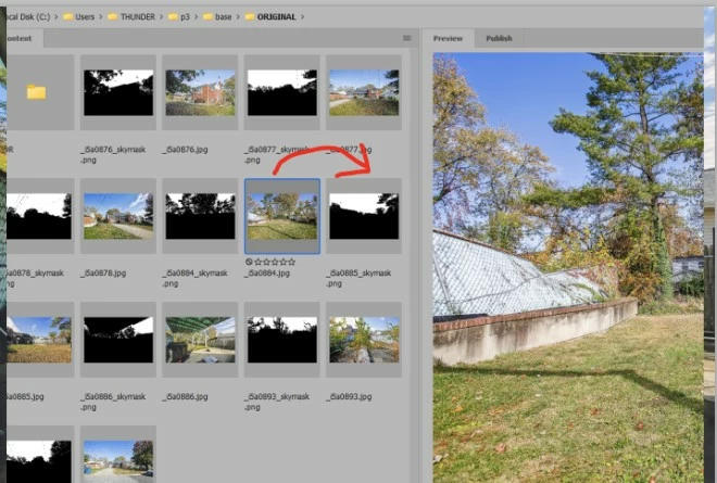

Nov 8, 2024 8:42 AM UTC
awesome genius minds, thats what i was looking for all along. but when i run the script i want it to open the image next to it in photoshop, can you help me with that?
Nov 8, 2024 9:43 AM UTC
sorry i am a foreigner so it may be difficult for you to understand. i want after running the script above to transfer to BR and i want to open the image next to the image when i run the script in PTS
r-binCorrect answer
Nov 8, 2024 11:08 AM UTC
Maybe I understood what you want

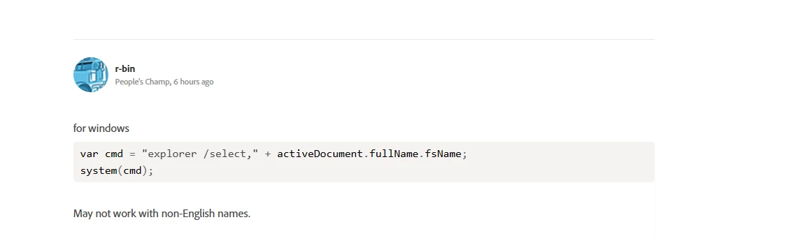

Nov 7, 2024 8:54 PM UTC
for windows
var cmd = "explorer /select," + activeDocument.fullName.fsName;
system(cmd);
May not work with non-English names.
Nov 8, 2024 2:32 AM UTC
Thank you. This is a very great answer. Exactly what I need, thank you again. Wish you a good day

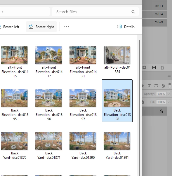

Nov 7, 2024 7:29 PM UTC
@trường_1768
Set a variable to the Folder object, and then you can use .execute() to open the folder in either Windows Explorer or the Finder on the Mac.
var theFolder = Folder(app.activeDocument.path);
theFolder.execute();
Or just skip the variable:
Folder(app.activeDocument.path).execute();
I don't know how to have the file selected in Explorer, that would probably take some extra scripting to call on local operating system commands.
