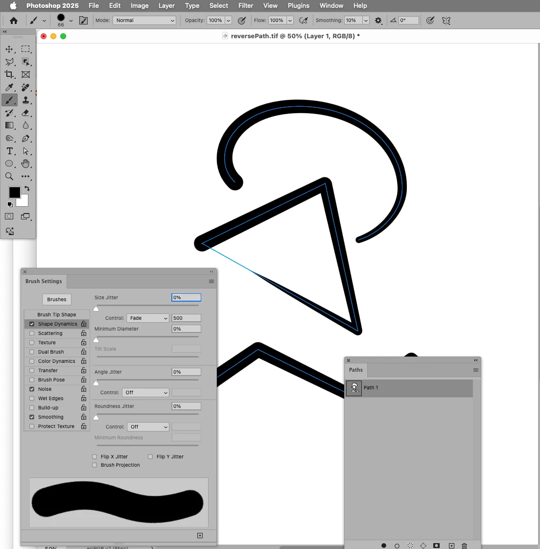

I'm trying to reverse a path in Photoshop.
So a simplied version is a two point path, in which a stroke fades along its length.  I want to reverse the direction - flipping the image will work, but only for this simple example. Not a long term solution.
I know this can be done by taking said path into Illustrator and reversing Path Direction. I'm looking for a Photoshop only solution.
I know about changing shapes from Combine Shapes to Subtract Front Shape. However, that don't work .

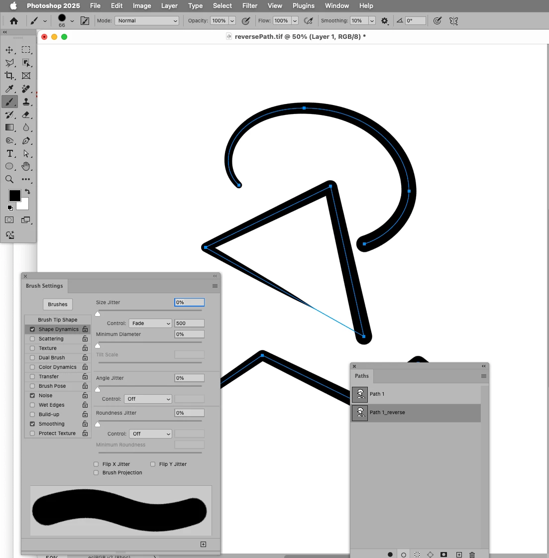

c.pfaffenbichler
c.pfaffenbichlerCorrect answer
Jul 26, 2025 10:38 AM UTC
Does the Script work for you or do you need the original Path to be edited instead of getting a duplicate?
edit:

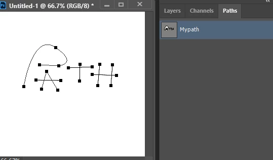

paths as in path paths, not file paths, vector mask paths or a path in the woods.
These bad boys:
See what I did there 😄

} else {
var thePath = collectSelectedPathPathInfoFromDesc ();
var theName = selectedPath[2]
// revert pathpoints etc.;
var theReverse = new Array;
for (var m = 0; m < thePath.length; m++) {
    var thisOne = thePath[m];
    var newOne = new Array;
    for (var n = thisOne.length - 3; n >= 0; n--) {
        newOne.push ([thisOne[n][0], thisOne[n][2], thisOne[n][1], thisOne[n][3]])
    newOne.push (thisOne[thisOne.length-2]);
    newOne.push (thisOne[thisOne.length-1]);
    theReverse.push (newOne)
// create path;
createPath2022(theReverse,theName+"_reverse")
