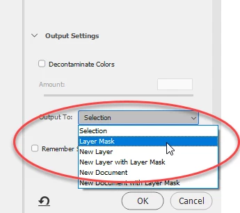

    davescm
    May 12, 2018
    What are your "output to" settings in Select And Mask ?
    Dave
