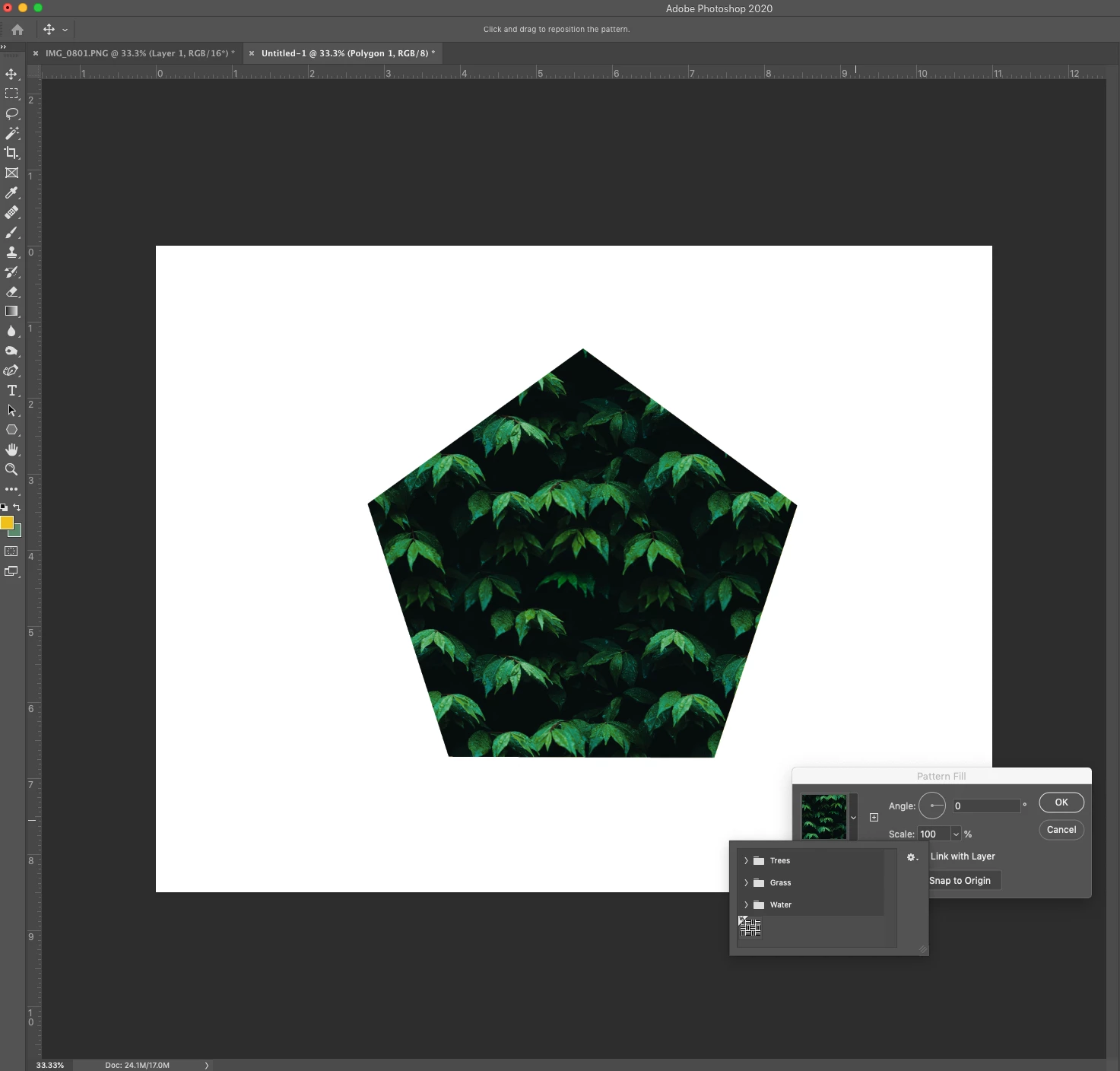

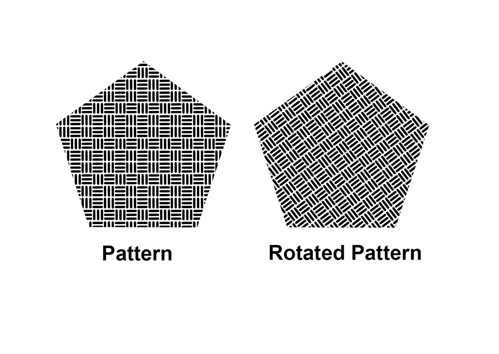

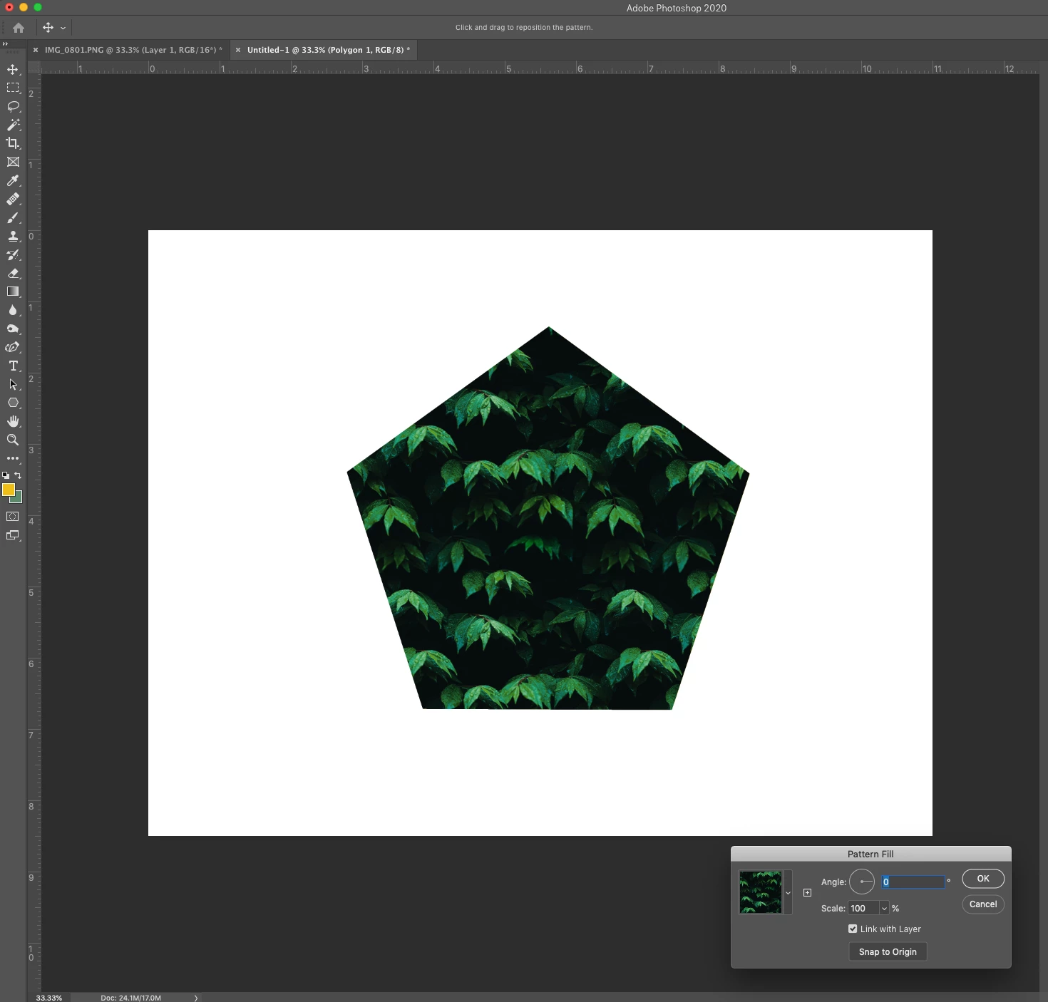

One of the cool new features found in the June 2020 release of Photoshop is rotatable patterns. This feature allows you to rotate patterns (non-destructively) to change the angle of the pattern. You can change the orientation of any pattern in Pattern Overlays, Pattern Strokes, and Pattern Fill Layers. For this tutorial, I will rotate a pattern fill layer.

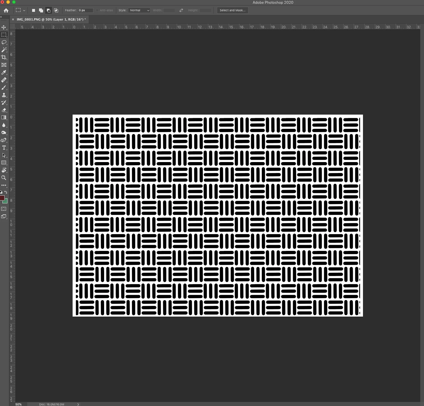

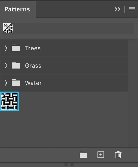

❶ Create a pattern (or use an existing one)
  • Open the image you want to make a pattern from
  • If you prefer, you can choose a pattern from the Window>Pattern panel

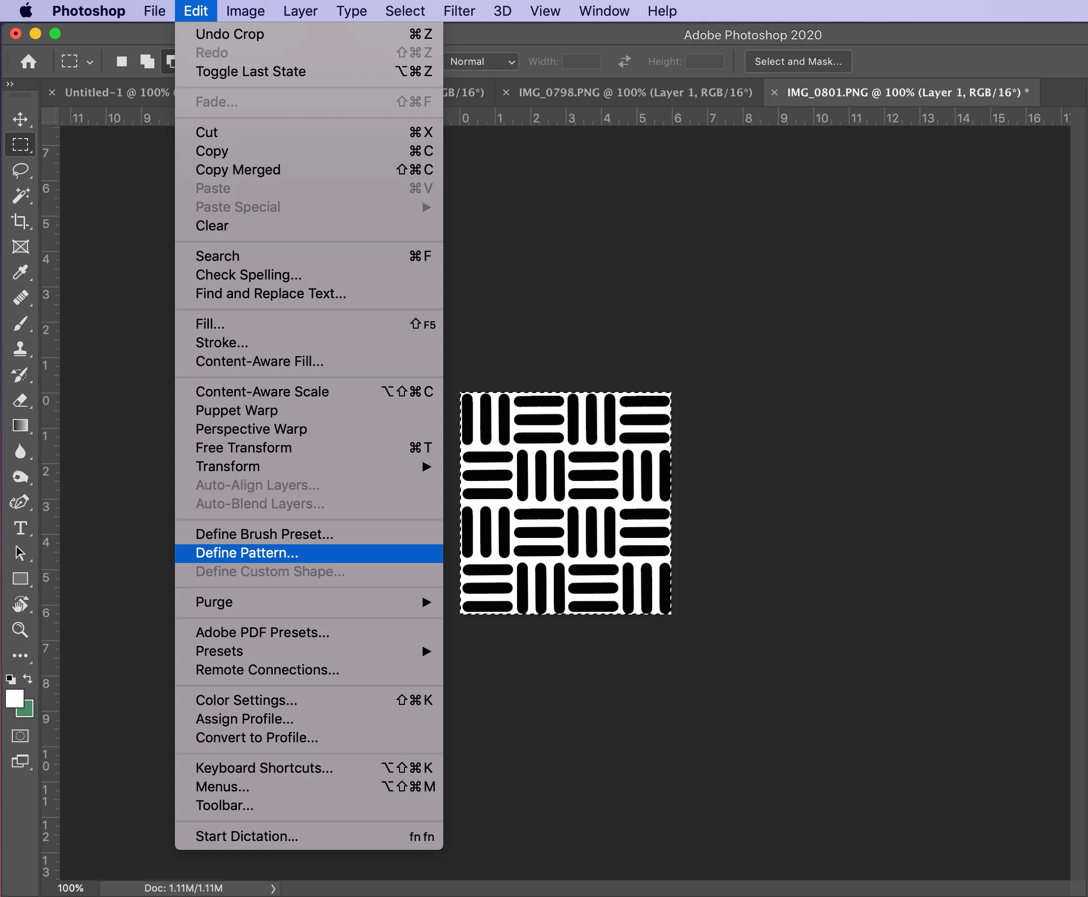

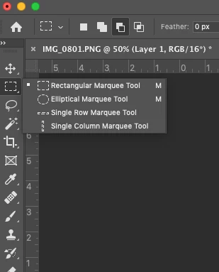

  • Select the Rectangular Marquee tool
  • Select an area to use as a pattern. (Ensure feather is set to 0 pixels)  

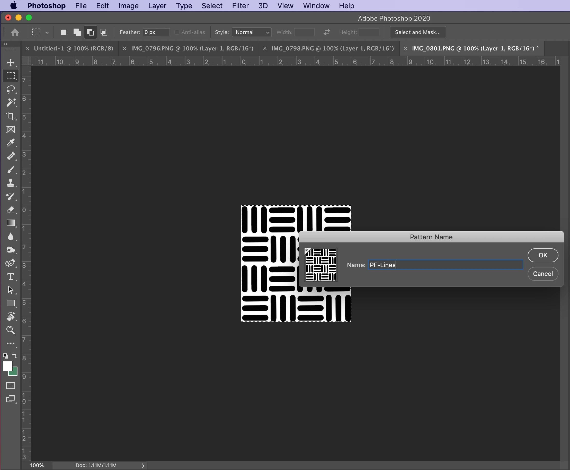

  • Choose Edit > Define Pattern
  • Type a name for the pattern  in the dialog box

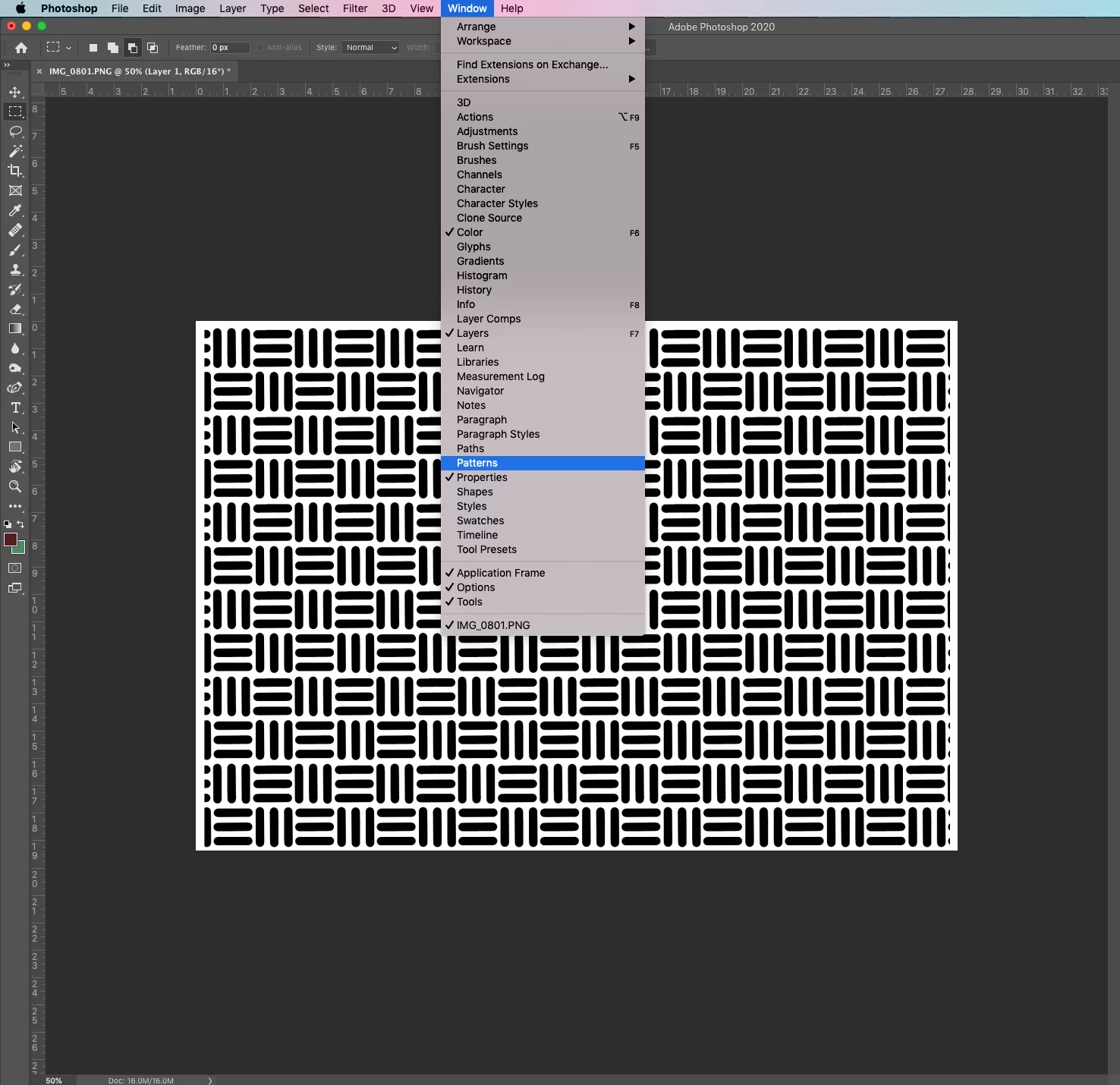

  • Open the pattern window by navigating to Window>Pattern to see your new pattern
  • The new pattern now appears in the panel

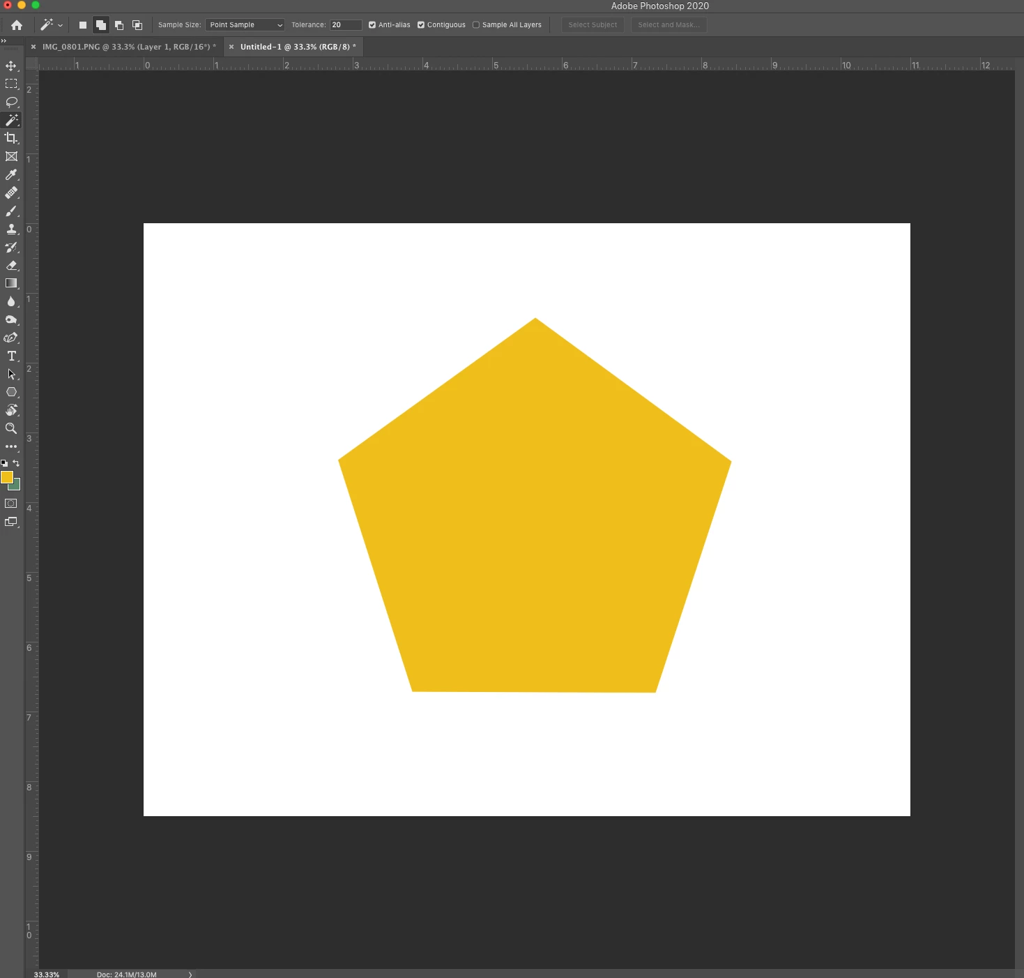

❸ Select an area to fill
❹ Fill the selection with a pattern

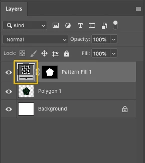

  • From the menu, select  Layer> New Fill Layer > Pattern
  • Click OK
  • Click on the pattern thumbnail for select from different pattern options
  • Select the pattern you just created

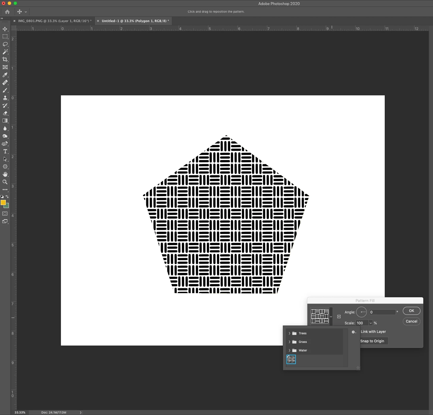

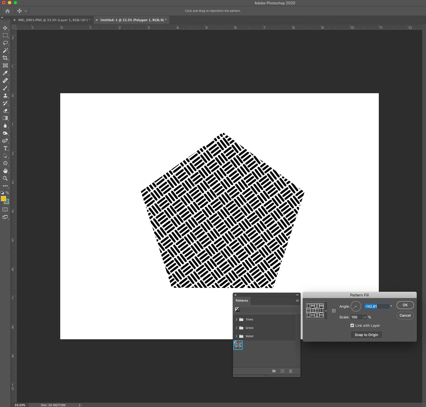

❺ Rotate the pattern
  • Adjust the angle of the pattern in the Pattern Fill dialog,
  •  If you want to adjust the angle later, just click on the pattern in the layers panel and change the angle
Note: The pattern angle selector can be accessed from these locations in the user interface:

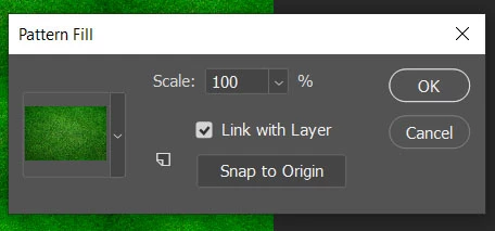

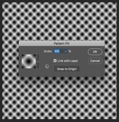

 There is no angle option available how i enable it ?
like This one
Jeff Arola
May 1, 2022
What version of photoshop do you have?
You can see the exact version from within photoshop by going to Help>System Info and looking at the top line.

July 1, 2021
Hi all
I am on a Mac, Photoshop CC 2019, and the rotate pattern control doesn't appear at all, what's wrong?

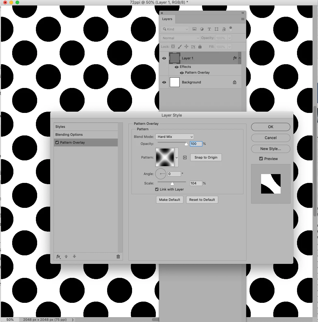

August 11, 2020
I can easily reproduce the issue of the 104% scaled Pattern Overlay by defining the Style with a 100% Patttern at 72ppi and applying it at 75ppi.
chet60, sorry about the private message, the thread seems active now, so either I made some mistake or there was a temporary snafu.

Here is the workflow for building, defining patterns and assigning weaves in photshop.
1. New file :  Resolution (matching the loom) in this case 75ppi.
     build the pattern, define it.
2. New file: image - colors reduced- colors deconstructed into layers.
   Resolution: (matching the loom) in this case 75 ppi.
3. Apply layer style....and result should be 100% on first one?
 (I have seen that if you catch and correct the first pattern overlay - the rest will be correct like a "sticky" setting should.)
I see that you used 72ppi and 75 ppi.....
I am often asked what resolution to use for the patterns.  They are very small. 2x2, 4x4, 8x8, up to 24 x 24 or so.  I usually respond that they should use the same resolution as the loom - to reduce errors - i.e. things they forget to check. The resolution is the baseline in this process. 1 pixel = 1 thread. So most of the time - these 2 values are the same. (sometimes I don't do it...but over time I have checked to see if this has an impact and I havent seen it. )
Do you see that you do?

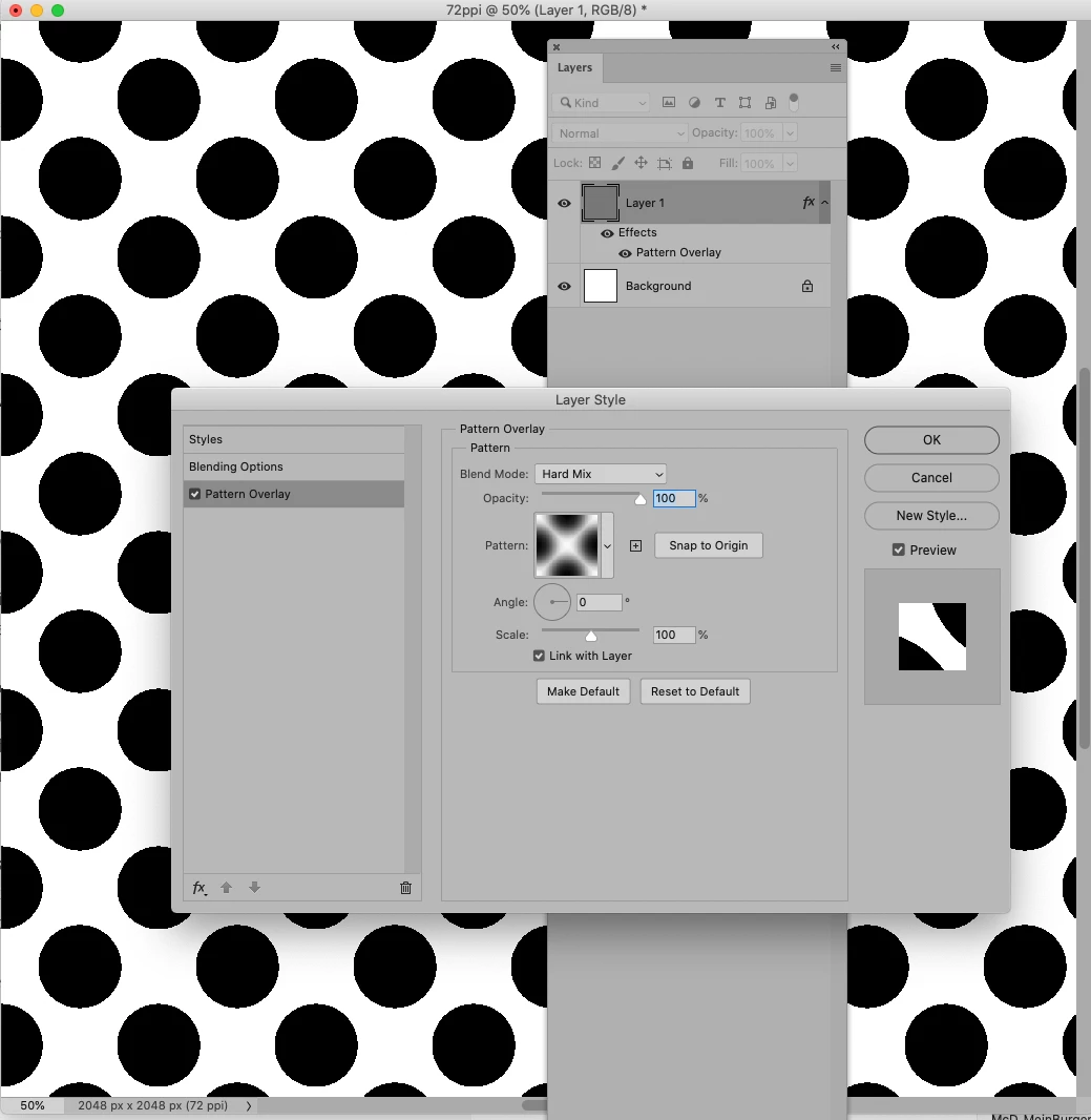

c.pfaffenbichler
August 11, 2020
The issue appears to be that the resolttions for the file in which you define the Style and the one in which you apply it are not the same.
In the screenshots you can see the resolution in the Status Bar (bottom left) and the same applied Style has the Pattern at 100% at 72ppi and 104% at 75ppi.
Apparently the Patterns in Styles are applied according to length measurements (as in mm) and not in percent or plain pixels – so resolution matters.
So just make sure that all the files have the exact same resolution.
If the issue arises descpite this please provide the files (the one in which the Style is defined, the one in which it is applied and the asl-file) for testing.

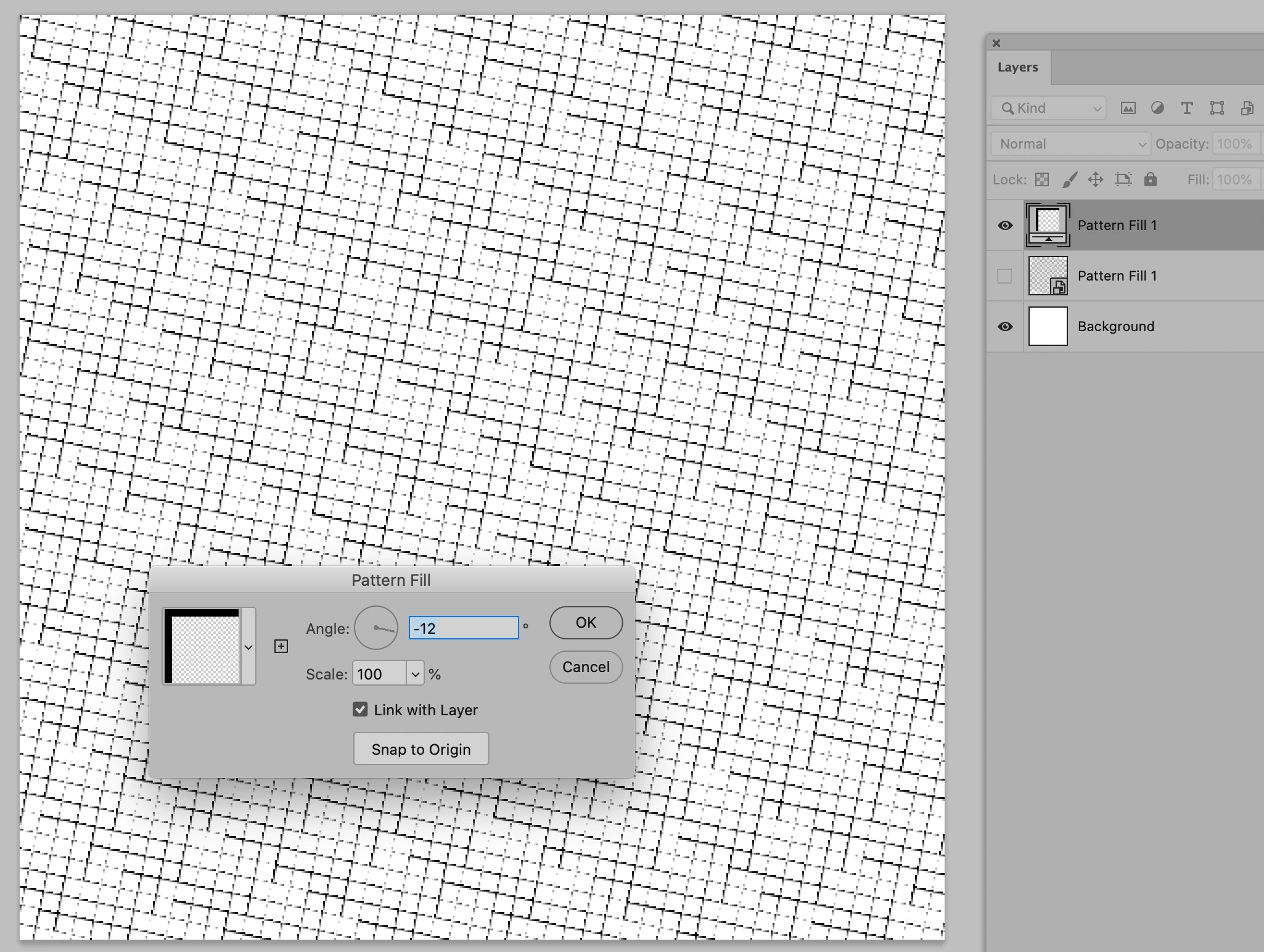

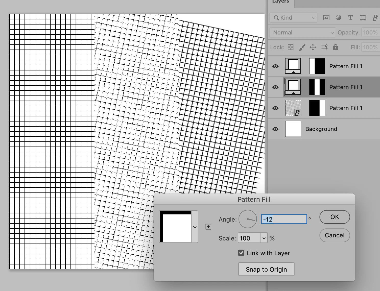

And another thing:
Why are the rotation angle vaues negative compared to rotating Layers?
The Smart Object is roated 12˚, the Pattern -12˚.
c.pfaffenbichler
June 26, 2020
And to make sure that the transparency in the Pattern was not the problem here a screenshot with a Pattern that has no transparent pixels (unrotated, rotated Pattern, rotated SO):
Lukas Engqvist
July 14, 2020
It seems that the pattern tiles are not antialiased when rotated, so that of you have a pattern that is same colour on both edges it will tile better… having seen this the pattern example you have is the worst case scenario… yes it needs to be fixed. Hope it can be reproted in a good way.

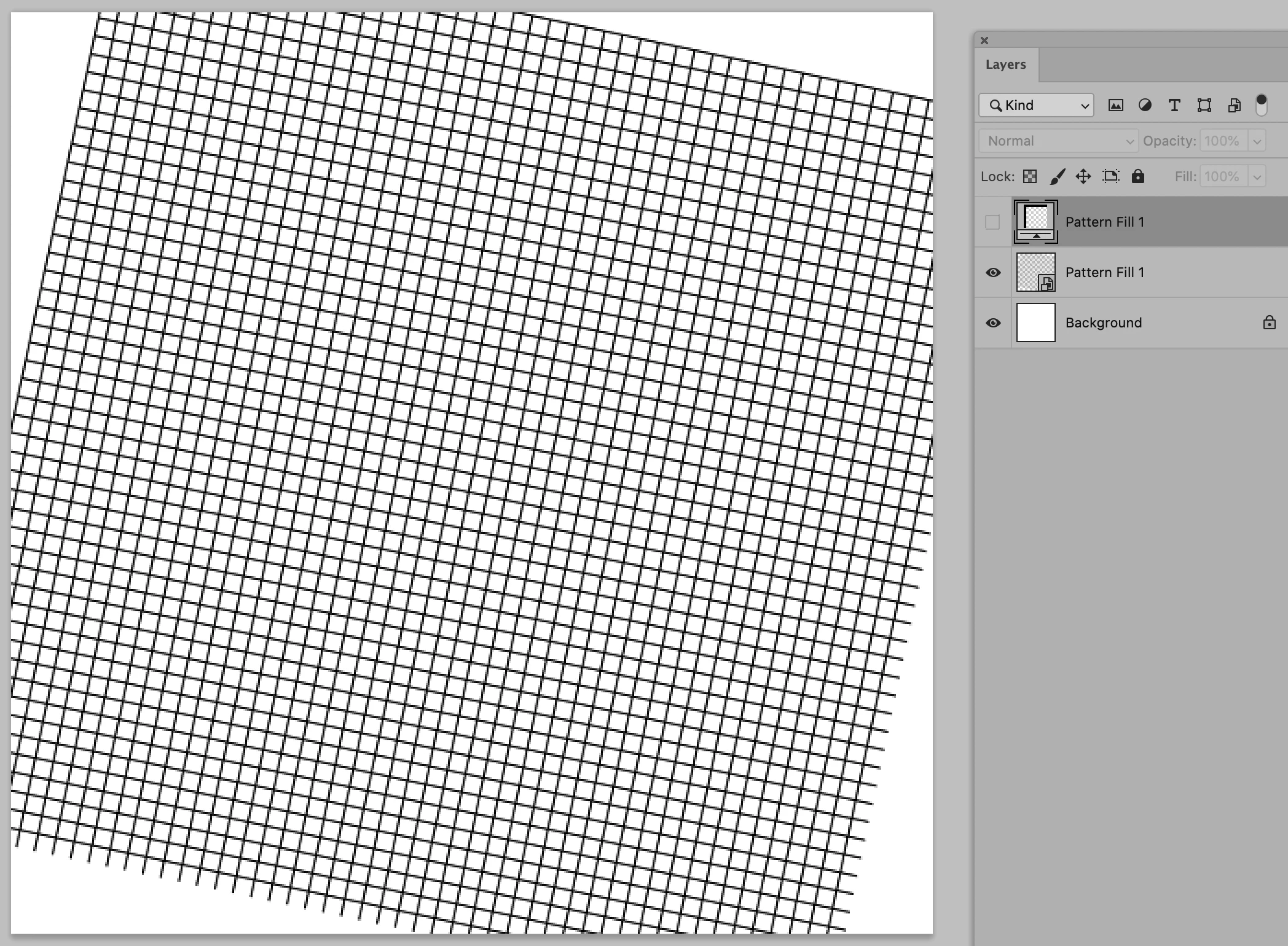

c.pfaffenbichler
June 26, 2020
Too bad the feature uses such a bad resample method … compare a rotated Smart Object with the Pattern to the rotated Pattern in the screenshots:
Edit: I appreciate that »bad« is an ambiguous term here but I think the undesirability of the result in the example should be evident.
