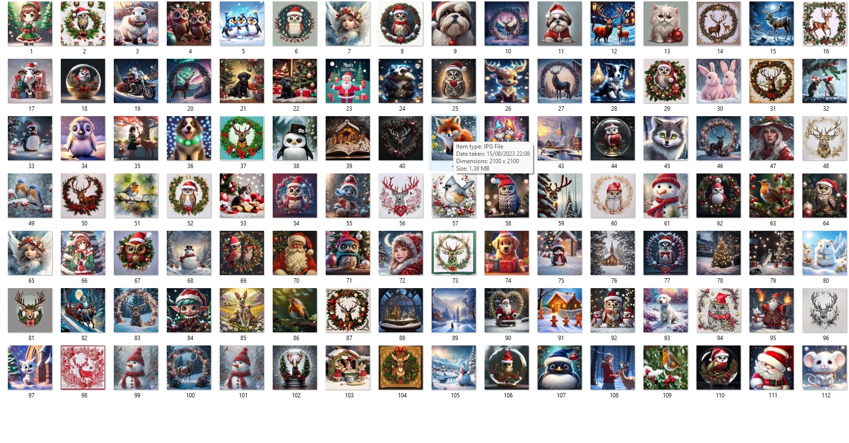

October 7, 2023
This is how i have the files named......
October 7, 2023
The action cuts out a section on each photo (as a batch), but when saving them it mixes them all up.
