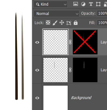

I realise this is an old thread, but it has just appeared at the top of my feed, and there no new answers I can see.  Anyway, If I wanted to control a tapering edge’s softness, I would make if fully hard. Then you could Ctrl click to select, add a layer mask, shift the mask edge into the outline, and feather the mask.
Or, I might Ctrl click to load the selection. Convert the selection into a Path and stroke the path with the blur tool.

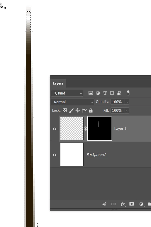

Or, Ctrl click to load the selection.
Add a layer mask that will conform to the same size.

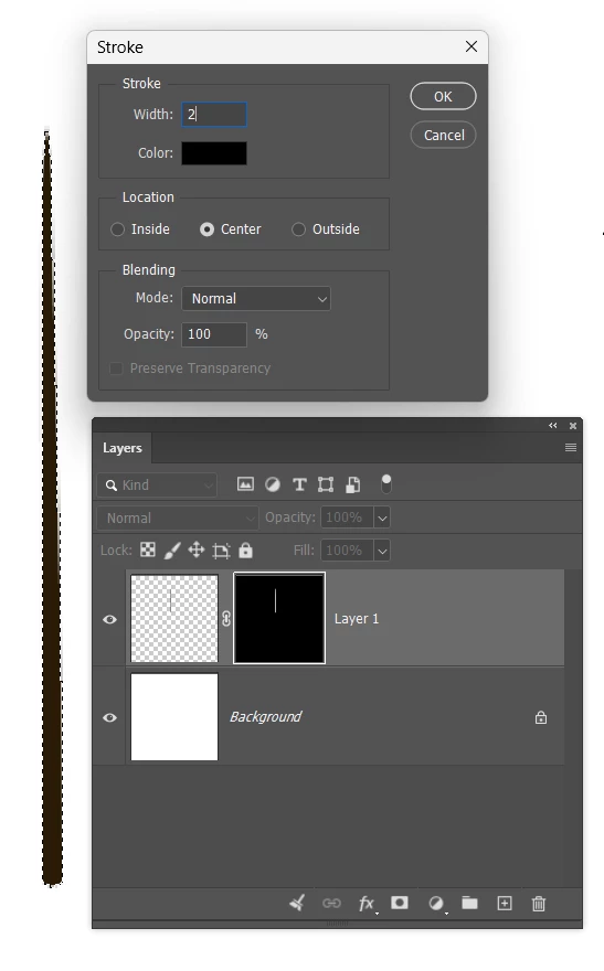

With the mask selected, use Edit > Stroke and stroke with black using an even number and Centre.
After the stroke.

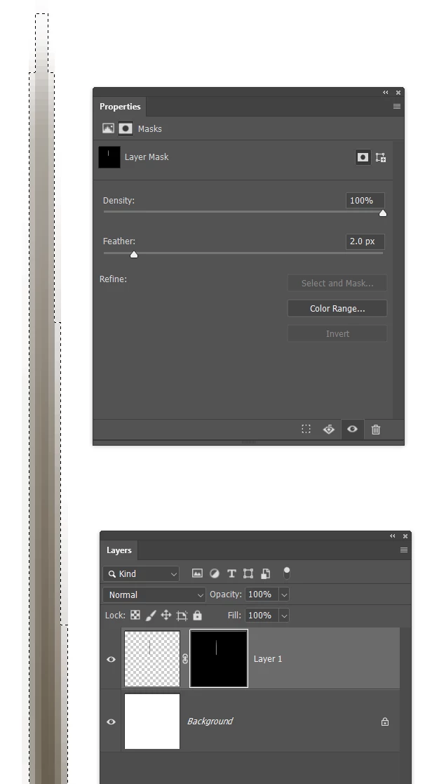

And feather the mask. This is the same zoom ratio as the previous screen shot
And next to a copy of the same layer at 100% with the mask disabled.
I sometimes think people are unaware that they can much the same in a layer mask (albeit in B&W and 8 bit) as with the layer itself.  You can run filters. You can select just part of the mask and blur, or use a filter. You can use Edit > Fade (immediately after, as with the actual layer).  I think it was Bert Monroy who first woke me up to this.
