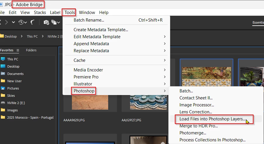

You could try merging the files manually as a start point.
Load them into Photoshop layers.  You can do that automatically from Bridge.

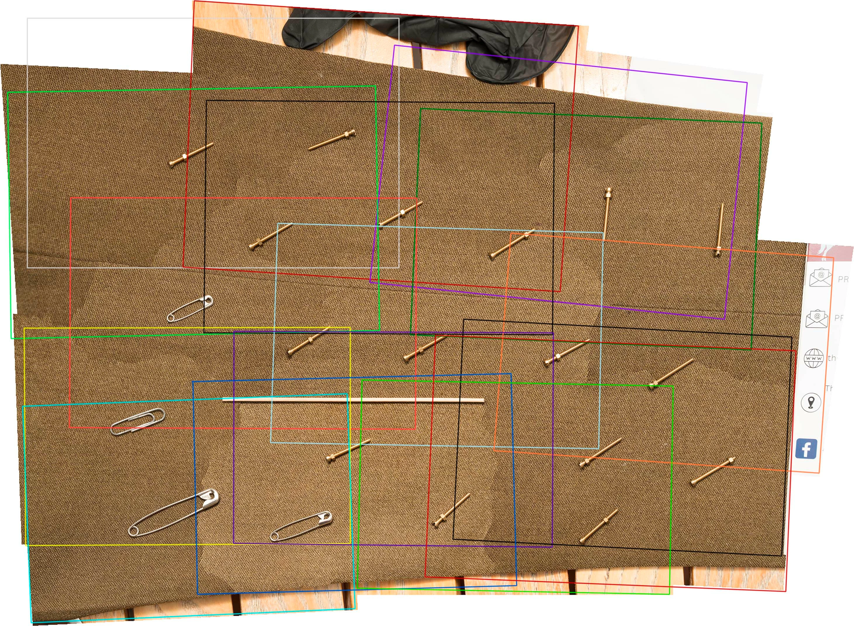

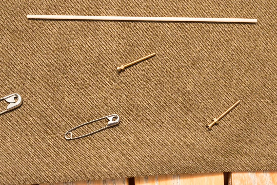

attached are three of the tiles and an overview of where the tiles were. clearly differing in lightness, just need to equalise the lightness, though having done that between two of them I could see a need for slight saturation change, if only photomerge had an option that allowed selection of a target pic and others were changed to match. I tried the edit auto align layers and couldnt get that to work.
My 1920x1200 monitor measures 20" wide x 12.5" tall and the trousers were about that for the area photographed.
I am gobsmacked that ACR does not have a selection tool giving lightness saturation and hue value as it has in pshop. ACR is where adjustments can be made to values to match but no data readout of such per image on screen in a sampled area, archaic to not have such.
