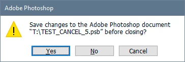

I think this is the key:
As long as you click no here, you'll be fine. You don't get that in "Save As" (not applicable), only "Save".

The question now is - can this happen in a Save (not Save As), where you will overwrite the original? So far, I haven't been able to make that happen. I get the prompt to save changes, which obviously I click no to, and the file remains in its original state.  I'll try a few more times.
