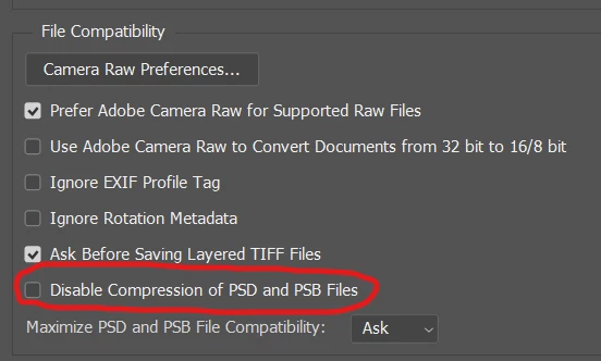

June 16, 2025
Here's one suggestion:
* Go to - Edit > Preferences > File Handling...
* Then look for 'Disable Compression of PSD and PSB Files' (as below). Make sure it is unchecked and press OK
If the above does not help, share what version of Photoshop you have, OS and your computer specs.
SC-Agency
SC-AgencyAuthor
June 16, 2025
Thanks, but perhaps you did not read my entire original post where I indicated that item is unchecked?
