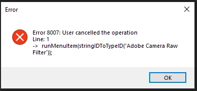

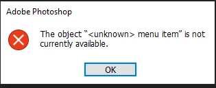

I have been unable  to create a Photoshop script to Opme ACR as a filter.
runMenuItem(stringIDToTypeID("Adobe Camera Raw Filter"));
generates an error
The scriptlistener Plug-in seems the generate a step before the menu Item step that seems to bet required.

The code  Stephen A Marsh posted works
JJMack
Stephen Marsh
December 8, 2020
Hi JJMack, looks like Adobe has broken that single liner from Kukurykus... (Correction, the code works)

executeAction(stringIDToTypeID('Adobe Camera Raw Filter'), undefined, DialogModes.ALL) Still works one my Windows Machine in Photpshop 22.1
