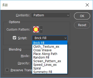

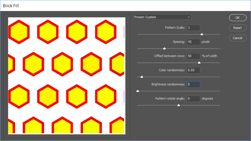

Here's using the Deco Fill script, which has sliders to adjust some of the pattern placement:

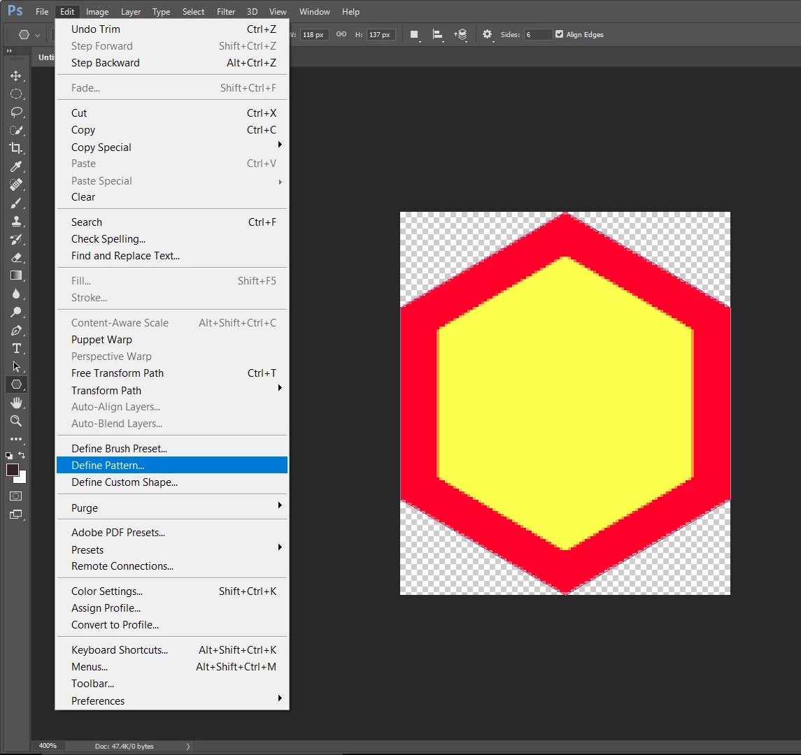

Make a patter:
Under the Edit menu, select "Fill" and use Pattern for contents, and click on the Script box. Then Select the type of fill you want from the drop down list.
Click Okay, and the next dialog box will appear, where you can adjust the pattern's placement:
When you're happy with the placement, click OK:
