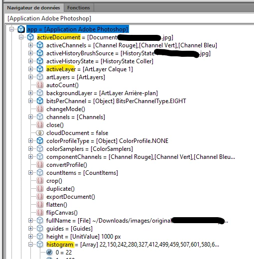

We have issues to access to the propriety "histogram" of the activeLayer and not activeDocument. Do you have any idea how to change the source of the histogram ? On the interface it's really easy but with the code it's a mystery for us 😞

what do you use to navigate the data structure of the activeDocument in your screenshot?

Usually, one would dupe the active layer to a new temp doc, check the histogram and then close the temp doc without saving.
I can't remember how scripting histograms works with selections.
As @c.pfaffenbichler wrote, if you know where to correctly place a color sampler it may be better to use that.

Why don’t you use the Color Picker instead of creating a new Layer?
And might you be mixing ESTK and UXP code? That would not work out well.
