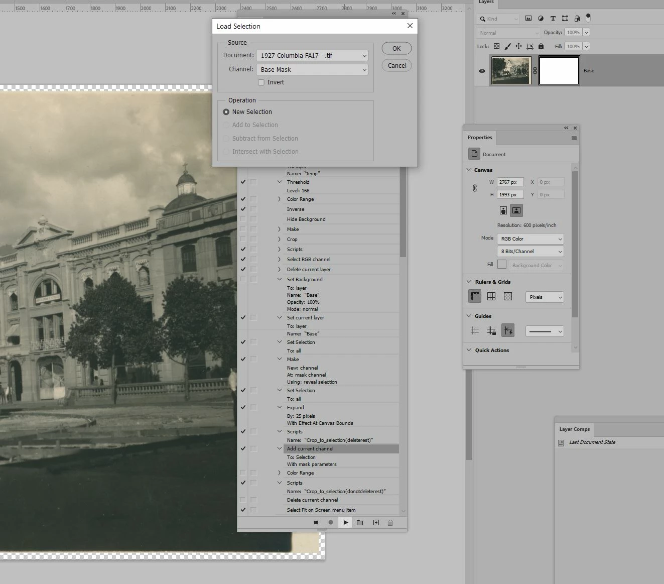

I have a recorded action where parts of it is running scripts in order to achieve what I need.
I now need a piece of script that will add the mask of the current layer to selection. I have tried and tried (with the help of Claude.ai 😁), but cannot get it to work. Can you help me?

I assume things might improve but so far when people come to this Forum with ai-generated code it often appears to be pretty bad.
Could you please post screenshots taken at View > 100% with the pertinent Panels (Toolbar, Layers, Channels, Options Bar, …) visible to illustrate what exactly you are trying to automate?
As far as I can tell loading transparency as a Selection should work even in Actions as should loading the active Layer’s Layer Mask as a Selection.
September 22, 2024
 I can get it to work with a recorded action, but then I have to manually press ok in this pop-up every time I run my action.

@Chris201Chris
Notice the difference in your action recording vs mine:
Record the action as follows:
Ensure that the layer with the mask is active/targeted/selected. With a selection active, hold down the Shift key and the Command or Ctrl key and click on the layer mask icon in the Layers panel with the mouse. Stop recording.
