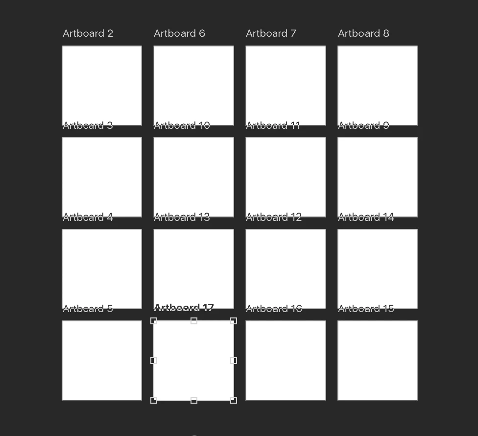

Can you upload image how result of script should look at your screen?
Oct 30, 2017 2:14 PM UTC
Here is more description A simple script to rearrange selected artboards into a grid with the option of how many rows and columns + how much spacing between them vertically and horizontally. Preferably in the order they're laid out in the layers panel. This is all assuming that the selected artboards have the same dimensions to make the math slightly easier. Final result will be as in screen shot.
