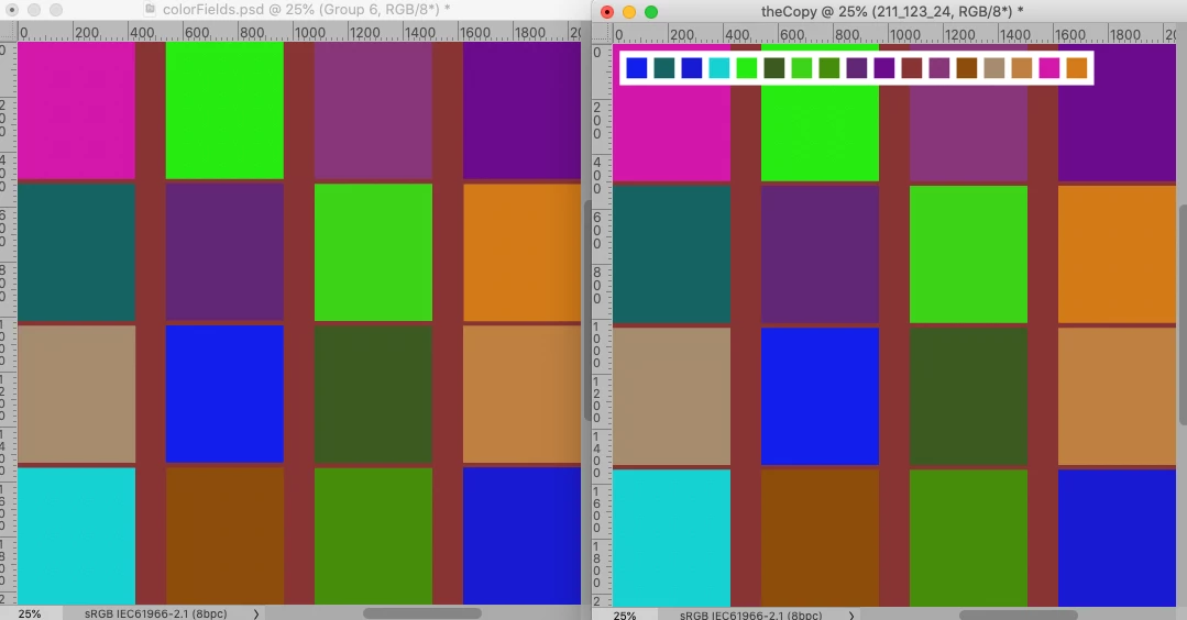

c.pfaffenbichler
Apr 4, 2021 11:37 AM UTC
It is not an elegant Script and with a 2048px by 2048px image it takes more than 80sec for me, but it creates Shape Layers for up to 30 colors.
Edit: The Script compares the possible combinations of the three Channel historgram values against the actual colors with a Layer set to Blend Mode »Difference« … so that takes time.
If the color areas are anti-aliased or blurred it naturally will not work.
// create shape layers for colors used in image up to 30;
// 2021, use it at your own risk;
if (app.documents.length > 0 && activeDocument.mode == DocumentMode.RGB) {theStuff ()};

        var idnull = stringIDToTypeID( "null" );
            var ref5 = new ActionReference();
            ref5.putEnumerated( idadjustmentLayer, idordinal, idtargetEnum );
        desc50.putReference( idnull, ref5 );
        var idto = stringIDToTypeID( "to" );
            var desc51 = new ActionDescriptor();
                var list5 = new ActionList();
                    var desc52red = new ActionDescriptor();
                        var ref6 = new ActionReference();
                        ref6.putEnumerated( idchannel, idchannel, stringIDToTypeID( "red" ) );
                    desc52red.putReference( idchannel, ref6 );
                        var list6 = new ActionList();
                        var thisArray = theArray[0];
                        for (var m = 0; m < thisArray.length; m++) {
                            addCurvePoint (list6, thisArray[m])
                    desc52red.putList( idcurve, list6 );
                    var desc52green = new ActionDescriptor();
                        var thisArray = theArray[1];
                        ref6.putEnumerated( idchannel, idchannel, stringIDToTypeID( "green" ) );
                    desc52green.putReference( idchannel, ref6 );
                    desc52green.putList( idcurve, list6 );
                    var desc52blue = new ActionDescriptor();
                        var thisArray = theArray[2];
                        ref6.putEnumerated( idchannel, idchannel, stringIDToTypeID( "blue" ) );
                    desc52blue.putReference( idchannel, ref6 );
                    desc52blue.putList( idcurve, list6 );
                list5.putObject( idcurvesAdjustment, desc52red );
                list5.putObject( idcurvesAdjustment, desc52green );
                list5.putObject( idcurvesAdjustment, desc52blue );
            desc51.putList( idadjustment, list5 );
        desc50.putObject( idto, idcurves, desc51 );
    executeAction( idset, desc50, DialogModes.NO );
    return app.activeDocument.activeLayer;
    ////// add curve point //////
    function addCurvePoint (theList, valuePair) {
    var desc11 = new ActionDescriptor();
    desc11.putDouble( charIDToTypeID( "Hrzn" ), valuePair[0] );
    desc11.putDouble( charIDToTypeID( "Vrtc" ), valuePair[1] );
    theList.putObject( charIDToTypeID( "Pnt " ), desc11 );
