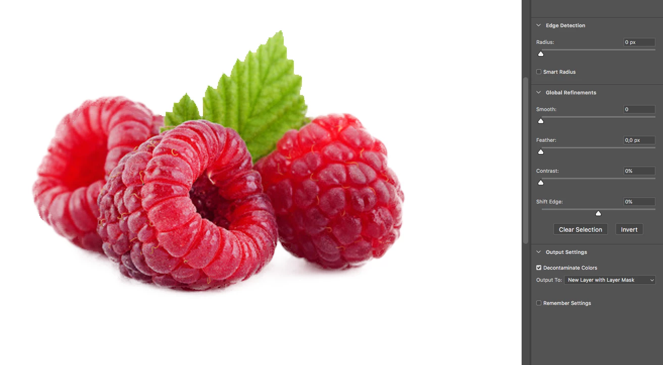

After latest updates to 2017.1.1 I have problems to decontaminate colors when I'm masking image and getting really strange results.
Simply I select image white background by magic wand tool, Select and Mask tool with refined edges. I used to use selection Decontaminate colors.

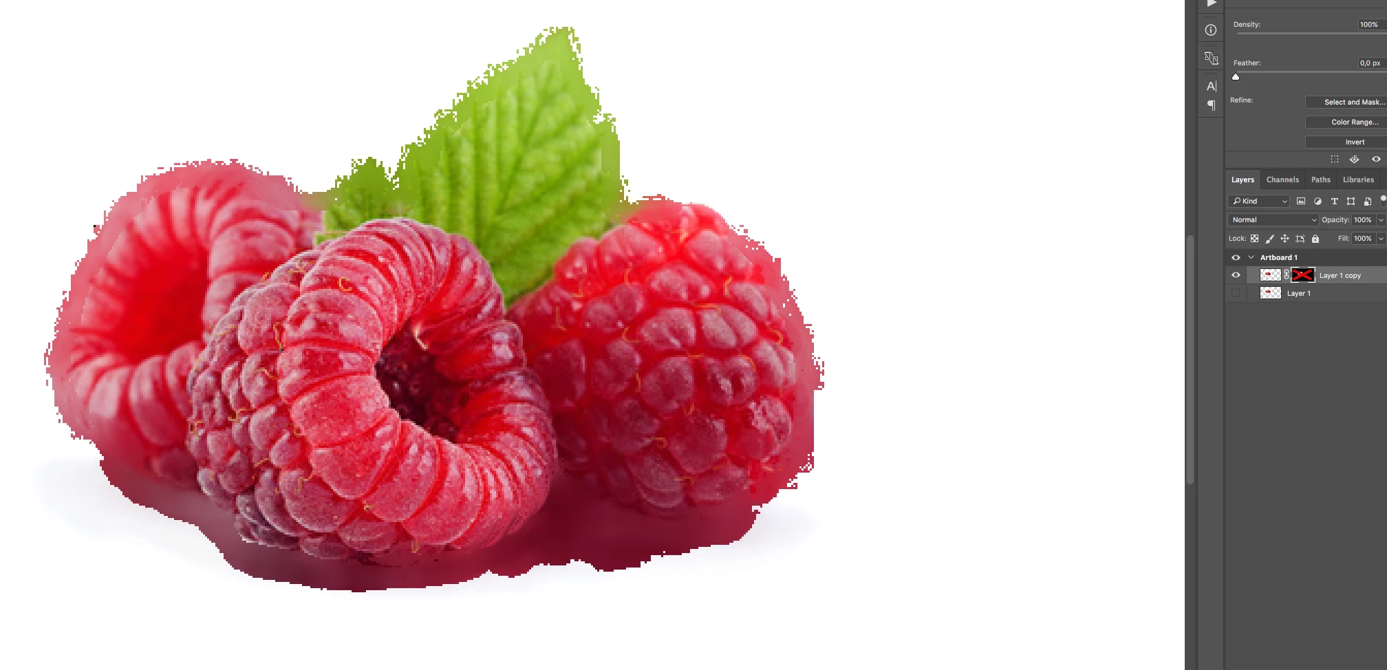

During work when I switch off the mask I will get this result like never before. I don't know why.
Anyone had this experience?

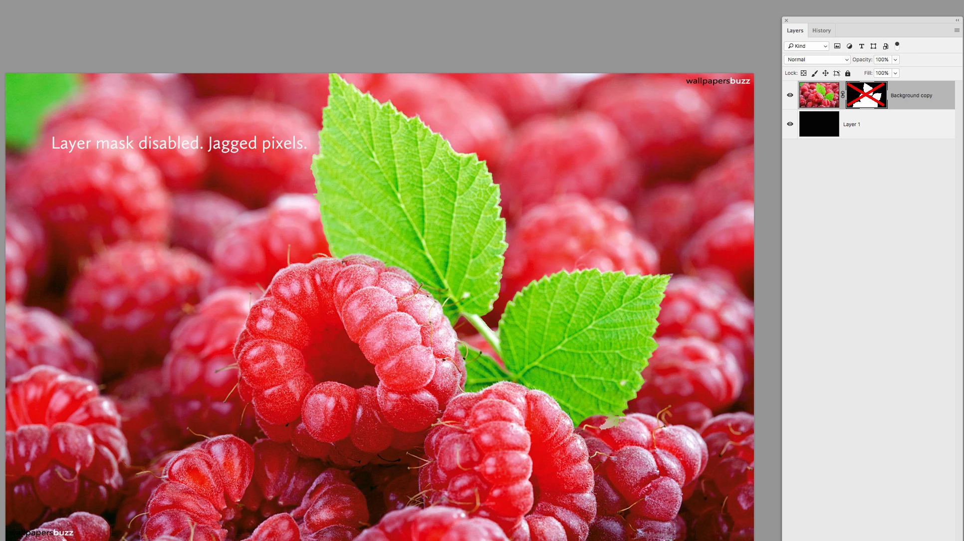

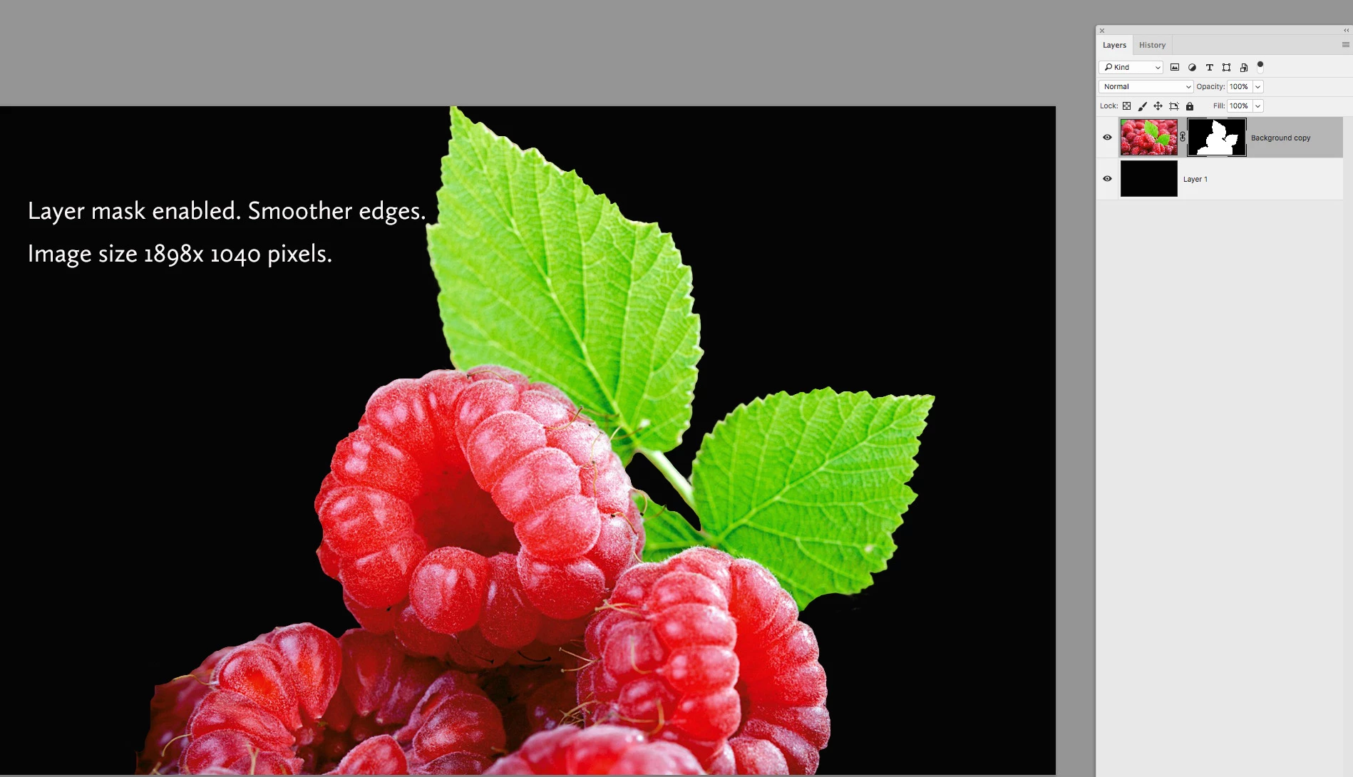

I tried this on a similar image of raspberrries downloaded from Google images. When the mask is disabled, there is a bit more pixelization around the selection edge with this method, though not quite as severe as you have experienced here.(see attached images) I would suggest that is a result of the refining of the edge with the Refine edge brush and using the Decontaminate Colors option, which is going to have a tolerance setting that affects how the edge is rendered. Once the layer mask is created, it appears to recalculate the transition edge, resulting in a smoother, less pixelated selection. I don't see this as a cause for concern.
What is the resolution of your image? This may be a significant factor in the edge pixelization.
Jun 9, 2017 1:50 PM UTC
One more thing-Your image has already been isolated on a transparent background, and your layer mask is further isolating the edges in your layer. Did you make an initial selection, delete the pixels around the raspberries, and then revisit the selection using the select and mask option to refine it further? Deleting pixels with a low res image selected could also result in a ragged edge, especially if the tolerance of the tool was low.
