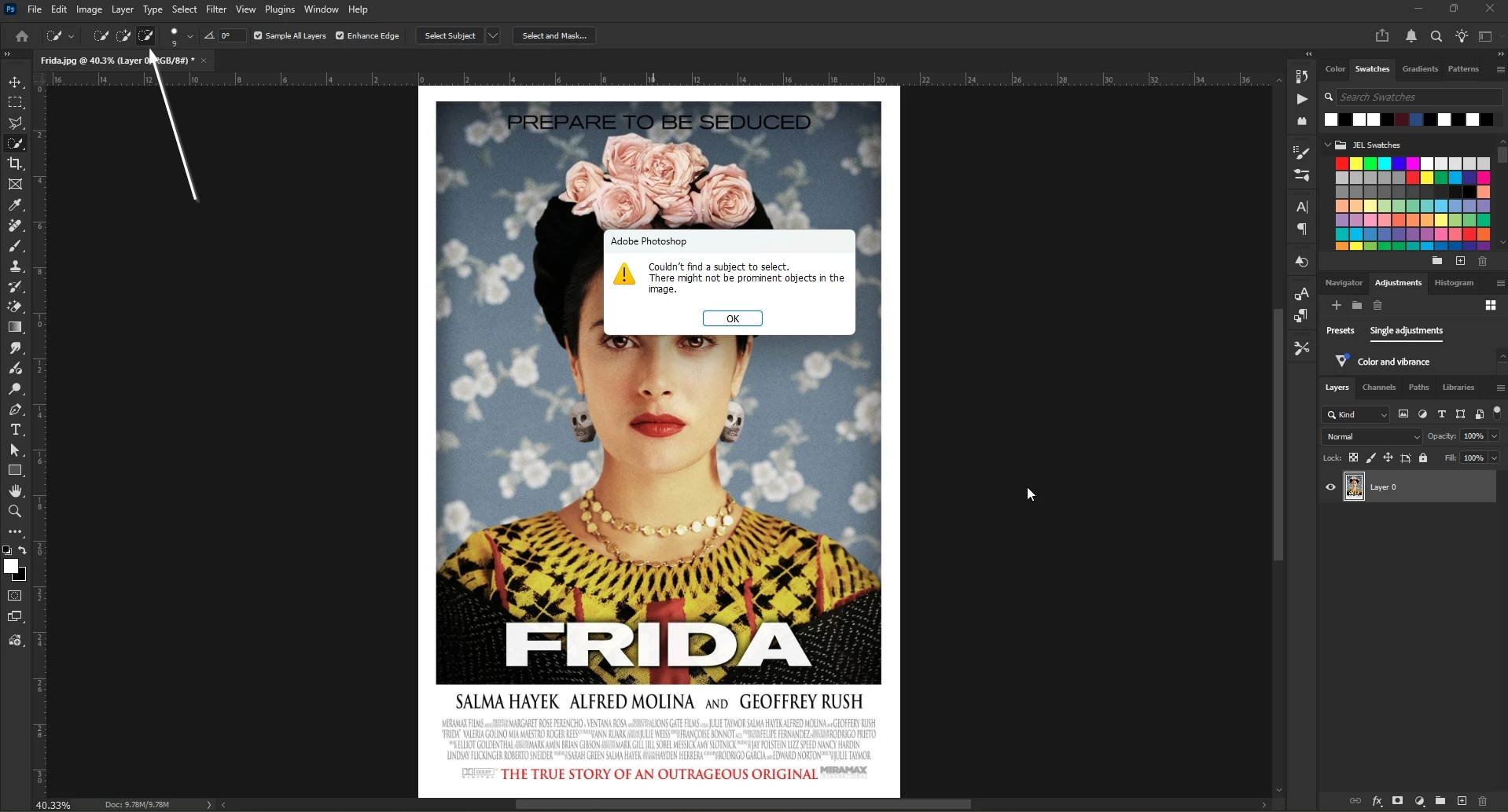

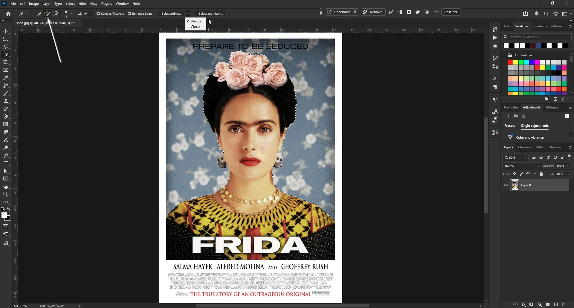

Nov 19, 2025 4:11 PM UTC
Hi @default94qssmbxg8az — see my screenshot on using “Device” with Select Subject. Can you check to see if the plus (+) sign for “Add to selection” is active before making your selection? Because if the minus (-) sign is selected, I get the error message “Couldn't find a subject to select. There might not be prominent objects in the image.” That does seem to be a type of bug. (Windows 11 Pro; Photoshop 27.0.0 Release).
