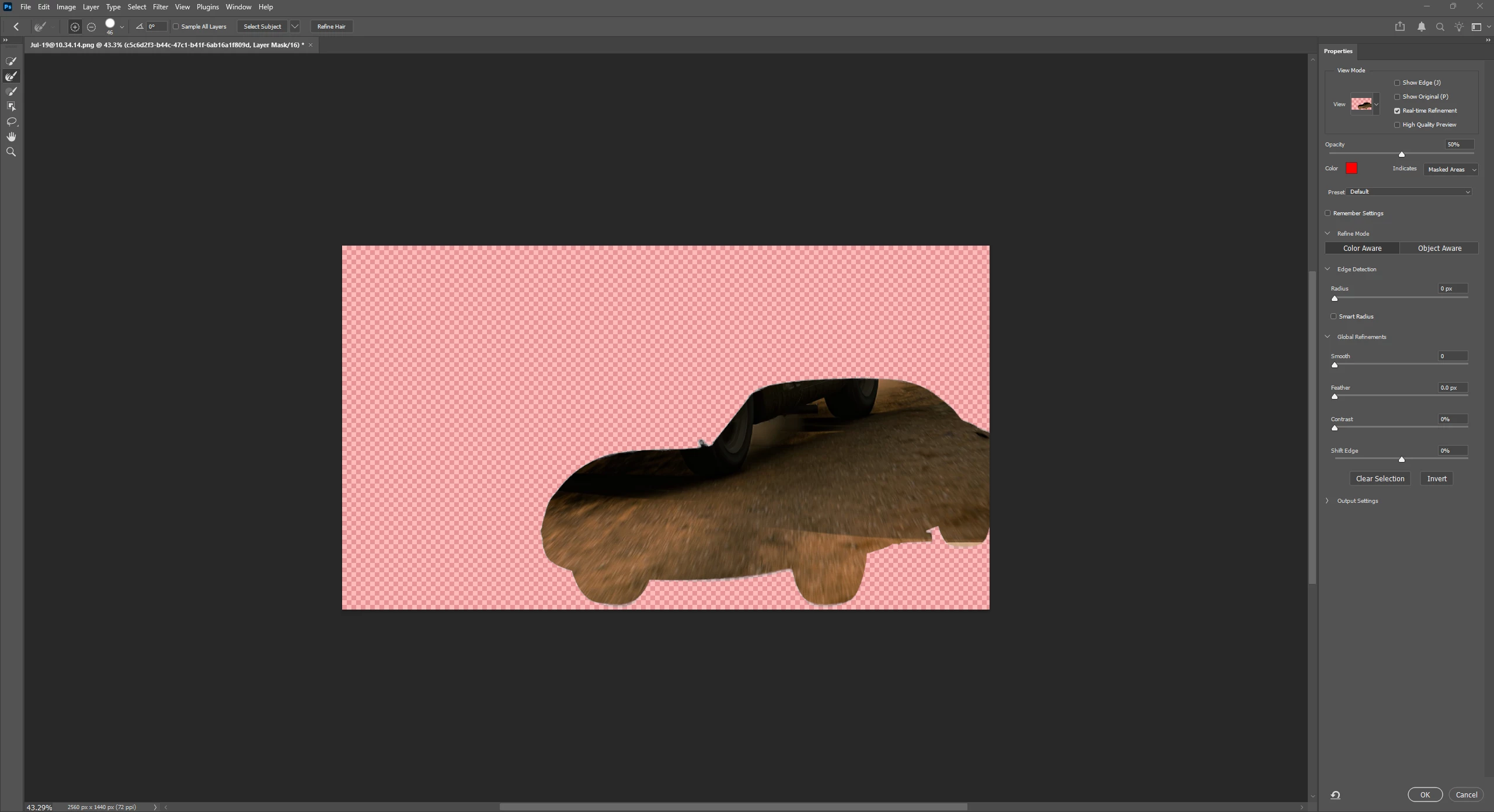

Select Subject within Mask Interface is not accurate with the masked image.
As mentioned in the original description, select subject does not work correctly from the masking interface, however if I use it outside of it and then create a mask it works. This has been an issue for me that has spanned multiple version, so I am unsure if its an issue on my end or not. I have reset my preferences with no success, and I believe I have previously reinstalled also with no success.
I am using Photoshop 27.3 on Windows 11 with an Nvidia RTX 3080ti.

    Hi ​@TylerMoore,
    Sorry for the delayed response. Thank you for sharing the full System Info.
    Based on what you provided:
    • Photoshop 27.3.0
    • Windows 11
    • NVIDIA RTX 3080 Ti
    • GPU acceleration enabled
    • Dual GPU listed (NVIDIA + AMD integrated)
    First step, please update to Photoshop 27.4. Second, since you have both an RTX 3080 Ti and AMD integrated graphics listed, please try this:
    • Go to Windows Settings > System > Display > Graphics
    • Add Photoshop if not listed
    • Set it to High Performance (NVIDIA GPU only)
    • Restart Photoshop
    Also, disable the integrated GPU: https://helpx.adobe.com/camera-raw/kb/acr-gpu-faq.html#gpu-use
    Then test Select Subject inside the Mask interface again.
    • Edit > Preferences > Image Processing
    • Set Select Subject to Cloud
    • Restart Photoshop and test
    If the issue still persists in 27.4 after forcing the NVIDIA GPU, please share a short screen recording showing the steps leading up to the actual issue.
    Looking forward to your update.
    Anshul Saini

    Hey, ​@TylerMoore. Welcome to the Photoshop Community. Please share the system info from Photoshop Help > System info > Copy & paste into a text document > upload & attach here. Does this happen with any image?
    Try changing the Select Subject mode from Edit > Preferences > Image Processing > Select Subject to Cloud & Selection process to Stable.
    If this does not help, go to the location of the preference folder below and rename it to backup.
    • Windows 10/11: Users/[user name]/AppData/Roaming/Adobe/Adobe Photoshop [version]/Adobe Photoshop [version] Settings
    • You can press Press the Windows key > Enter 'Run' > Enter %APPDATA%\Adobe
    • Rename the Adobe Photoshop folder by adding a .old at the end. (Adobe Photoshop 2026 > Rename > Adobe Photoshop 2026. old), You can restore these preferences later if needed.(https://adobe.ly/4860qM9)
    • Restart the computer.
    These changes will give Photoshop a fresh start as a new install. Let me know how it goes.
    Thanks!
    Sameer K
    (Type '@' and type my name to mention me when you reply)
    Feb 1, 2026 11:55 PM UTC
    ​@Sameer K This happens with all images. I tried to the changes to preferences that you mentioned, and had no success. I also renamed the backup folder and rebooted, and still had no success and the issue is still present.

    Hi ​@TylerMoore,
    • Photoshop 27.3.0
    • Windows 11
    • Restart Photoshop
    Anshul Saini
