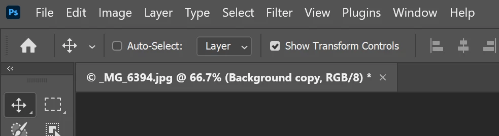

Noel Orridge
Sep 26, 2025 7:33 PM UTC
Hi @Михаил25536745biu1! Thank you for reaching out! The steps you're taking and the result you're getting is exactly how it's supposed to work if you have the "Auto Select" checkbox at the top enabled when using the move tool. Uncheck it, select Layer, and then try moving the black square Layer again.

MikaNaumovich
Sep 27, 2025 9:51 AM UTC
Hello Noel!  Thank you for the reply!
Did you have a chance to try the steps I provided before, with unchecked "Auto Select"?
The same result for me. It doesn't select and drag the black square layer, but it does with the background layer
Anshul_Saini
Oct 17, 2025 6:11 PM UTC
Hi @MikaNaumovich,
Thanks for following up and sharing the clarification. I did take another look on my end, and I see the same behavior you’re describing. At this point, we need to confirm whether this is working as expected (since a similar outcome also appears in older versions, such as Photoshop 2021) or if it’s tied to a long-standing bug with clipping masks and selection.
I’ve shared your exact steps and recording with the product team so they can validate. Once I hear back, I’ll update this thread with the outcome.
