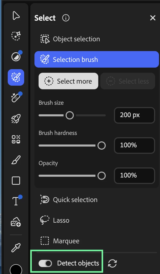

Regarding the earlier question about Object Selection enabled, I guess Sameer was referring to the Detect objects toggle in the Select panel (shown below).
