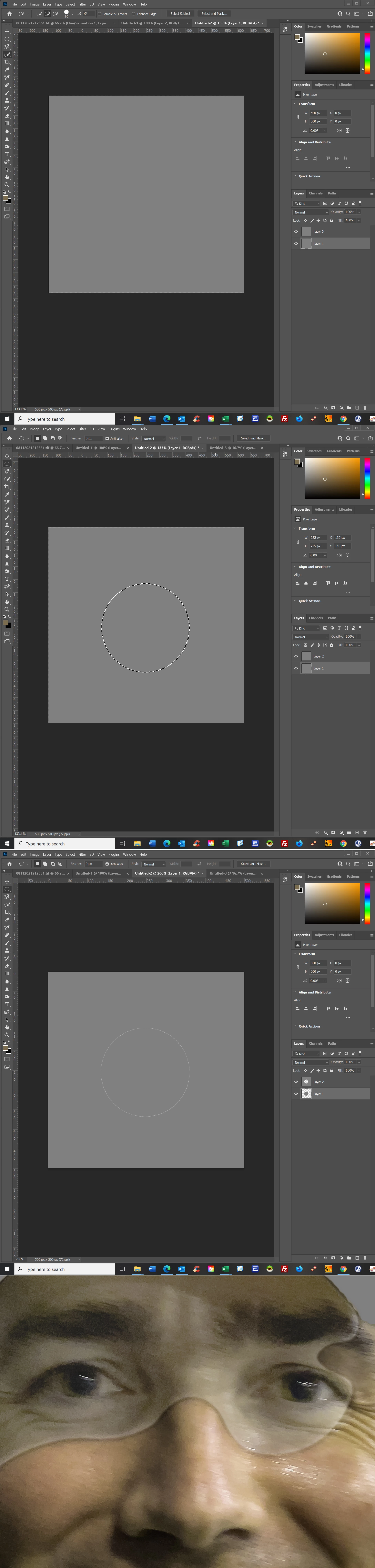

Attached is a simplified illustration of a problem I've had with Photoshop since the last millenium.  Lines appear around selections from out of nowhere. The illustration shows to identical gray layers. Below it I placed a circular marquee on top of the layers. On one layer I deleted the contents of the marquee circle and on the other I deleted the inverse. I did not touch the circle. In the lower panel, on the right you can see the edited layers as I described them. You can also see a circle on top of the two layers in the main panel. The circle is formed from destroyed pixels. I didn't assign a width to the stroke of the circle, so the two shapes should fit perfectly together with no gap. I placed a black layer underneath, and you can see the black through the gap.
This might seem like a "so what?" problem, but it's not. Cutouts always end up with unwanted lines around them. Here's a real world example. I've been trying to remove a shadow from a face caused by a baseball cap.  I've tried a bunch of different techniques to lighten the shaded portion, but Photoshop keeps highlighting the edge.

Correct answer davescm
You're screenshots do not appear to match your description of the problem. No grey layers - no circles.
It sounds like anti aliasing on the selection  edge but it would be good to see the screenshots to confirm.
Dave

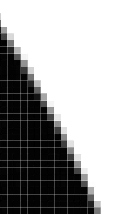

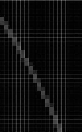

davescm
August 14, 2021
Hi
The "issue" is simple and is caused by anti-aliasing.
If you zoom right in and look at a selection you will see the edges between selected and not selected are filled with grey values. Without these the selection would be hard edged and would step. Making a selection of an angled edge look awful.
You can see what that looks like by turning off anti-aliasing in the options bar and making a circular selection.
So an anti aliased edged when zoomed in looks like this.
Deleting the content of the selection fully deletes the full values but only makes the in between areas semi transparent. Inverting the selection fully inverts the blacks to whites and vice versa- but those in between values are inverted to other "in between" values (e.g. dark grey to light grey). Deleting again leaves those in between values semi-transparent.
Put both together :
So that is the cause. To get around it, after inverting the mask, simply expand it slightly
Dave

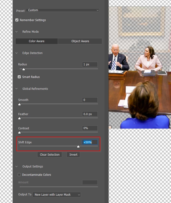

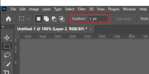

How do you make your selections?
If you use Select & Mask and have Remember Settings checked, then do you have Shift Edge set to a positive value (as opposed to zero?
Do you have a feather set for selections in the Options bar?
If you could detail your selection workflow, then we might be able to spot where it is going wrong.  The above suggestions would be fixed by a preference reset, and it seems likely that you have tried that?

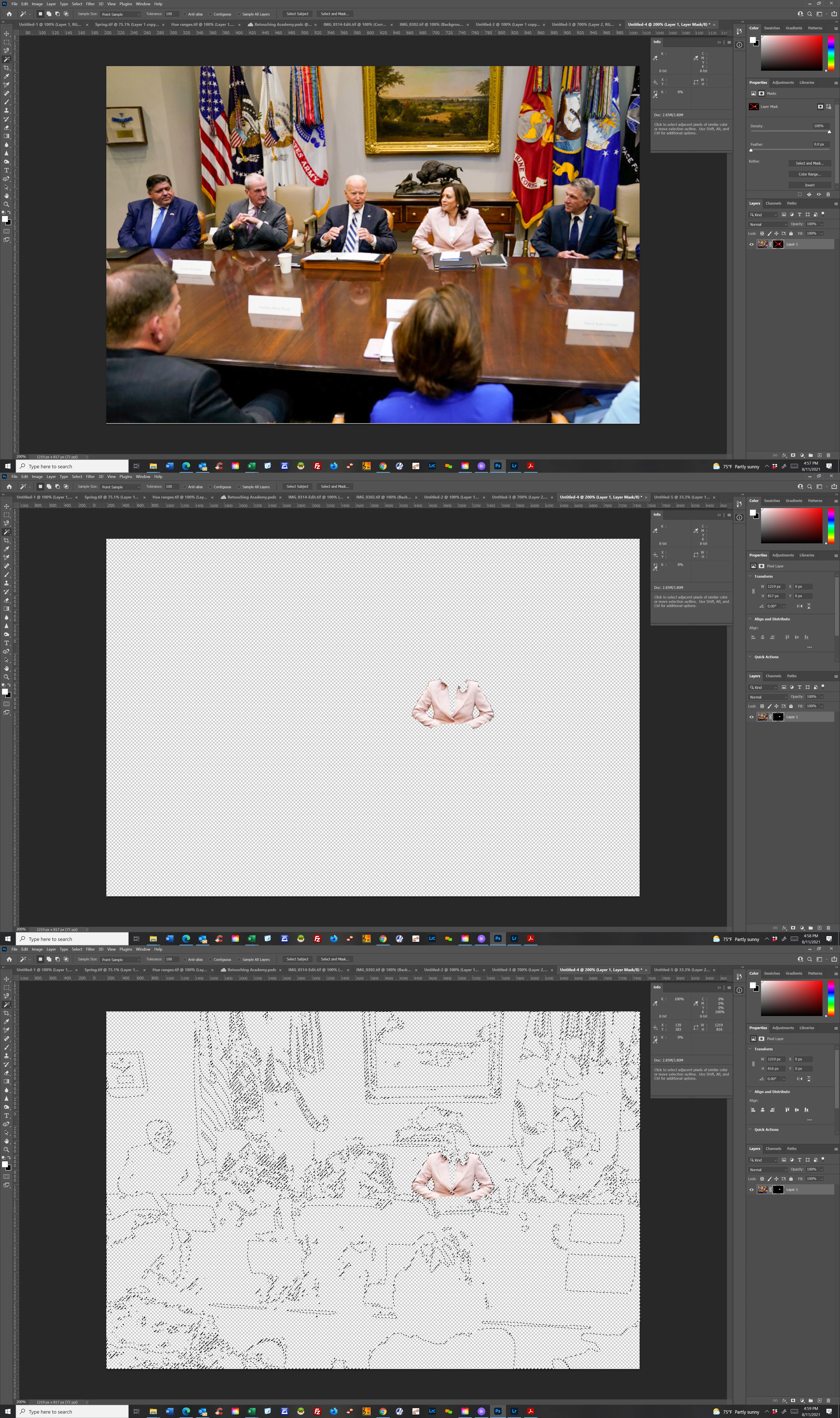

scotwllm
scotwllmAuthor
August 14, 2021
Woops... I posted the graphics for what I was going to send in the day before. I didn't send it in because I figured out what the problem was. I quick selected the jacket and turned it into a layer mask and forgot about it. When I went back later, I saw just the jacket on a transparent field. I clicked on the transparent part of the pic with the magic wand tool expecting all the transparent pixels except the jacket to be selected. Photoshop had other ideas though, and presented the outlines of every object that I purposefully did not include on that layer. It seems like Photoshop files have ghosts of information that I deleted, and they will rear their long-forgotten, unwelcome heads when I least expect them to.
