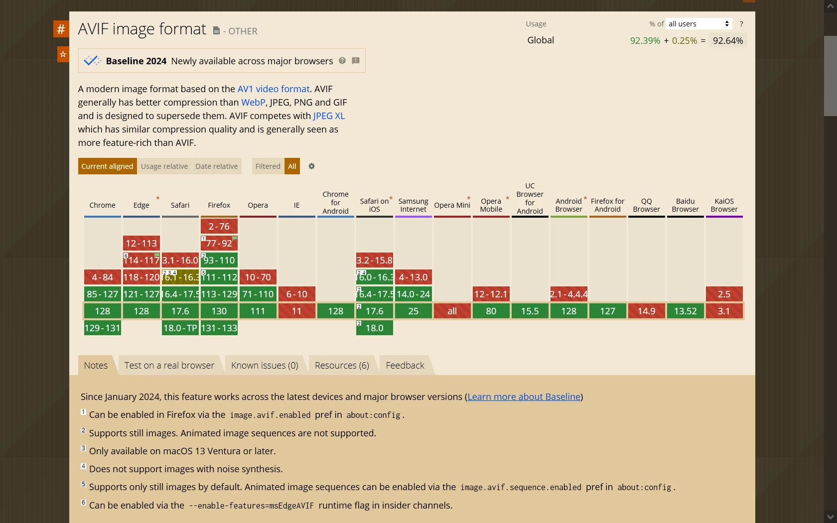

Rubbish click bait.  File type has no direct impact on Search Engine Optimization. SEO is baked into your keyword rich text content and proper use of good semantic markup: <h1>, <h2>, <h3>, <p> <li>... tags.
The advantage of using lossless compression file types like WebP and AVIF are better performance without excessive bandwidth.  Users on limited data plans will appreciate the conservation of resources.  But the decision to use compressed files or not should be based on your needs and those of your target audience.
According to Can I Use browser statistics:  WebP has 95% support from all modern browsers whereas AVIF has slightly less at 92%.
See screenshots.
In the interest of fairness,  it should be noted that JPG XL and JPG 2000 have almost no browser support at this time. As such, they should not be used in production sites.
