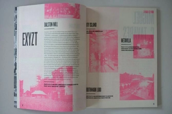

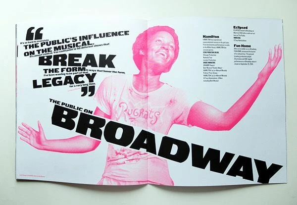

Show Only Magenta Plate
Hard to describe without showing an example. 😎
I’ve used many methods in PS over the years to colorize an image, but I see this look in print design a lot lately. It looks like only the magenta (or cyan, or yellow) plate only got printed.
How do you do this?

    That’s not magenta, it’s a custom pink spot colour.
    How you get it depends on how you’re working and the final print production and process.
    One method is to start from a monotone conversion in RGB and colorise using different non-destructive methods.
    Another method geared towards prepress would be working from a greyscale mode image, then using Duotone mode/monotone and specifying the pink values and name.

    Thomas Hanser
    Jun 20, 2026 2:55 AM UTC
    Thanks, Stephen.
    I’m going to experiment with this in PS and see what I can get.
    This look or trend is all over Pinterest lately. (Or maybe they’re older posts, not sure.)
    Thomas Hanser
    Jun 19, 2026 4:05 PM UTC
    Got it.
    In CMYK mode, load the magenta channel ONLY, and invert your selection.
    Create a new layer, and fill with magenta (100%).
    Put a white solid layer UNDER the magenta layer, and turn off the original (full color) layer you started with.
