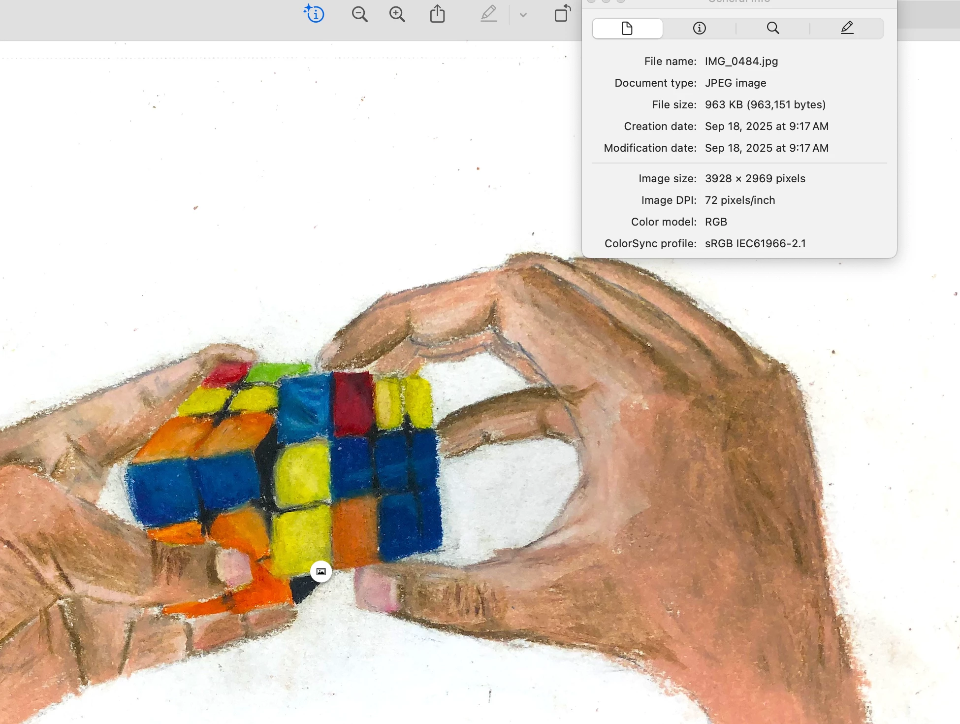

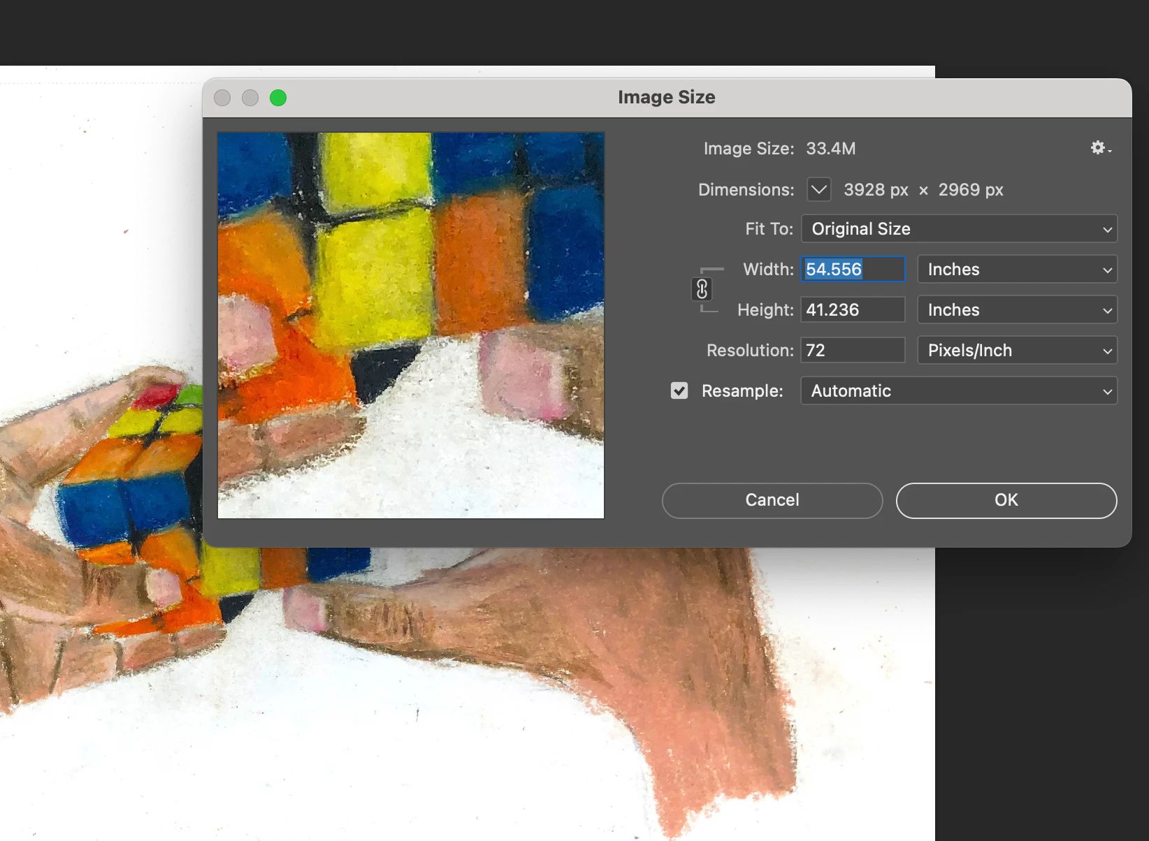

Hi, I teach a class where my students have to submit to a site no more than 4MB per image. I told them that the best software to edit and check accurate size is Photoshop and showed then where to look for size, crop... HOWEVER, one student decided to use Google slides and it load the image well on the site, but Photoshop says the image is 33MB ?? and when I right click the image on my iMac it says 963 KB.....How can this be???
I'm attaching both screen shoots of the same image opened on regular "i" from iMac and the Photoshop....completely different lecture...  The questions is WHY THEY DON"T MATCH? and WHICH IMAGE SIZE IS RIGHT?

Both sizes are “right” for what they are.
  • The file size in the Image Size dialog box is as uncompressed data while editing in Photoshop.
  • The file size in the JPEG is after any reductions in width/height in pixels, and depends on the quality setting you chose when exporting the JPEG copy. And, because JPEG can’t store layers, it’s the size after flattening all layers. And, if the file was originally more than 8 bits per channel, now it’s 8 bits per channel.
The same image, with the exact same number of pixels, can and will have very different file sizes depending on:
  • Whether it’s camera raw data, or converted to a format such as PSD, TIFF, JPEG…
  • Its bit depth per pixel (1, 8, 16, or 32 bits per channel), as shown on the Image > Mode menu in Photoshop. For example, the same image can be half the file size if you halve its bit depth per channel from 16bpc to 8bpc.
  • How many channels it has (for example, 1 for raw or grayscale, 3 for RGB or Lab, 4 for CMYK…)
  • If it’s compressed, and if so, whether that’s lossless compression (original quality, larger file size) or lossy (less quality, smaller file size). And if it’s lossy, which setting you chose on the scale from high quality/large file size to low quality/small file size.
  • And if the file includes other extras like masks, alpha channels, spot color channels, metadata, clipping paths, embedded Smart Objects, a composite preview layer, etc.
So there are lots of reasons why there are many possible file sizes for the same image.

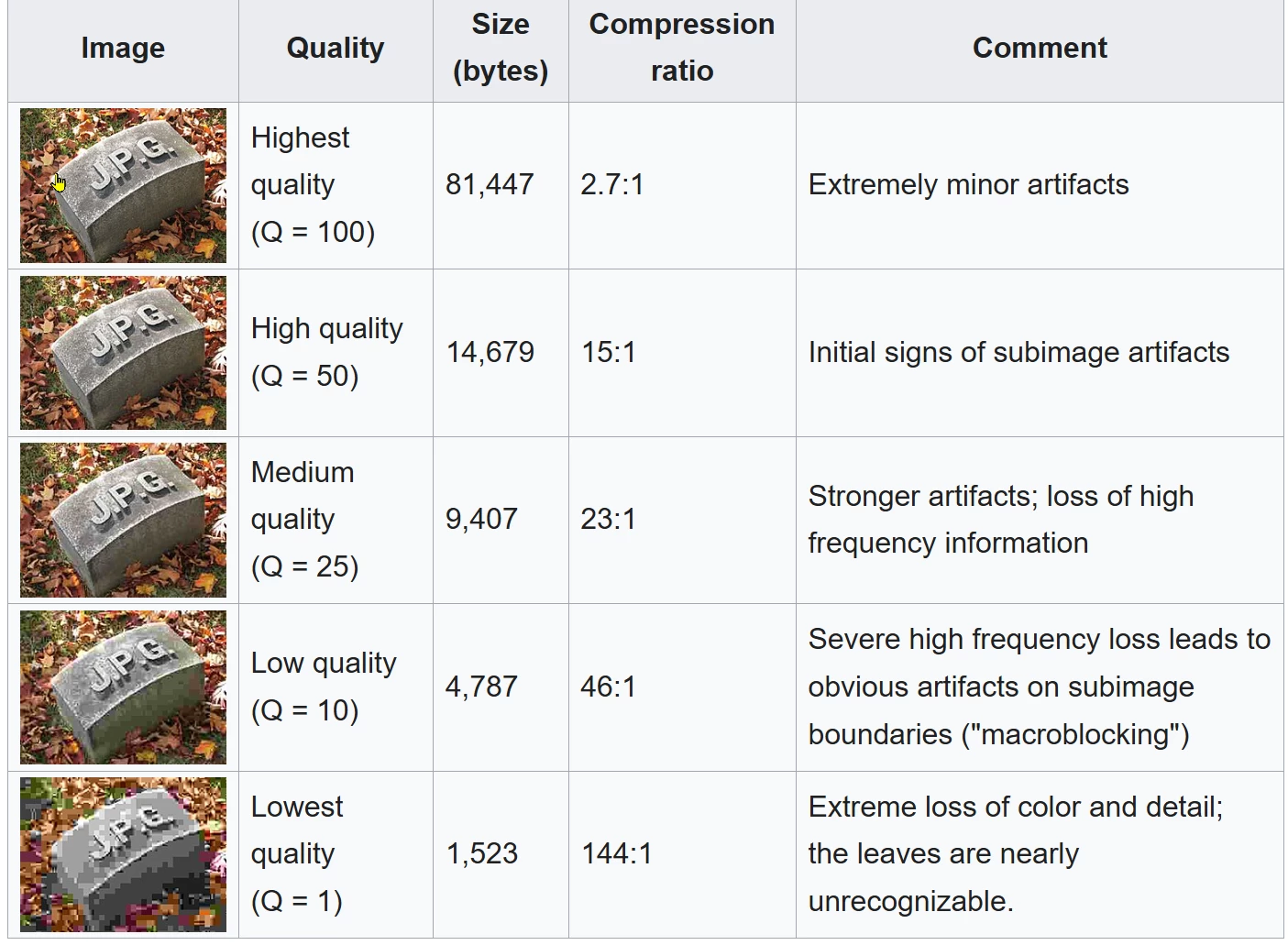

...but Photoshop says the image is 33MB ?? and when I right click the image on my iMac it says 963 KB.....How can this be???
@viviana_5555 - I'd advise you to familiarise yourself with the principles of lossy image compression so that your students can be taught this fundamental concept.

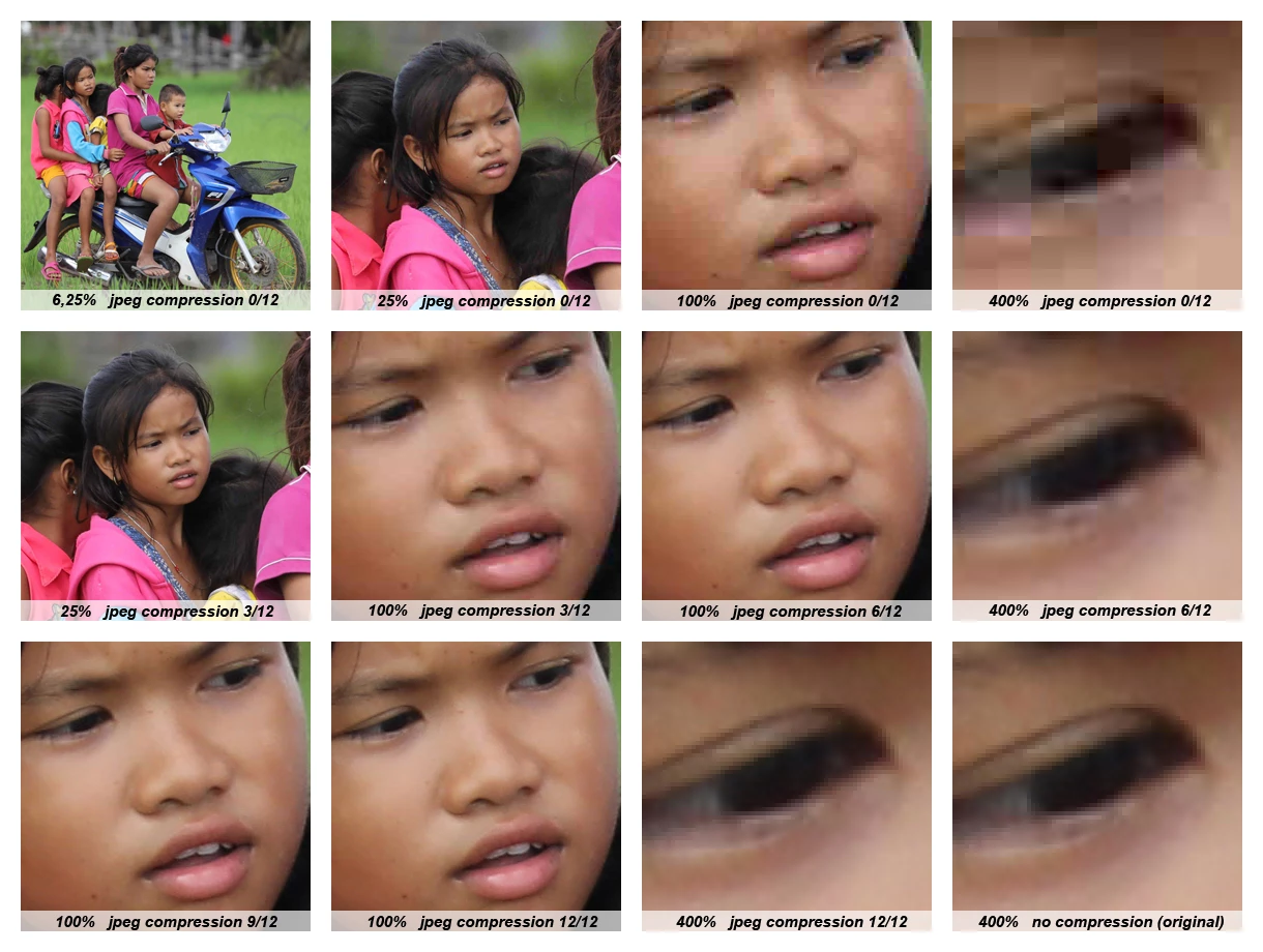

Trevor.Dennis
Sep 18, 2025 11:40 PM UTC
Wikipedia has an excellent page on JPEG
https://en.wikipedia.org/wiki/JPEG
This one is best viewed on the Wikipedia page so you can expand each sample.
