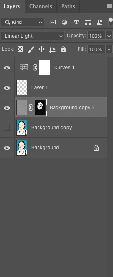

    One issue
    After I paint the mask, if I want to paint again, it removes paint mask. I didnt even use black but white and yet it still removes my masking.
    Using black doesnt even remove or reverse the masking. Only white does. How come?
    c.pfaffenbichler
    May 14, 2019
    What is the Brush Tool’s Blend Mode?
    Could you please post a screenshot with the pertinent Panels (Layers, Channels, Options Bar, …) visible?
    aiur4Author
    May 14, 2019
    I never changed the mode between black and white. And yet it removes the masking.

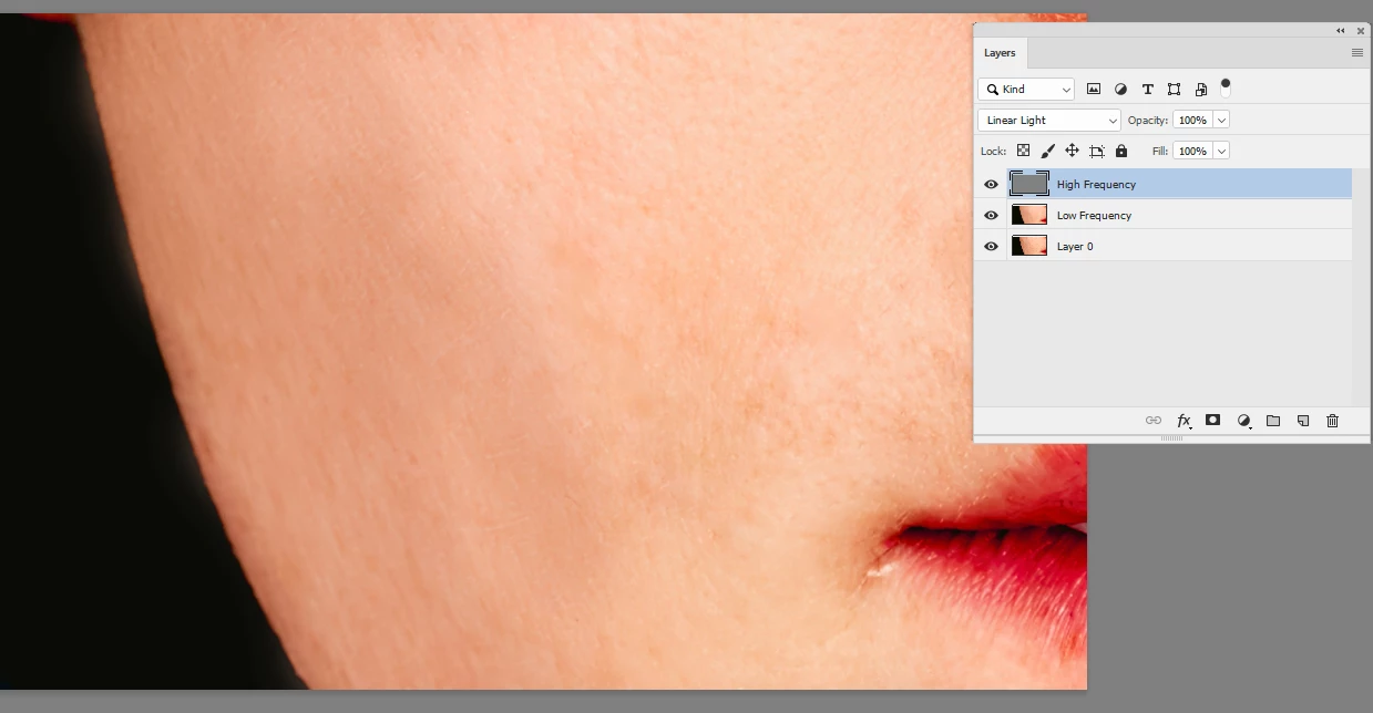

    Hi
    Another vote for high frequency retouching here.
    I think it is always worth learning the manual steps first bfore using actions.
    So:
    1.Make 2 new duplicate layers (Ctl+J)
    2. Name the lower layer - Low frequency
        Name the upper layer - High frequency
    3. Select the "Low Frequency Layer" and use Filter Gaussian Blur (approx 6.0)
    4. Select the "High Frequency layer"
        Go to Image - Apply Image
        Set Layer as Low Frequency
        Set blending to Subtract
        Set Scale 2
        Set Offset 128
        Click OK
    5. Change the Blending mode of the high frequency layer to Linear Light.
    Now you can clone out sharp blemishes on the High frequency layer and deal with darkening /lightening and softer areas on the low frequency layer
    Note the above applies to 8 bit images. For 16 bit images step 4 changes slightly to :
        Tick Invert
        Set blending to Add
        Set Scale 2
        Set Offset 0
        Click OK

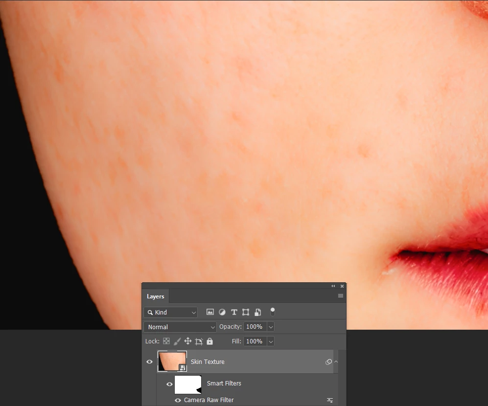

    Trevor.Dennis
    May 13, 2019
    Camera RAW  > negative Clarity is an easy way to improve skin texture.   I'm  told  that a lot of wedding photographers use this trick nowadays.  Making the layer a Smart Object is a good way to go.  Negative Clarity is 'reasonably' good at ignoring the bits you don't want to  loose detail from, but it is best to paint out the effect in the SO mask.
    [EDIT]  I should have said...  I  used a value of -90 for  the above example.

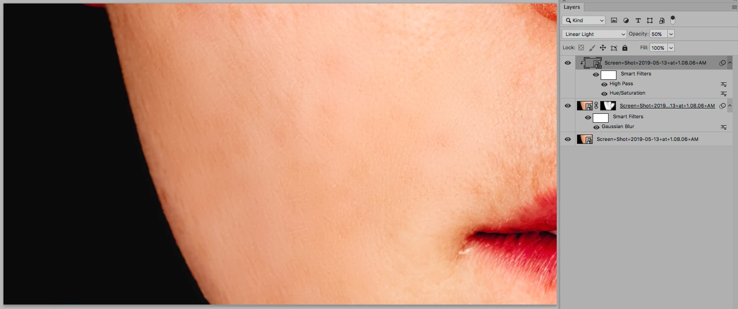

    c.pfaffenbichler
    May 13, 2019
    One option would be frequency separation, a Smart Object, desaturated and with High Pass applied, set to Blend Mode »Linear Light« on a blurred version or even a Layer with Brush-painting.
