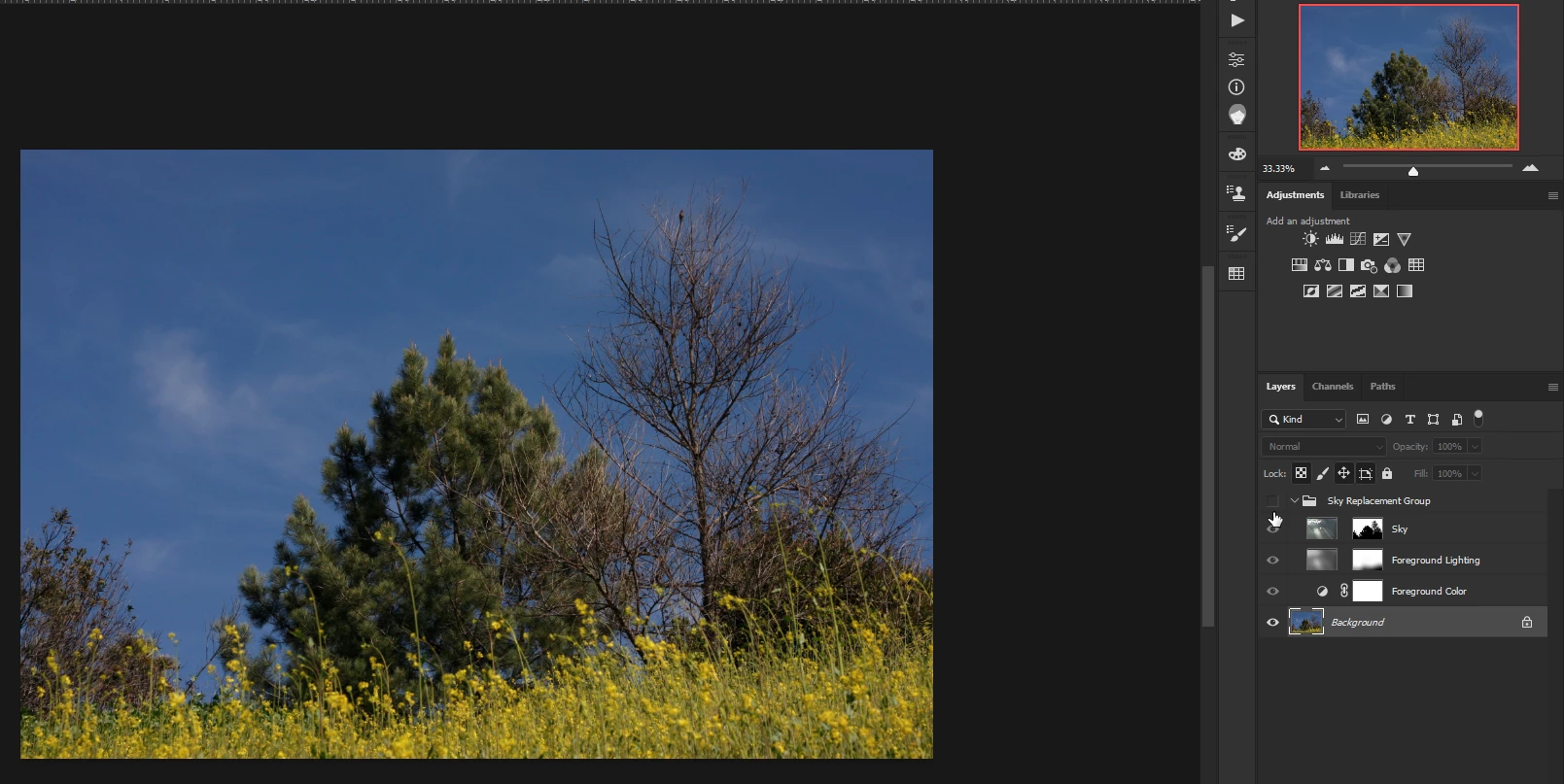

@defaultyz8ydhncgwu2 I just put the sky replacement feature through a rigorous test on version 22.5 and it worked great; quite fast, too, and I'm using an older system. However, I'm on Windows 10. We'll need to know more about your exact PS version and OS to see what's going on. Did it just stop working on only one image or does this happen with any image you try? Are you outputting the new sky to a separate layer? And even though that layer is visible and on top of the original layer, there is no change in the sky?

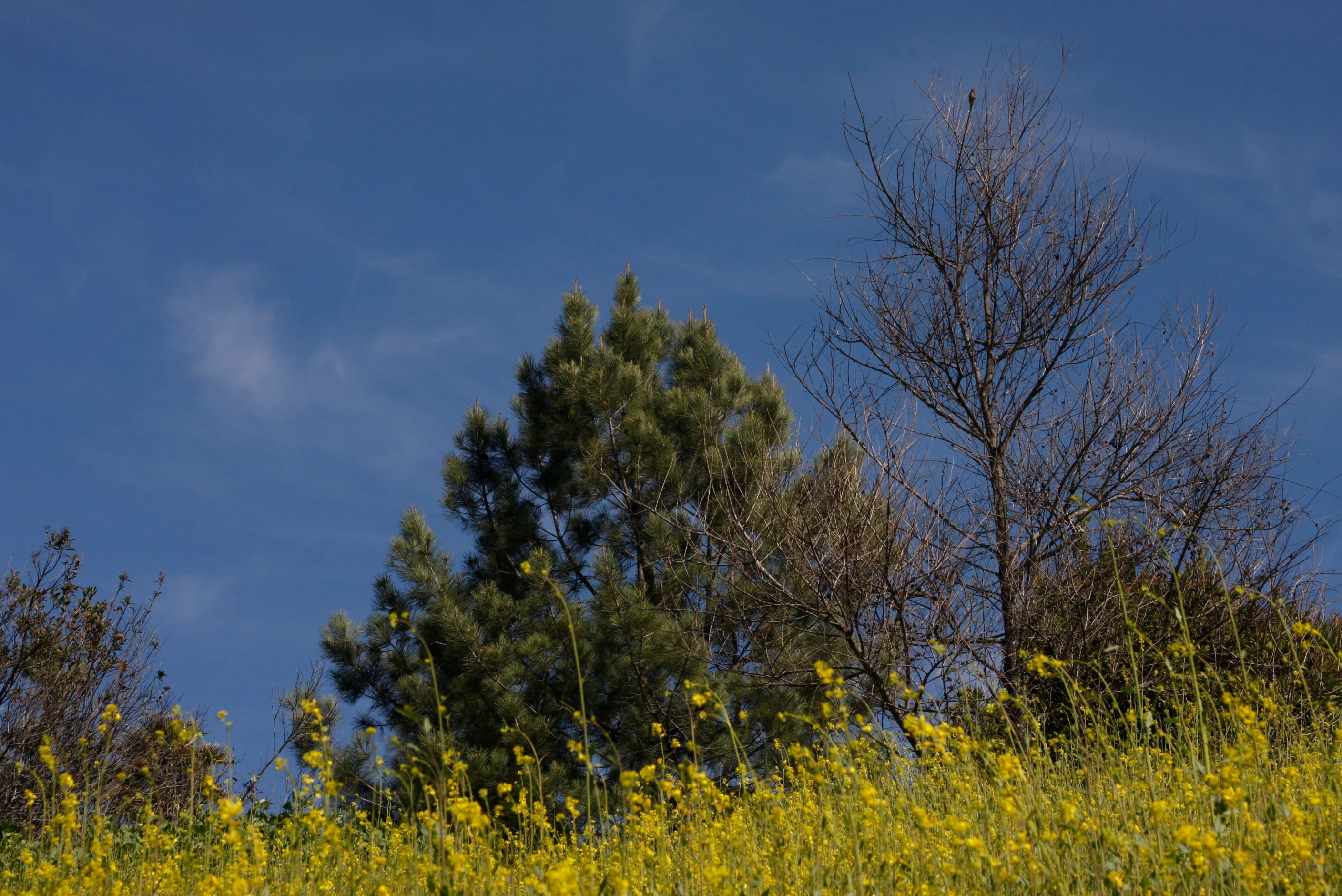

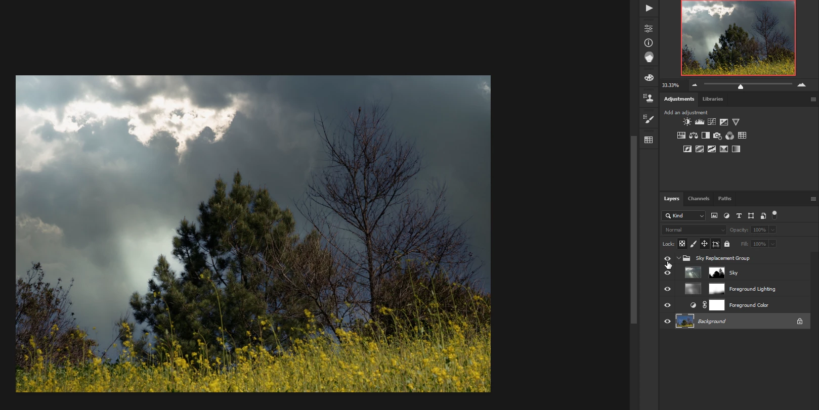

Okay, thanks for that. Just to clarify, no matter what photo you start with, the sky replacement won't "stick" to the photo. Can you try it with my photo that I'm attaching here? I'd like to rule out your original file so we are certain it's the replacement tool function that isn't working properly. Also, it would be great if you could share some screenshots of your image and layers panel with before and after results like this:
