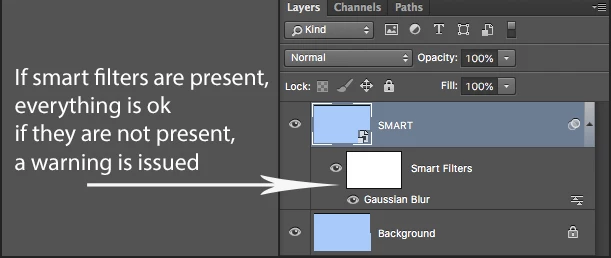

I would like to find a way to see if I am
present in an advanced smart filter object
If smart filters are present, everything is ok
if they are not present, a warning is issued.

alert('SMART FILTER: ' + (executeActionGet(ref).getObjectValue(sTT('smartObject')).hasKey(sTT('filterFX')) ? 'ON' : 'OFF'))

My problem is this:
I have many psd files with advanced object layers
some of these have no smart filter inside
So if advanced object has internal smart filter '
Go on
if it has no smart filter it deletes the advanced object level.

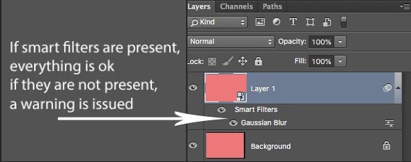

Kukurykus thank you for your efforts but not what I'm looking for
I don't care about the mask if it is present or not present
I'm interested in knowing if smart filters are present
therefore
if there are smart filters, leave everything ok
if no smart filter is present, a warning is issued
alert ("smart filter not present");
I thank you again for everything.
