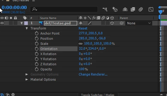

Hi Anthony
I've just tried this in CC2017 (and CS6 in case there was a bug). In both cases the transform key-framing seems limited to Scaling and moving but does not take on Distort.
You may be better doing this in After Effects - where you can manipulate a plane in 3D space or, at a push, creating a 3D "postcard" rectangle  in Photoshop and rotating that in 3D space to match the phone layers.
Dave

In Photoshop 3D - you would add the smart object as a texture - that way your smart object contents can be the screen simulation straight on view and will remain fully open to modification. If the smart object contains moving content, your preview will only show the first frame - but the rendered video will include the moving content render as well as the 3D object.
In After Effects you would put your smart object in a PSD file in Photoshop. You then import that PSD into your After Effects project and use the layer, along with your other simulation video layers (which you can import separately). You can rotate the layer using the transform key-frame controls below.
If you modify the PSD file in Photoshop altering the smart object content - the After Effects project is updated as soon as you save it.
This will work with moving smart object  content better as the preview also plays back the moving content.
