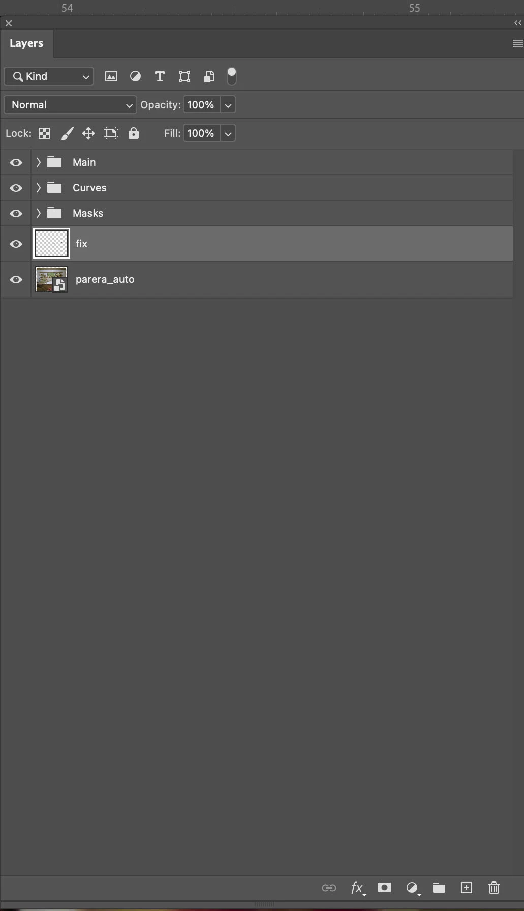

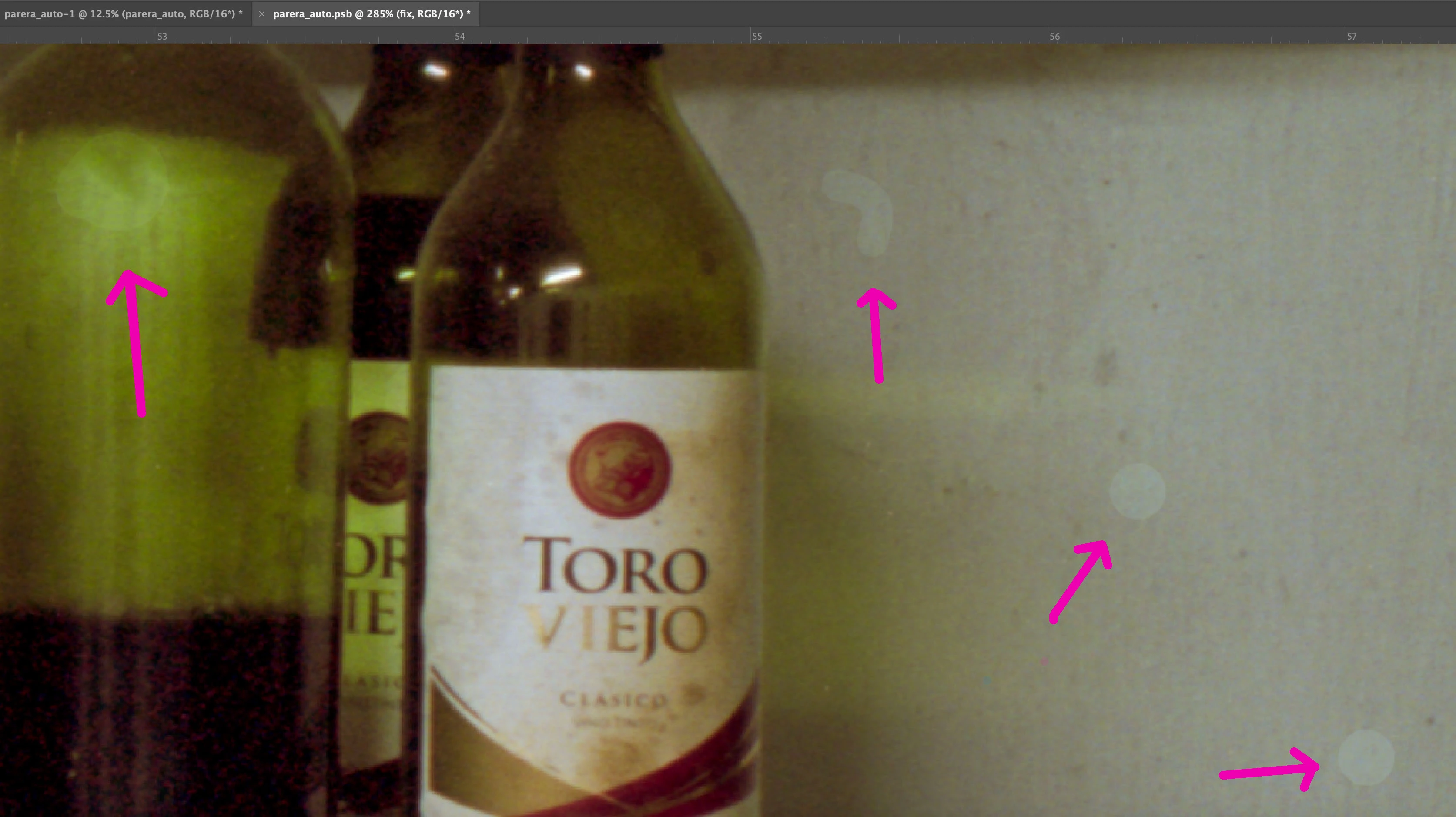

Hello! I am working with Photoshop on aprox 2GB files from 4x5 negative scans. My first step is to open the file with Smart Object and do the first adjustments there. I then do the fine tuning in Photoshop using layers, curves, masks etc. My problem is when it comes to the Healing Brush and Clone tools to clean the dust from the scan. I first create a layer over the 'Background". Then I click on it and go to Spot Healing (J).  The problem is when I decide to go back to the Smart Object to do any further corrections, the 'holes' where the spot healing were done show up. How can I fix this without losing the benefit of going back to my Smart Object? Spot healing on the background is a huge risk that is why I create a layer. Thanks!!!

Why are you using Smart Objects? When you say going back to do further corrections, going back to what? Aren't your scans saved as TIFF? And spot healing directly on the background is fine, I always do this and rarely have to go back to fix anything. If I do, either the history brush or going back to a copy of the original to copy/paste a small area really doesn't hurt anything.
This is how Smart Objects are supposed to work BTW. If you add a separate layer with whatever content, it stays separate from the SO.
Your best workflow might be to make global corrections, fix dust spots, and then do whatever additional global adjustments you need.
Finally, why are your scans so large? 4x5" at 2400ppi (which might actually be above the film resolving power) at 16 bits/pixel is a 659MB PSD file. A TIFF should be about the same size. FWIW, I used to shoot 4x5 and IIRC 2400ppi was overkill for scanning.
