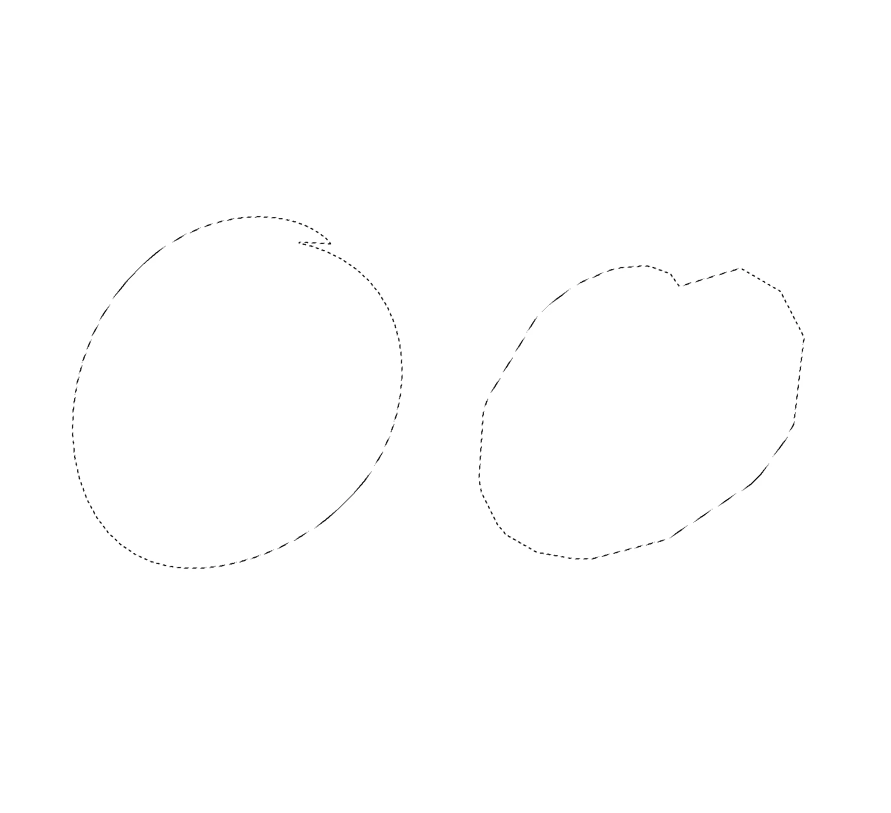

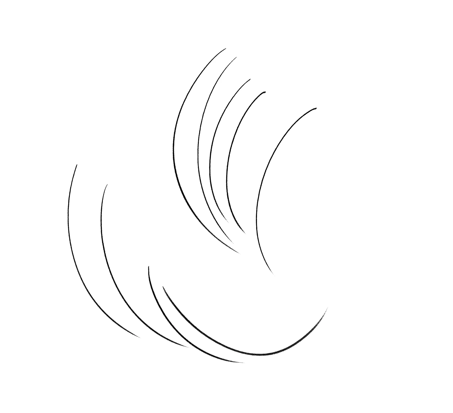

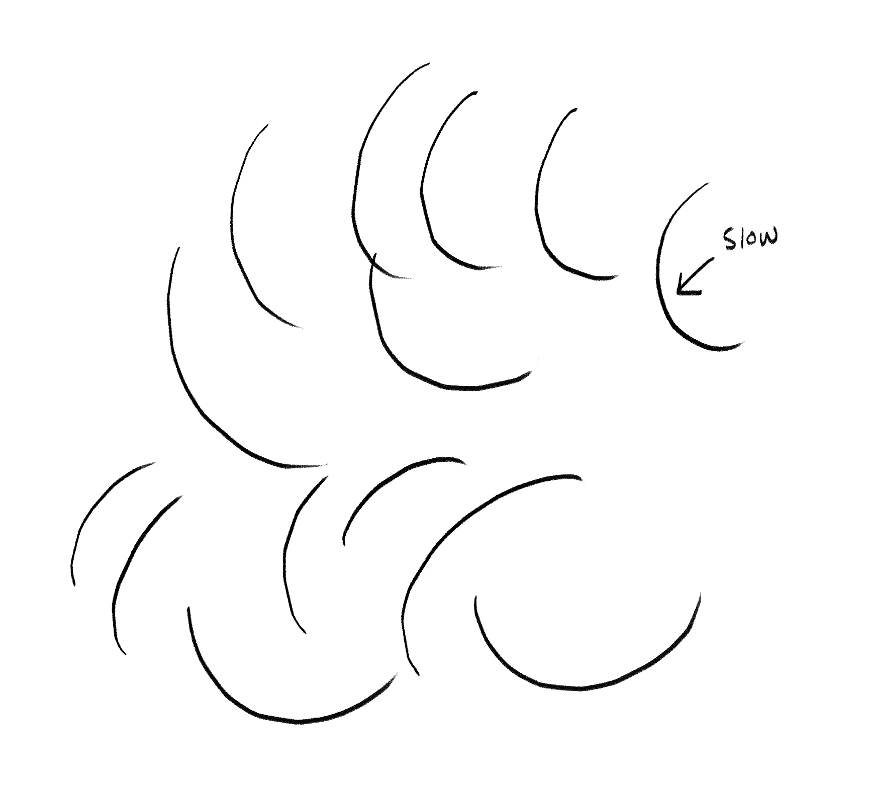

I'm having a rather disruptive issue when drawing curves strokes freehand.
After a few minutes of drawing, curved strokes suddenly get angular. The faster I draw the strokes, the worse it gets. If I draw real slow, it looks ok.
I'm attaching pictures of the problem.
The problem is not with the brush - I have tried different brushes, and it also happens with the selection tool (as you can see in the images). So far I have only had this problem in Photoshop, which leads me to believe the fault may be with the software, but I can't know for sure.

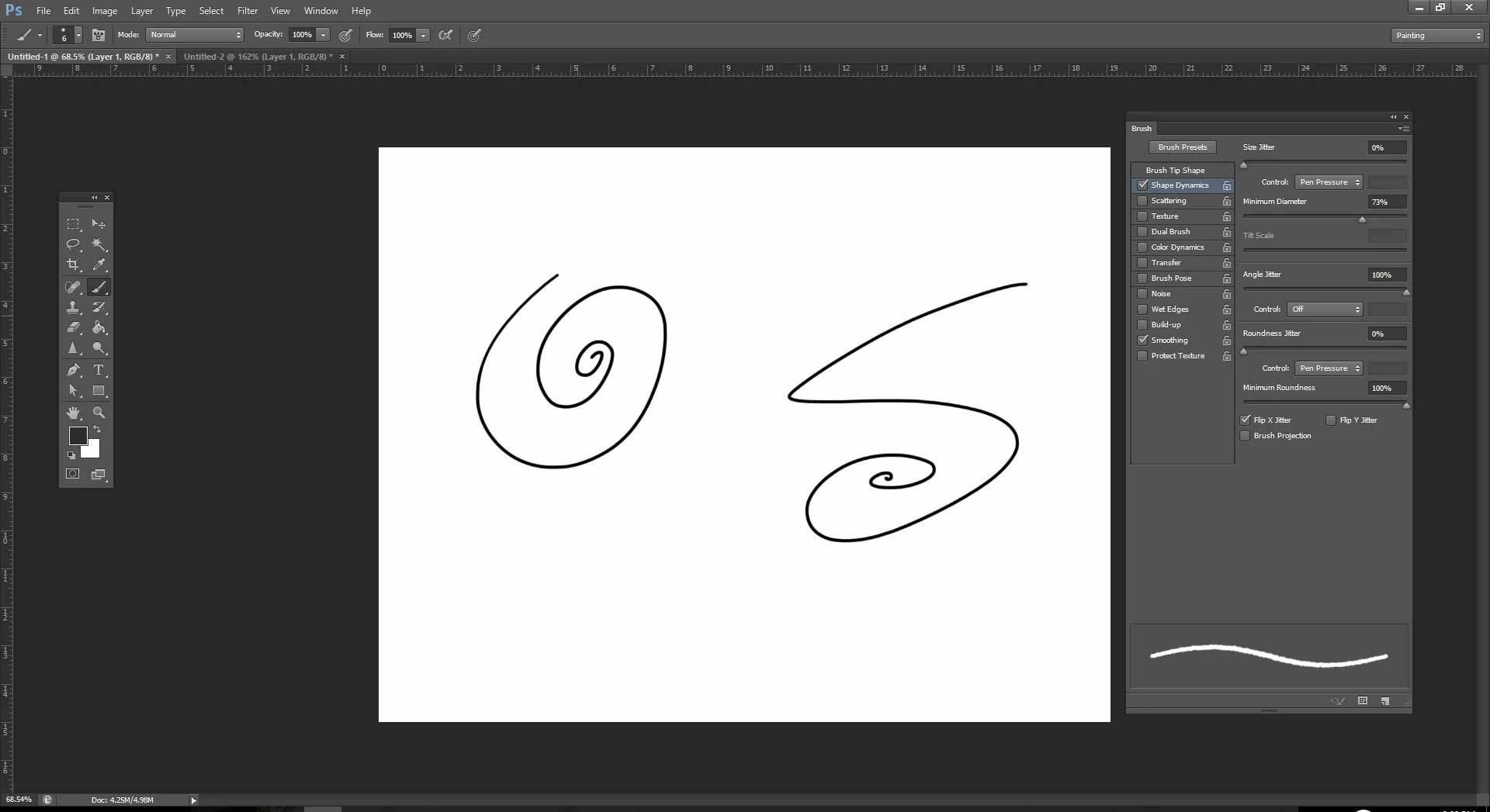

What does your Brush Panel look like? Is there anything selected there that might not be needed?
JanneMag
JanneMagAuthor
March 14, 2022
My brush panel looks the same as yours in this picture. Normally I work with a brush with various settings, but switching to a completely plain brush with nothing checked except Shape Dynamics and Smoothing still has the issue.
